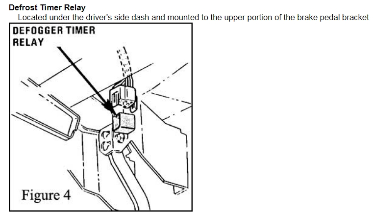

Where is this delay relay for this?
From Here...

The "relay" is a small box under the dash on right side of "frame" holding the steering column & brake pedal.
