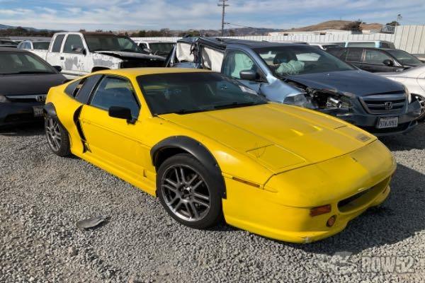

An 88 gt just hit our pick n pull.
I have an 88 engine that's complete not far from you that you can just have if you want. I had pulled it apart to sell as a good short block but ended up buying the car instead of selling him the engine. I ended throwing the engine back together for storage. It probably needs the heads serviced at a minimum and will need new head gaskets intake as I had the heads off. Basically all new top end gaskets.
If you are interested let me know.
