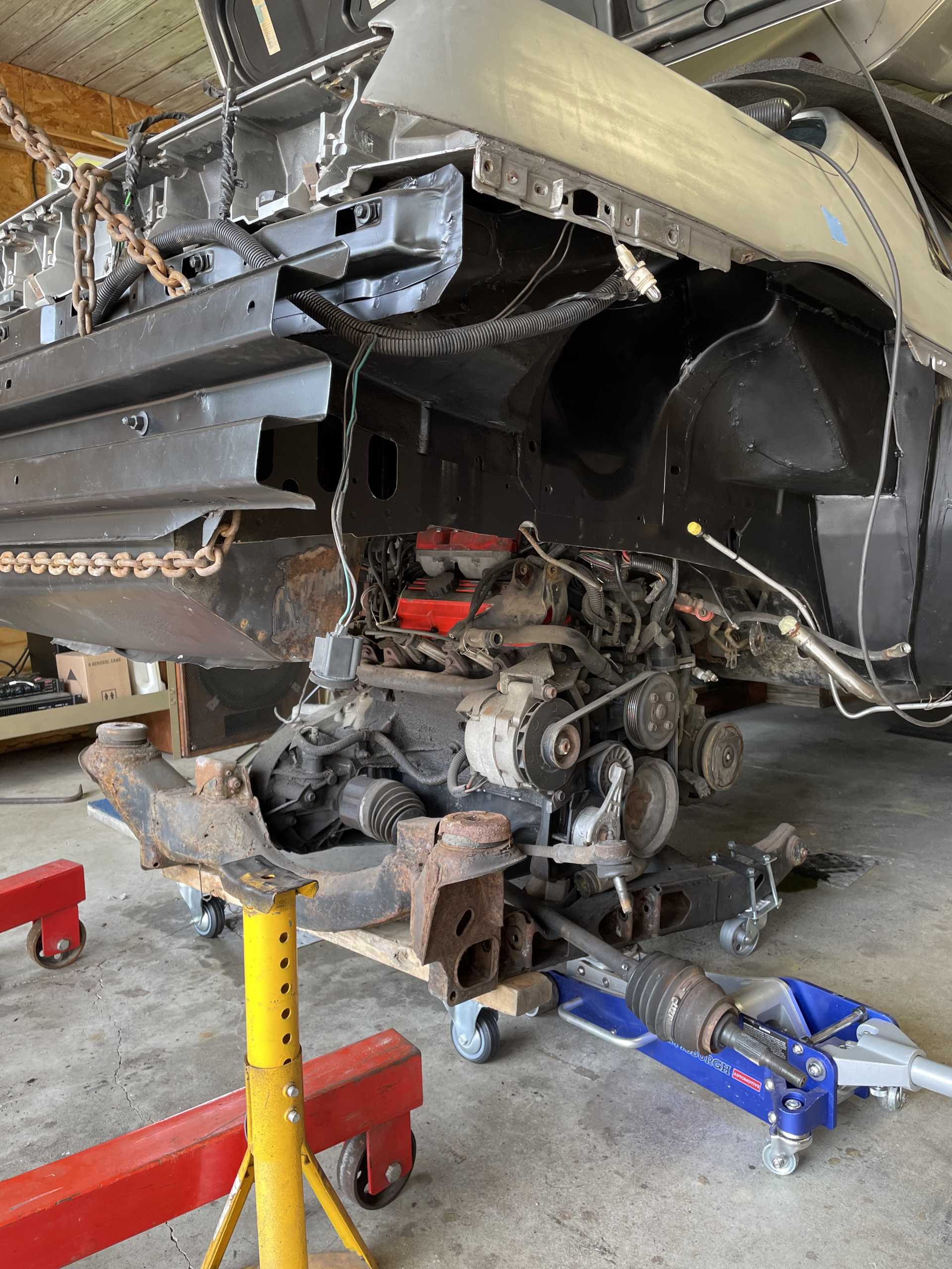

Report this Post09-24-2023 07:36 PM Click Here to See the Profile for 82-T/A [At Work]Send a Private Message to 82-T/A [At Work]Edit/Delete MessageReply w/QuoteDirect Link to This Post
I'll post some pictures later tomorrow or Tuesday. We got the subframe out from under the car... it was a chore. The engine hoist lifting the car worked like a charm. I also totally forgot to remove stuff from the car until I remembered that maybe Raydar had told me to check... and I was like, oh crap...
Everything went smoothly except for a SINGLE.... a SINGLE subframe bolt which was rusted to the sleeve and would not budge... no matter what I did. I hit it with an impact wrench for like 20 minutes, wouldn't budge. I cut one end off, stripped the other, and eventually it broke free and I could muscle it out with a pair of vice grips and a dead-blow hammer. I was so frustrated... I went through like 4 metal-cutting saws ... all just for one bolt.
But we were able to get the car lifted and pushed it out from underneath (we had the two wheels on wheel dollies from Harbor Freight), and then put the car carefully back down on two 6-Ton floor jacks.
So now the fun begins.
I broke some stuff though... so I'm going to have to get a new rocker panel

I pulled my front fascia off and rear fascia and lifted the rear of the car up high enough to roll the cradle out on a furniture dolly. Similar to the post above, works fine for me thus far.
Next time I'll be doing it on my new 2-post lift though, I wasn't comfortable with the method.

I did what gregr75 did.
If you take off the rear struts and wheel well, you can pull the cradle from the side. I didn't even have to raise it that high to do that. Installed the cradle with the new EV motor the same way. Just slide it from the side, jacked up the cradle a bit and lowered the Fiero and it went in place.

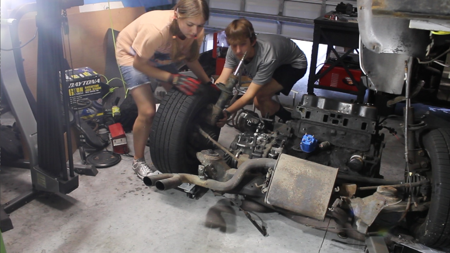

Report this Post09-25-2023 08:28 AM Click Here to See the Profile for 82-T/A [At Work]Send a Private Message to 82-T/A [At Work]Edit/Delete MessageReply w/QuoteDirect Link to This Post
I'm helping her put together a video for this part... but this is a screen grab that I took where she's rolling it out from under the car, and moving it off to the side. Her boyfriend came over to help in the last hour or so.
EDIT: Also... my garage is totally trashed now. It's usually spotless, so I had to drink heavily to fall asleep knowing my garage is in complete disarray... haha... I can normally get three cars into my garage, and now I have one and two-halves. :/

We got the subframe out from under the car... it was a chore. The engine hoist lifting the car worked like a charm. I also totally forgot to remove stuff from the car ... and I was like, oh crap...
Yeah. Once, I was lifting my car off of the cradle, and from behind the car it just didn't... look right.
Then I realized that the front of the cradle was being lifted into the air by the still connected parking brake cable. DOH!!
