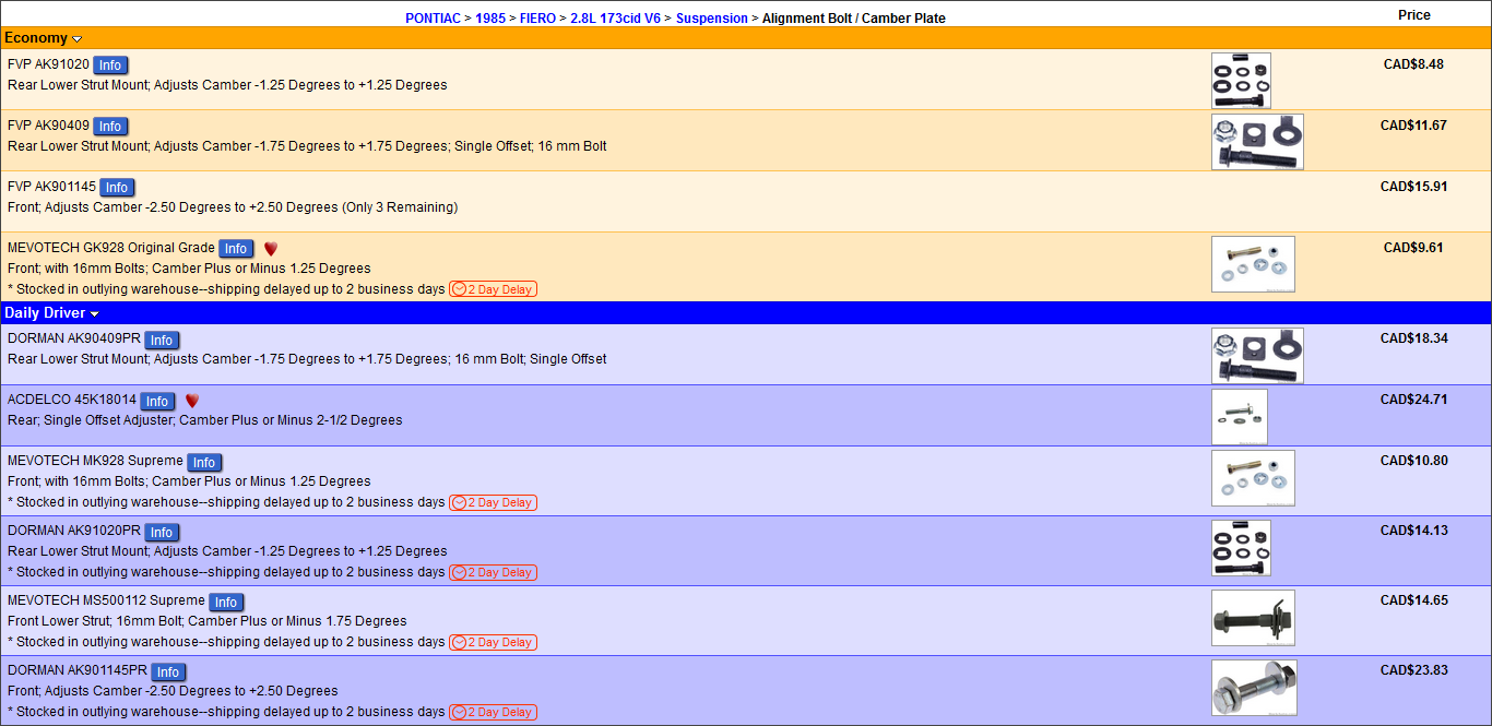

Rockauto has many camber bolts listed for the Fiero.
Which ones are correct and work?
Some listings are apparently wrong, as they are for the "Front" position.
While I selected model year 1985 to generate the following screenshot, the exact same part numbers are generated for 1988.

ACD 45K18014, Dorman AK901145PR and others same format will move the strut over entire slot.
The struts are made for this "washer cam" with stamped areas for the washer to force the strut to move in/out.
Other types may not work well or not @ all because of how there made.
If have "lower" car then any cam bolt and Plan bolts may not adjust camber enough to align the car.
Note: Some are sold single, others 2 bolts. Go to marker and double check this.

I ordered a set of ACDelco 45K18014 camber bolts. It looks like they will push against the tabs on my KYB struts.

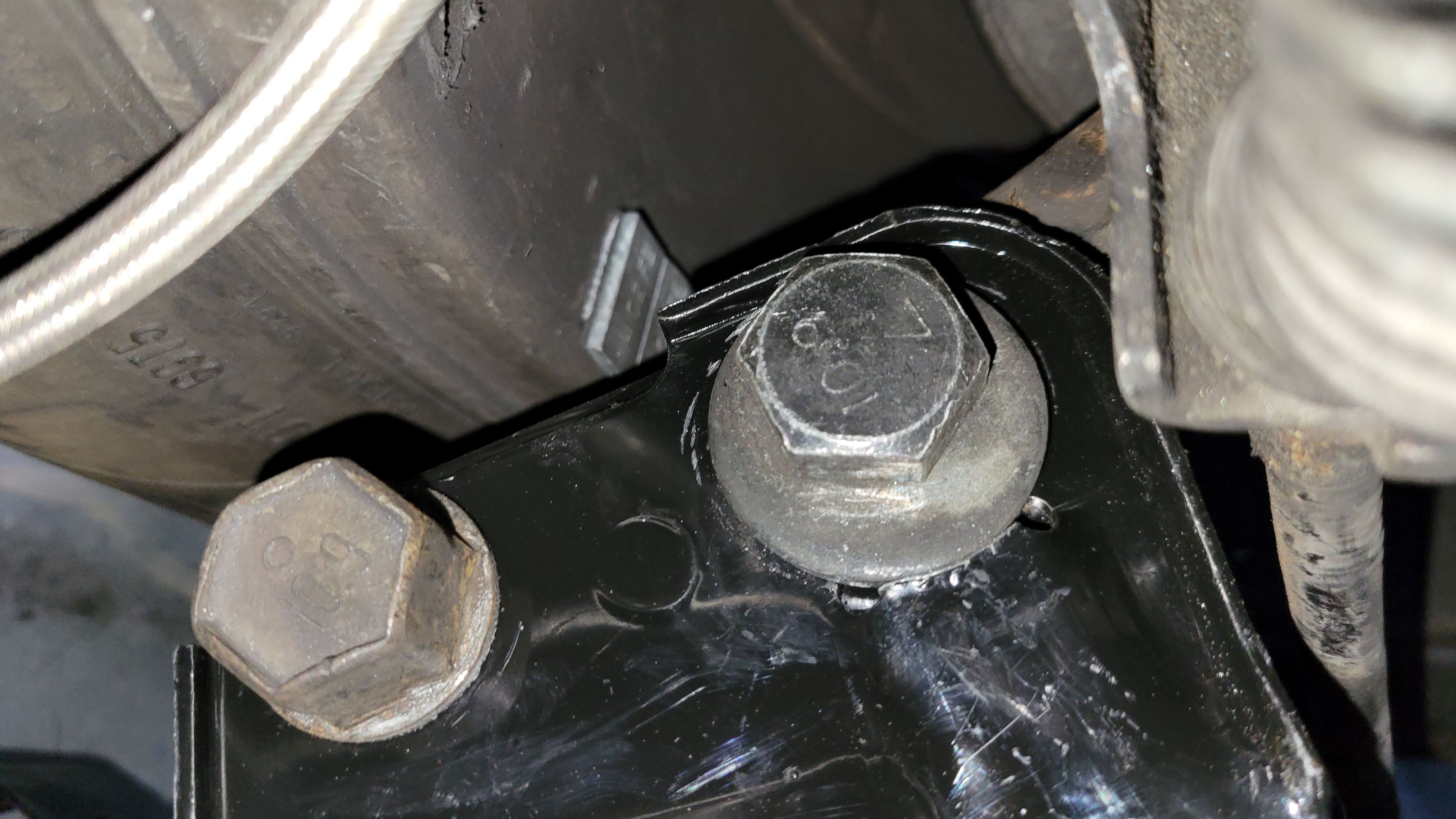

Amazing... I ran into the camber bolt issue yesterday.
Over the Memorial Day weekend, I replaced all the factory original bushings in the rear of my 88 GT with polyurethane. I also replaced the very dead struts. I installed Monroe OESpectrum struts, P/N 71814. A few years ago, I had installed AC Delco cam bolts, P/N 45K18014.
Yesterday I has the car aligned. The tech was barely able to force the camber on the right rear to a near spec -0.6° I didn't believe he couldn't adjust further than that until he showed me, especially since the old struts were Monroe Sensatracs, and the cam bolts were reused. I went home and took a picture:
If you look, you can see that the cam bolt was forced hard enough to distort the bump it rides on to increase negative camber. If the cam washer (that was fine before) was just a bit smaller, it probably would have the full range of adjustment. But as it is...
