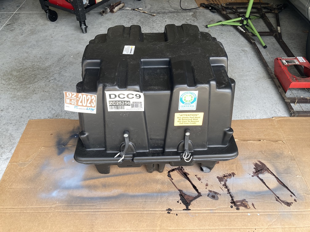

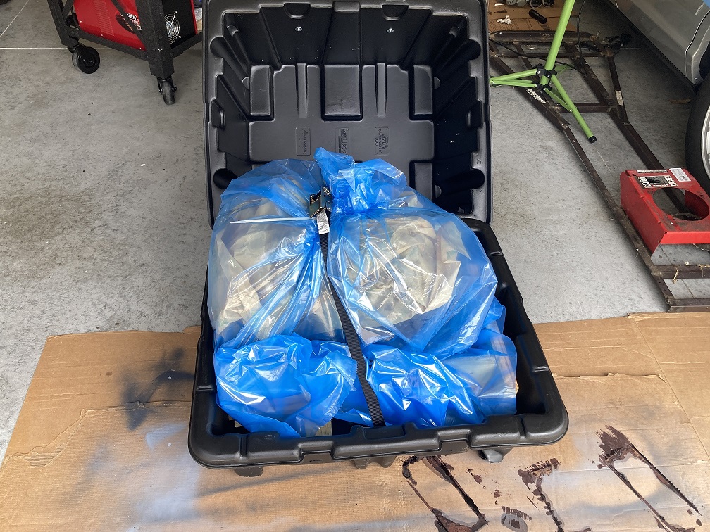

Woo hoo! It's here...
And I can't believe how light this engine is... the thing probably doesn't weigh more than 300+ pounds. I was able to easily slide it across my garage floor. I can easily lift 200 pounds, so if I was just a little bit stronger, I'd probably be able to lift it up and put it on the workbench. It's astronomically lighter than my Olds 455 big block... which feels exponentially more heavy.
