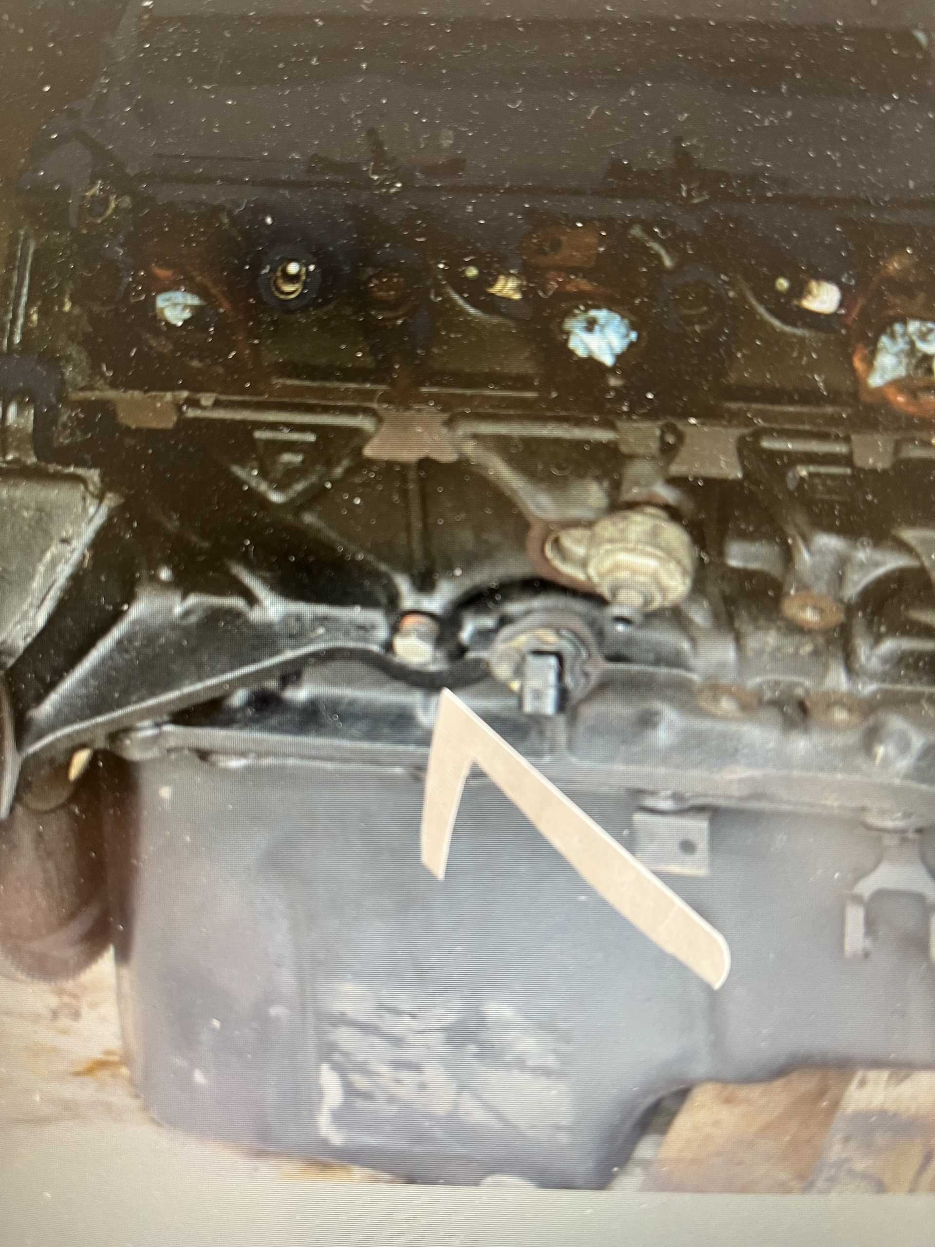

When flushing out the cooling system remove the two 1/4 " drain plugs out of the block so the sludge gets flushed out of the low areas around the cylinders. this will get rid of most of the remaining liquid. also drain the coolant pipes with the plugs in front of the rear wheels, coolant catch tank and bottom of rad. If you disconnect heater line at the engine fill you can blow out the heater core and lines. Now you have a clean liquid free system to refill with longlife 50/50. sleek
got photos of these plugs? When I first got my SE the garbage that came out of the cooling system was amazing.

Report this Post04-19-2023 11:36 AM Click Here to See the Profile for sleek fieroSend a Private Message to sleek fieroEdit/Delete MessageReply w/QuoteDirect Link to This Post
Hope you can see plug at end of arrow. One on each side of block. sleek
[This message has been edited by sleek fiero (edited 04-19-2023).]

Report this Post04-19-2023 12:50 PM Click Here to See the Profile for ArthurPealeSend a Private Message to ArthurPealeEdit/Delete MessageReply w/QuoteDirect Link to This Post
I see them! But, the photo is fuzzy - what kind of plug is that?

Report this Post04-19-2023 01:01 PM Click Here to See the Profile for sleek fieroSend a Private Message to sleek fieroEdit/Delete MessageReply w/QuoteDirect Link to This Post
it is a 1/4" pipe plug. I believe 9/16" wrench or socket. Use Teflon tape or sealant when reinstalling.
I used a generic picture of a 2.8 from s-10.

Report this Post04-19-2023 01:11 PM Click Here to See the Profile for Vintage-NutSend a Private Message to Vintage-NutEdit/Delete MessageReply w/QuoteDirect Link to This Post
The coolant drain plugs on the V6 engine block aren’t 'easy' to remove; one is under the starter. For me, I don’t remove the starter for a 'normal' preventive antifreeze/coolant flush.
Others have commented that removing the engine plugs are ineffective besides as considerable amounts of coolant can remain in the engine block. If you use ‘hard’ water in the system, yes, of course you will have more ‘junk’ to flush out….
When I drain the coolant system, I don’t get any ‘garbage’ in the container, only the coolant. Perhaps this is because I completely flush the engine ten times with distilled water before pouring-in full strength concentrate antifreeze. Yes, this takes some time to fill/run/cool/drain repeatedly until the drained liquid is nearly colorless.
For a standard change, I wouldn't either. Last two changes I popped out the fittings on the coolant tubes running along side of the car, and then put a hose in the fill tube and let it cycle for a while.
With the amount of garbage that came out the second time, it would not surprise me if there was a ton of additional garbage that a regular flush didn't touch.
Though, if I have to remove the starter to get to that plug, maybe I'll roll the dice and just not. And, the other is on the firewall side, I'm assuming?

Report this Post04-19-2023 01:49 PM Click Here to See the Profile for theogreClick Here to visit theogre's HomePageSend a Private Message to theogreEdit/Delete MessageReply w/QuoteDirect Link to This Post
Yes, Can remove engine plug(s), If can find or have access to it/them.
V6 maybe easier in Pic above but in the car may depend on trans and other things. Example: Auto trans and exhaust make hard to just see anything on rear side of V6. Front side have similar problems.
I think L4 has only one... Above the starter there is 1 plug but this is 1/4" square hole type on mine. Can reach from the top. Tries to hide under the "recall shield" sandwich between block and exhaust that covers most of front of head and block. Problem is do not let coolant or water to run on/in the starter and solenoid. Water is bad enough but Coolant is very conductive and could "short out" the big battery cable.
Doesn't have a drain on rear side.
Even if you find and remove the engine drain(s).
The Block, Rad and other things still have enough water to never use 50/50 mix to fill after flushing.
Many would loosen/remove a low hose to drain the rad before messing w/ easy to break drain plug on that. Even if used, Fiero "tipped" the rad so can't total drain it.
