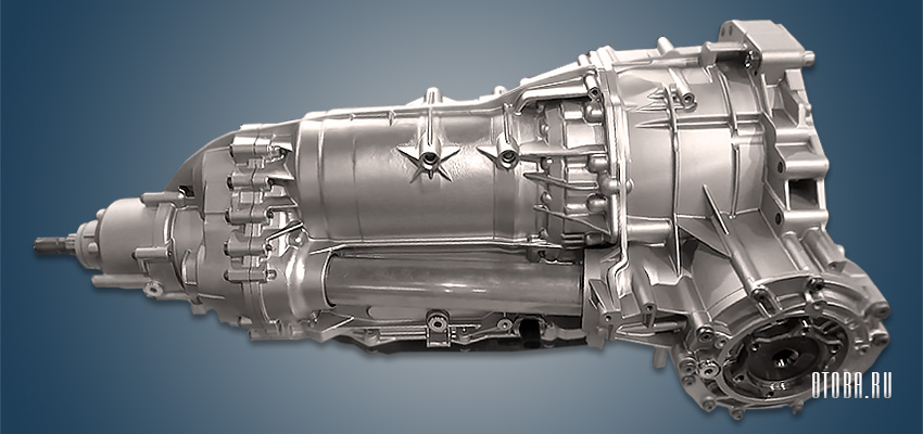

copied from Audi world S-Tronic Dual Clutch Automatic (DSG) Transmission
The S-tronic is a 7-speed dual clutch transmission, and in Audi/VW speak, it is referred to as a Direct-Shift gearbox or DSG. This is an automatic transmission that foregoes the traditional torque converter in favor for two clutch packs. It is effectively two transmissions in one case, as the first clutch is for gears 1, 3, 5 and 7, and the second clutch is for gears 2, 4 and 6. When you're in one gear, the respective clutch is engaged, the other free clutch is able to be electronically controlled to pre-select the gears surrounding it. For example, if you're in 2nd gear, the free clutch is readying 1st gear or 3rd gear for an upshift or downshift; this effectively pre-loads the transmission to make gear changes incredibly quickly.
The DSG is the fastest shifting transmission of the lot, and is generally pretty bulletproof. If you're massively increasing the horsepower of the engine, the stock clutches may experience increased wear and begin to slip, much like a regular manual transmission. Upgrade clutch packs are available for people who want to shoot for big power.
audi a4 b7 b7 tiptronic multitronic DSG dual clutch auto manual 6-speed transmission info reliability questions
Figure 4. Audi S-Tronic transmission/DSG.
