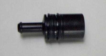

The clutch master cylinder isn't nearly as prone to issues as the slave. Just buy an regular run of the mill master. This is the one I bought a year and a half ago for my Formula. Works just fine.
Since Rodney no longer has the complete slave available any longer, follow his advice and buy his double-seal piston. If your current slave cylinder isn't pitted and/or worn, use the replacement piston in it. If the cylinder is bad, buy a regular run of the mill slave and use Rodney's double-seal piston in it.

Thanks for the reply and yes, I saw Rodney’s advice on the slave and the double-seal piston.

Rodney's dual seal piston has been ordered.
That's the critical part of the slave. IMO, there's probably little difference with the actual cylinders themselves... no matter where they're made.

I would guess your best bet if your fiero isn't a big priority or don't want to spend lots of money
on the car, buy the cheaper slave and buy Rodneys double piston seal plunger and upgrade it to
his parts. Once Rodney gets a manufacture one day to make them again, upgrade to his part entirely.
