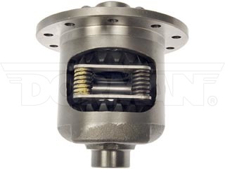

I came across this limited slip differential the other day. Is anyone using one of these?
https://www.dormanproducts....n=Rear&drivetype=RWD
There's also another version (probably a Chinese knock-off) is out there for $200-$300.

The "detailed application" list doesn't mention the Fiero at all, unless I missed it.
Regardless, it looks like a typical RWD (live axle, differential type) LSD, as opposed to something that might fit into a Getrag.
Sorry. Thanks for looking out, though.
You might look up Engineered Performance for limited slip Getrag stuff. Assuming he (Jeff Ianatello) is still doing them.
I've got one in a T-550 (aka Beretta Getrag). It works.

Above Won't Work in any FWD trans Including Getrag.

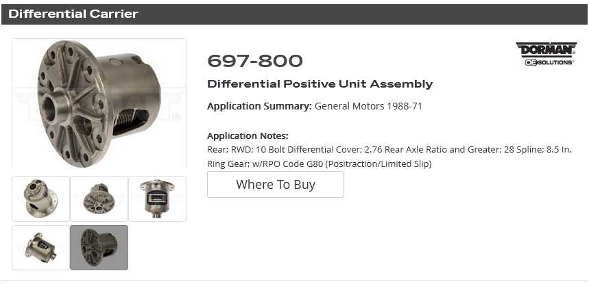

"Detailed Applications:
Year: 1988
Make: Pontiac
Model: Fiero
Configuration: RWD
Application Notes: 28 Spline; w/RPO Code G80 (Positraction/Limited Slip); 8.5 In. Ring Gear; 10 Bolt Differential Cover; 2.76 Rear Axle Ratio and Greater"
I've never seen a Fiero Getrag diff. Just saying, this is what the listing says.

Looks like the website just lumped everything that was RWD as having a 10-bolt rear-end solid rear axle... oh well.

You have to watch Dorman Application Lists.
Many lists have wrong data for vehicles a part will fit or not.
In this case, the description in page tells won't fit in FWD trans that all Fiero have even 99% of engine swap have.
Application Notes:
Rear; RWD; 10 Bolt Differential Cover; 2.76 Rear Axle Ratio and Greater; 28 Spline; 8.5 In. Ring Gear; w/ RPO Code G80 (Positraction/Limited Slip)
Next part of page is mostly same.
If you bother to read more of the App list...
Fist clue has wrong data is seeing a List has Trucks & Chevrolet Camaro listed w/ Fiero for a rear axle part.
