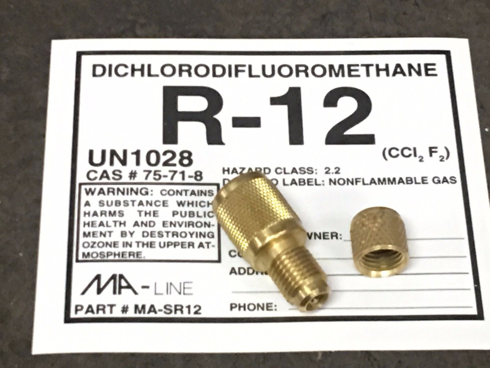

A friend told me that R12 and R134 would have unique port connectors. Is that true for cars that have been converted?
Yes that's true!!!. R-134a hoses from an A/C gauge set are quick connect. R-12 gauge hoses are screw-on. The R-134a hose connections will look something similar to the male quick connect on an air tool. For sure R-134a gauges cannot connect to a R-12 connection. The major auto parts stores all lend out A/C gauges.
R-134a adapters have to be installed when doing a conversion.

sanderson231 is true... We'll call this a Sniffer for easy ref...
A friend told me that R12 and R134 would have unique port connectors... Is that true for cars that have been converted?
Legally R134 conversion requires test fittings to match R type... In shot you put Permanent R134 "adapters" on R12 High and Low test ports and Label for R134 conversion.
But Do Not Trust fitting used because many simply skip this or worse use illegal Refrigerates that don't have fittings for vehicle use.

I bought an R12 gage set off of eBay, but the high-side hose is the same fitting as the low-side, instead of being the smaller thread.
When I look up adapters, I just get the R12 threaded to R134 quick connect adapters, and those specify the same threads for both low/high. I can't seem to find anything to hook up to the R12 high port.
What am I missing?

Post a picture of the ports on the a/c lines and I’ll tell you what you have……. R12 they look like a tire valve and 134A is a whole different animal……
