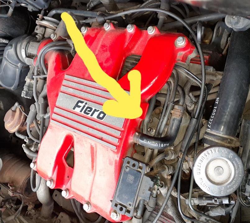

How does it connect? On the 2.8 there's a fitting on the fuel rail right up by the intake that looks like a tire valve (with a cap on it). A fuel pressure tester just screws onto there.
Is this the test fitting?
Posts: 39411
Total ratings: 464
Report this Post07-31-2022 12:39 AM Click Here to See the Profile for PatrickSend a Private Message to PatrickEdit/Delete MessageReply w/QuoteDirect Link to This Post
Yessir.

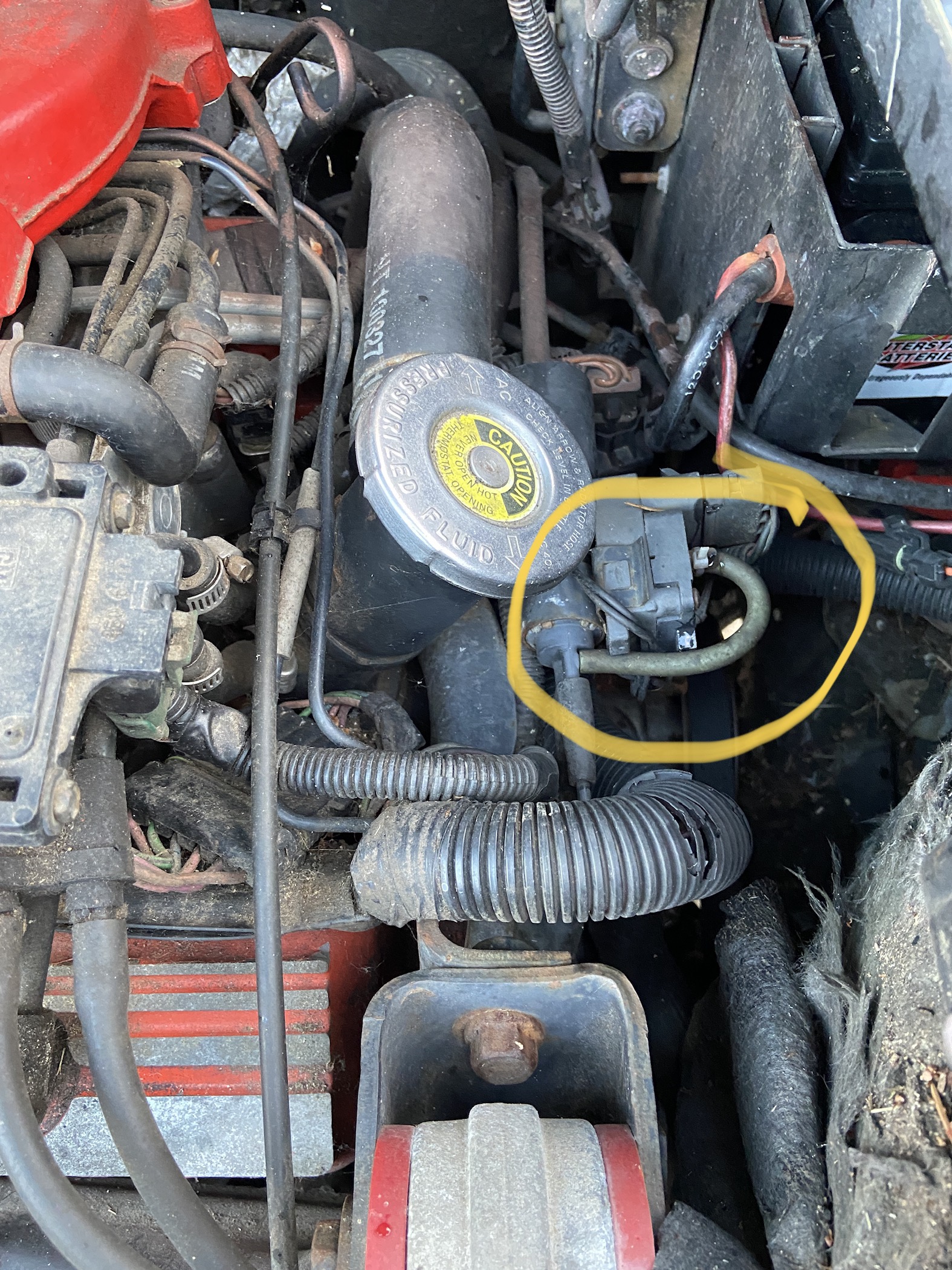

Hey IMSa GT, can you do me a favor and post a pic of the area I’ve circled? I know I don’t have the correct hose connection but have never found a good reference photo
This is the vacuum routing for the 2.8. This was drawn by one of our members, Buddycraig to make it easier.
This is another picture but with a stainless steel line upgrade.

Thank you very much!!!
