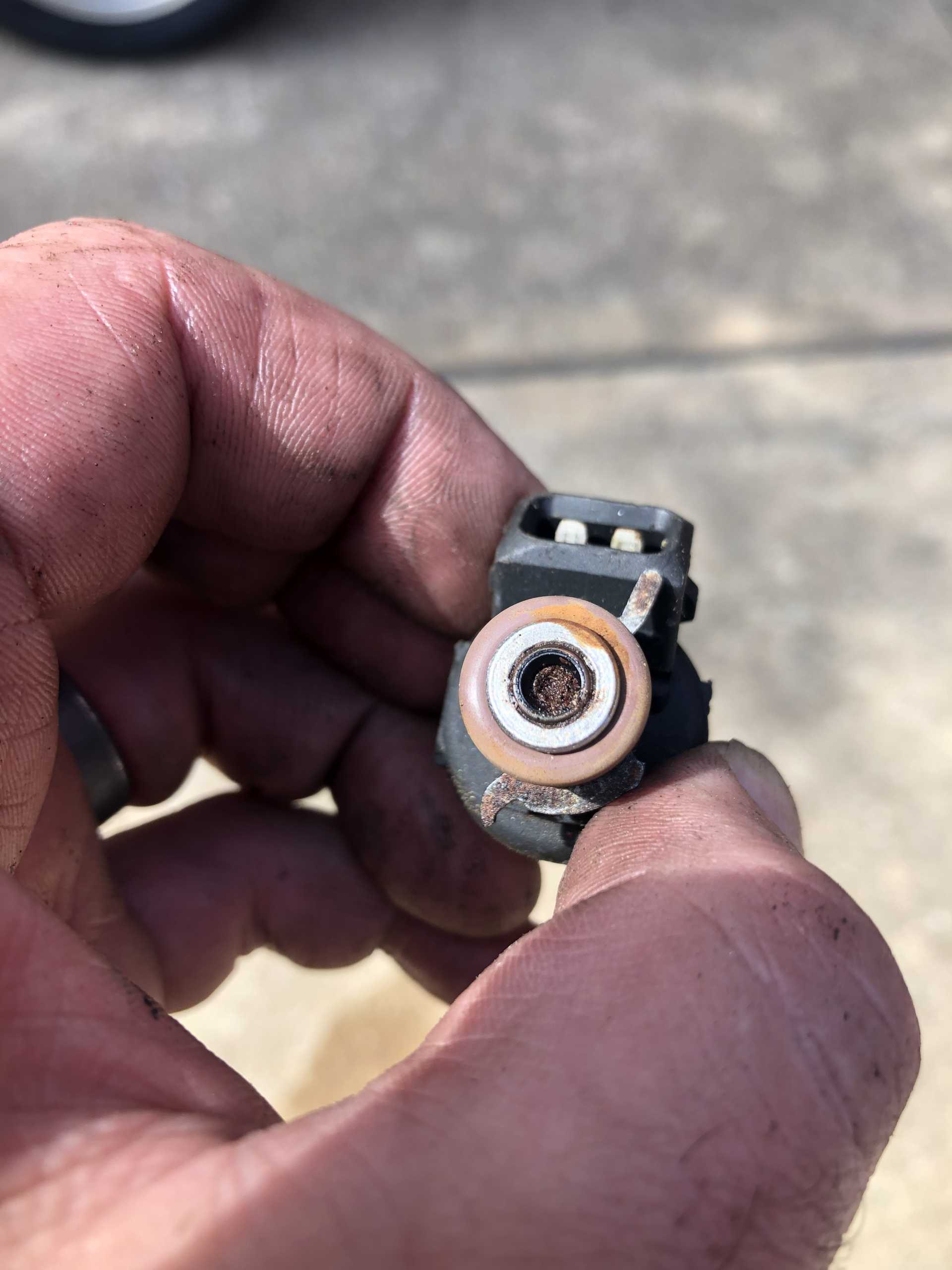

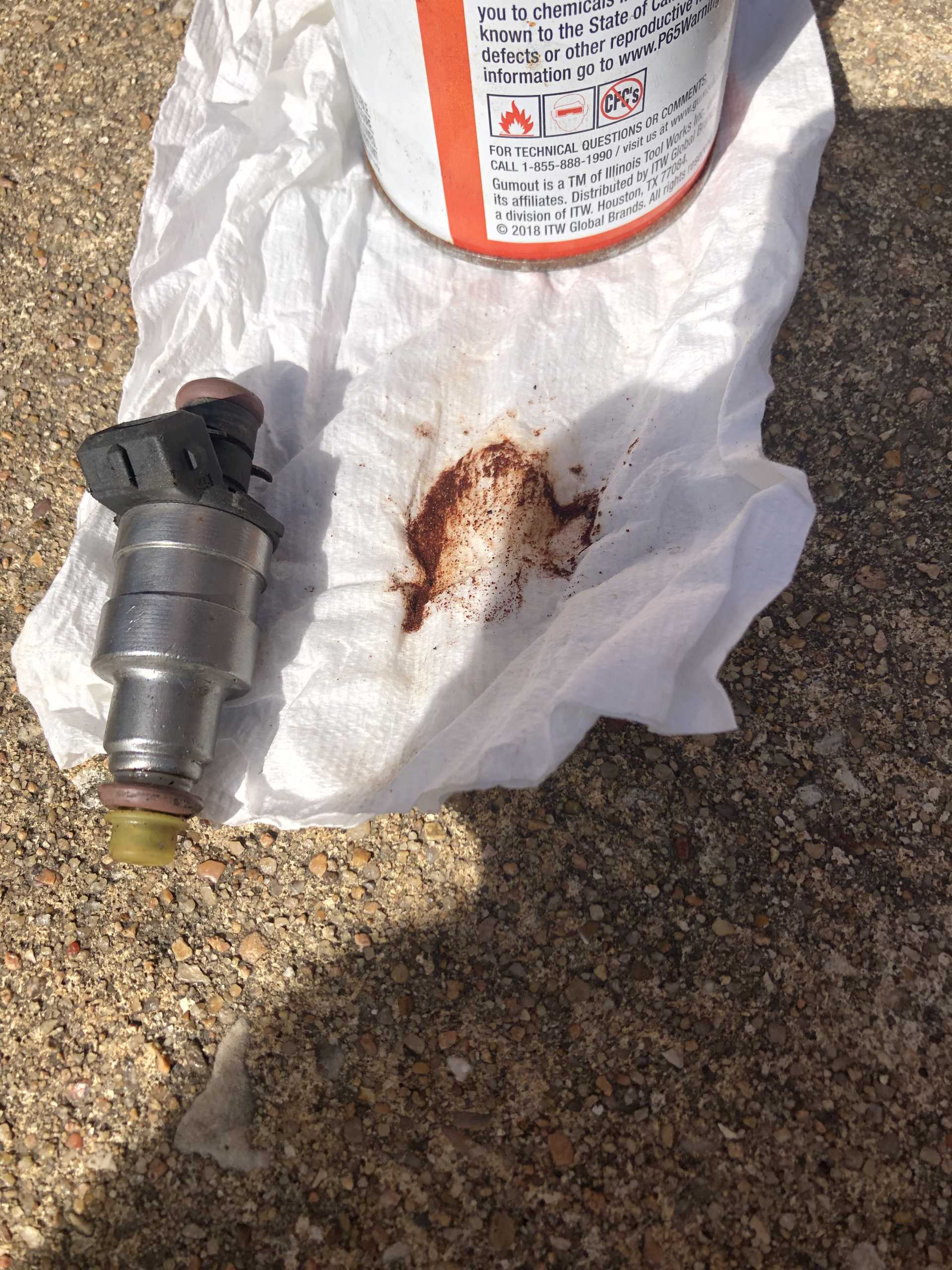

Report this Post05-04-2022 07:04 PM Click Here to See the Profile for ForrestSend a Private Message to ForrestEdit/Delete MessageReply w/QuoteDirect Link to This Post
So yeah….clogged injector…..
I dont know how it got so dirty. Guessing moving the fuel lines around broke some rust loose somewhere. The filter is fairly new.

The plugged injector/all the injectors have been cleaned and installed along with the fuel rail.
She purrs now!
Still a little hesitation (I think its that old cat)
