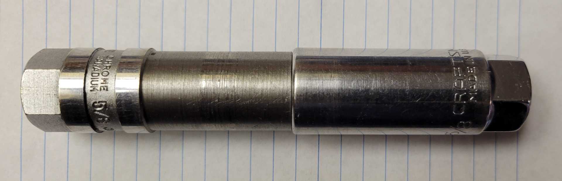

As others have said, it is essential that the plug wells be clean before any attempt at removing the spark plugs.
However, it is possible that your plug socket's OD is too big for the plug wells. I had an 86 Firebird back in the day with the same 2.8L V6, and my Craftsman plug socket simply wouldn't fit the plug wells. I bought another socket and turned it down on a lathe:
The OD of the Craftsman socket is 0.886"; the modified one is 0.810". I don't know whether I needed to turn it down that far, but then it fit the Firebird and it's the only one I've used on my Fiero. But I just went out to the garage and checked (on the #3 plug), and the Craftsman socket fit nicely. So did a slightly bigger S-K that I have. So I guess I'd make sure it's the socket that won't fit into a clean plug well... but it's possible.
