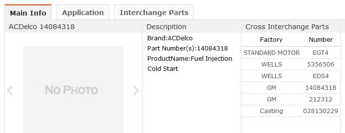

GM / AC Delco part number is 14084318
It cross references to a Standard Motor Products etc.
Bosch 0280130229 is the same item.
I got a spare from a German car at the wrecking yard some time back.
[This message has been edited by fierosound (edited 01-27-2022).]
