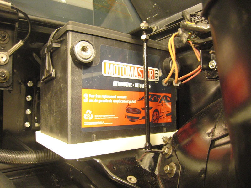

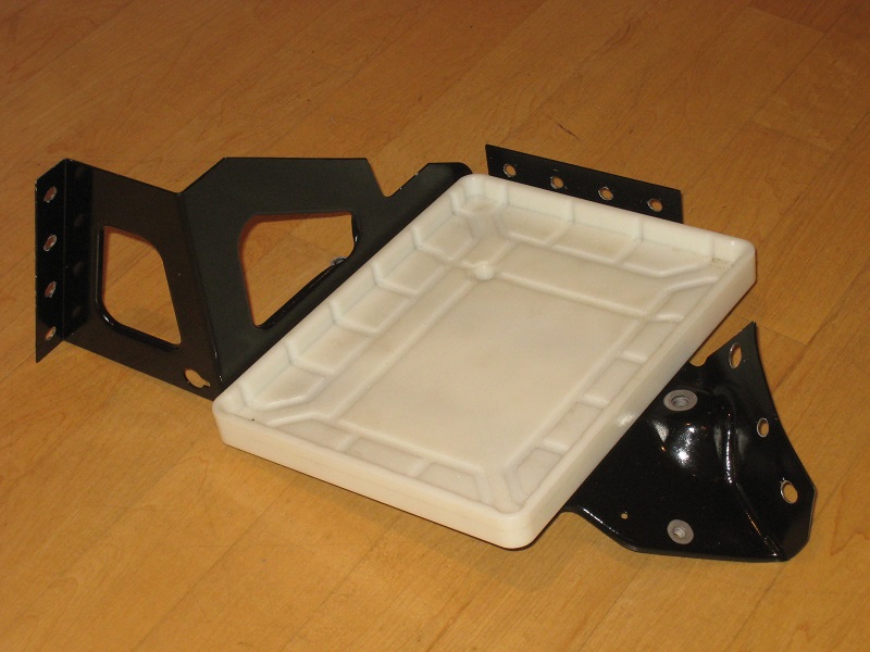

Originally posted by cvxjet:
The smartest thing Pontiac could have done is to just make a plastic platform with a drain tube to down below the chassis......
In building the perfect project car, Pontiac did the next best thing; they left the fun of making the plastic platform to the car owner!
Plastic platform with drain channels and drain holes:
Installed in the car with tie-down rods and a steel flatbar over the top:
Yes, my Fiero has a drain tube, and it terminates about 1/4" below the rocker panel.
