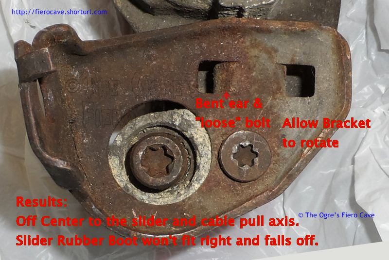

Don't remove cable bracket from the caliper.
Often you damage caliper by removing/installing the bolt or you can't get the bolt tight again and bracket moves using P-brake.
Take cable off/out of caliper bracket.
If have rust/dirt under ears, remove w/ small screw driver etc.

Those Ears hold enough so jacket end stay strait in the holes and stay there if/when cable core is loose or bad for whatever reason/problem.
If a core breaks and ears are gone then can make axle or brake problems... from a torn CV boot to a lot worse.
Is bad enough caliper cable bracket uses 1 bolt and bit of bent metal to keep the cable in place.
Often the bolt isn't tight or parts "rust" and bracket works loose some and causes cable and slider problems...
Bent side should be identical to the right tab but bent almost to clear the caliper.
Tried to remove the bolt to fix but nothing and high risk wrecking the Torx hole and/or head. (Can see some load damage on T45 or T47 head...)
Likely part of reasons why people have problems adjusting the cables.
