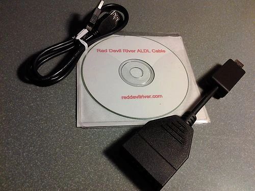

Originally posted by eti engineer:
...maybe I need to see if I can get my money back.
If you can, you should. I'm not sure why you selected that particular device, but IMO you paid twice as much as you needed to. For half of what you paid, you could buy the ALDL to USB cable that PFF member PhoneDawgz sells. Here is a link to what you need.
With this cable, you can then run free programs such as WinALDL and/or TunerPro which will be just as good (if not better) as whatever software came with the Fiero Store scan tool.
[This message has been edited by Patrick (edited 12-01-2021).]
Thanks, Patrick. I think I will try this route. I am tired of messing around with this other stuff. Between Windows 10, Bitlocker, and archaic software, I think it is time for me to try a new path!! I appreciate your getting me headed down what appears to be the right path. Good thing I am trapped at home and can't travel or spend my money other ways right now. I'll just spend it on this. I'm 71, have no debts, live comfortably, and yet next year I am going to be forced to start taking money out of my 401K that I will most likely be just reinvesting in something, after the gubment takes their filthy lucre out of the sum. Why not Fiero stuff, huh?
Patrick, thanks for steering me straight on this. I just finally ordered the stuff that you posted. For 55 bucks, I am willing to give it a shot. I don't want to try and mess around with the stuff I got from the Fiero store. At the time, it was the only thing I had seen, but I shouldn't have been so impatient. I have an older laptop and I think XP is on it, but I don't feel like resurrecting it for something that may not work. What is the old saying for buyer beware?? Caveat Emptor? I learned. Thanks, again, Sensei..
