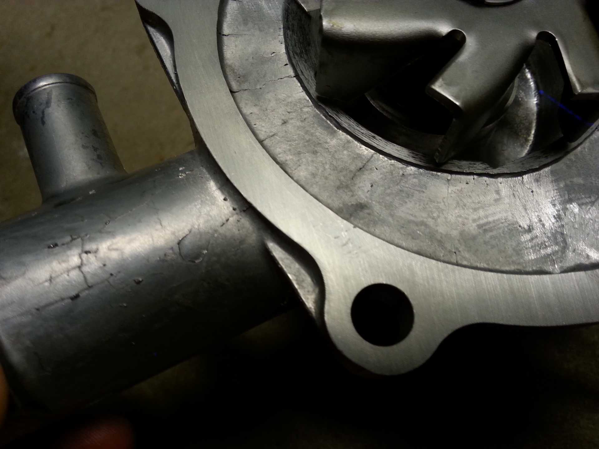

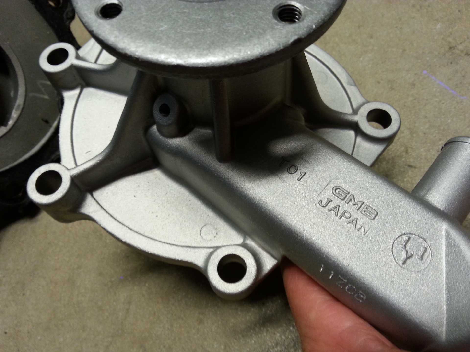

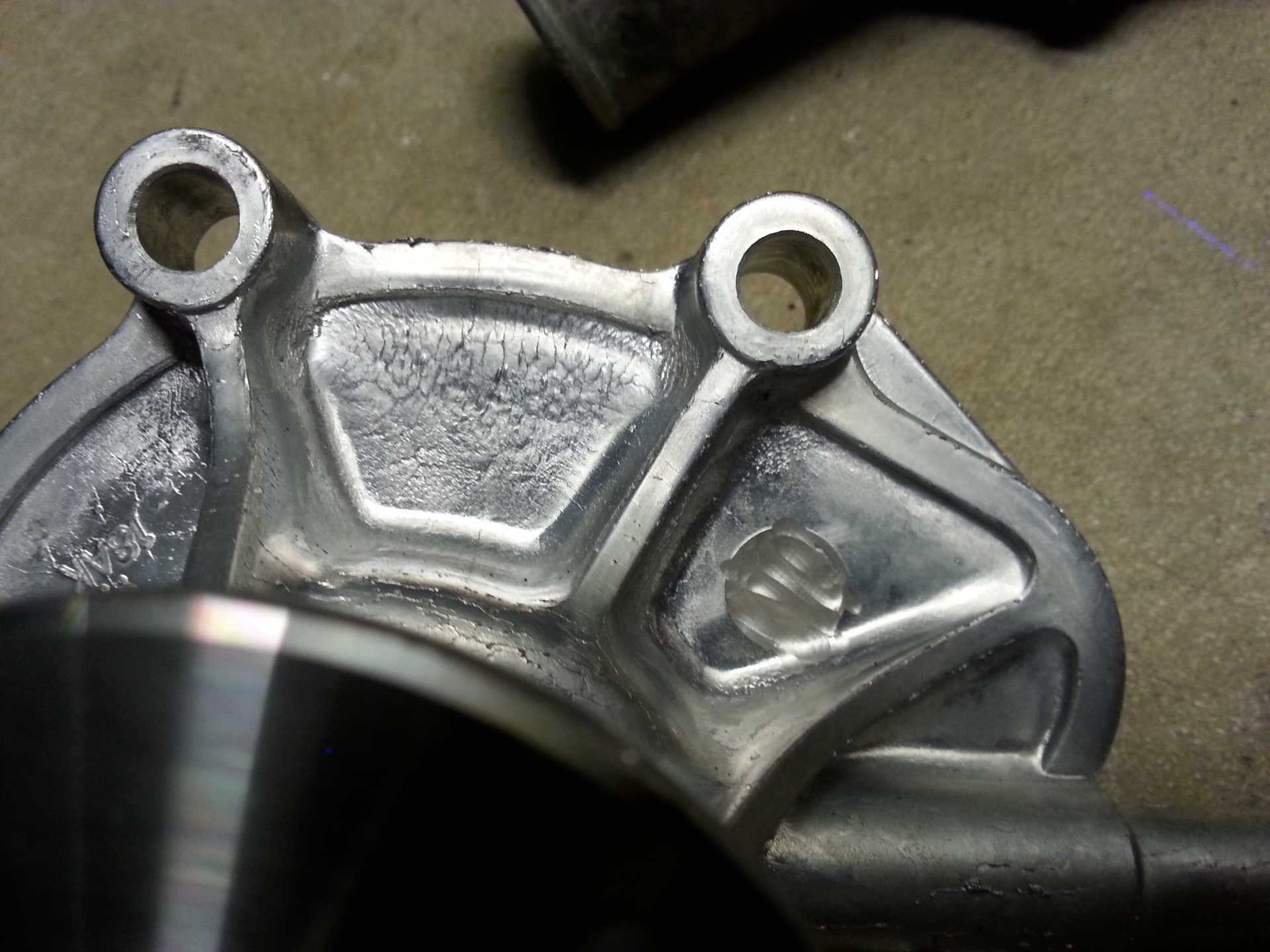

Two quick stories... Wanted to buy a new Made in Japan water pump for the 1977 SR5 that I was restoring because I didn't want the junk aftermarket water pumps being sold by auto parts chains stores. So I ordered a Toyota pump from reputable seller on Amazon. When it arrives and took out of the box I was immediately suspicious. It had tiny cracks, logos ground off, and the casting/mold looked like somebody made it in grade school art class. This was an obvious knock-off, but what amazed me was that somebody in a 3rd world country found it profitable to make knock-off 70's Toyota water pumps and create Toyota boxes for them, unbelievable! So I contacted Advance and only one warehouse had one water pump for my engine, so I rolled the dice and ordered it. When it came in I was shocked how nice it was, turns out it was a quality Made in Japan aftermarket pump, go figure. (photos below)

Sigh. After not receiving an answer for a few hours (yes, I know, people have lives) I did buy that part on Amazon.
Counterfeit pats never even entered into my head, just the possibility of it being the WRONG part.
I was going to buy on Rock Auto, but they didn't have Denso and there were a lot of posts about avoiding Dephi and Bosch (but, nothing about Walker, interestingly, neither good nor bad)
I guess we'll find out on Friday, when it's delivered.
