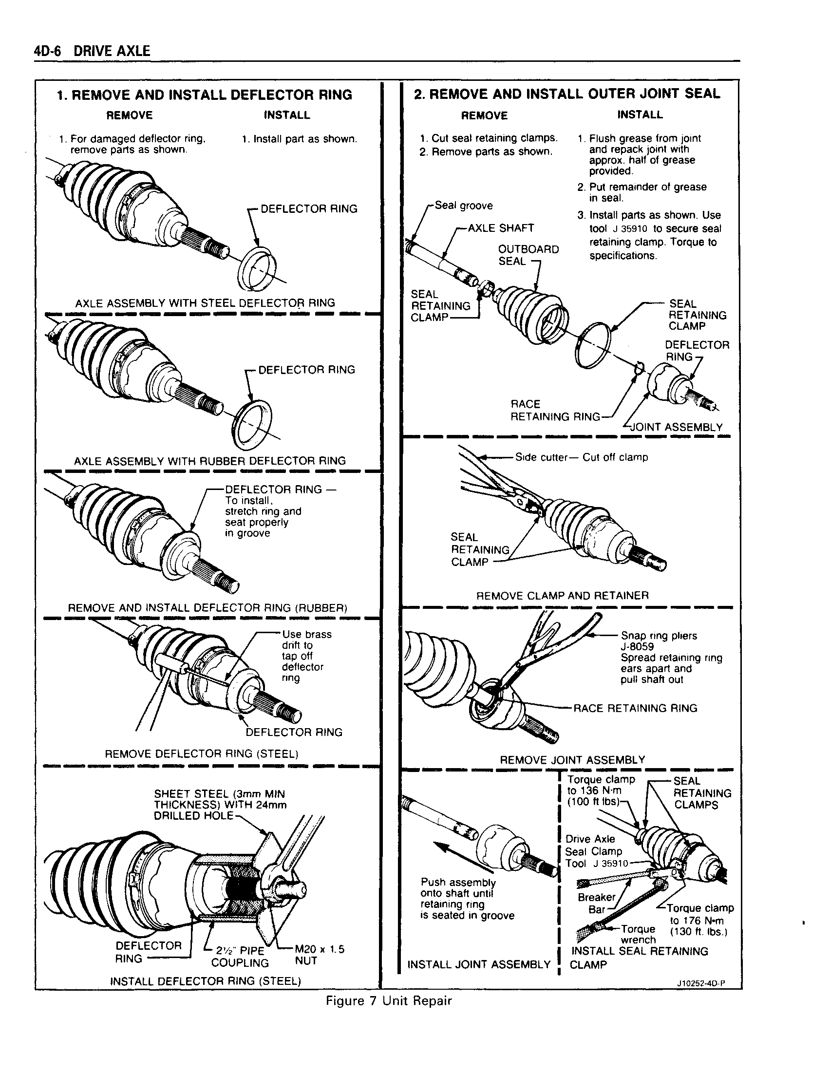

Hope this helps:

Originally posted by Mark_j:
Hope this helps:
It helps a bit, but I cannot find the race retaining clip, is a 88 axle different ?
The picture came from the '88 Service Manual. The snap ring is in there very close to the inner race. As the picture below shows, the snap ring may be recessed. With all the grease in there it may be very hard to see, but it's in there.
Thanks, I took a really close look through all the grease this morning and I believe I found it. When I get home later I will try and remove it.

The ring won't come out.
Expand the ring to "unlock" the axle to remove that from the ball race.
Even then often still hard to pull the axle.
