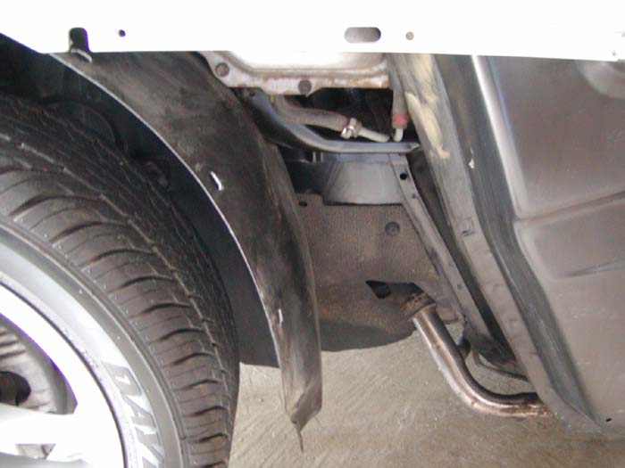

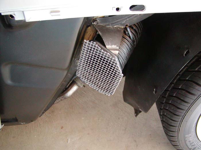

Here are some photos I took when I installed mine 20 years ago so they might help you seeing what's behind beforehand. I also added a extended air duct and attached it to the scoop inlet, and pinched wire mesh over inlet so critters couldn't crawl in.
