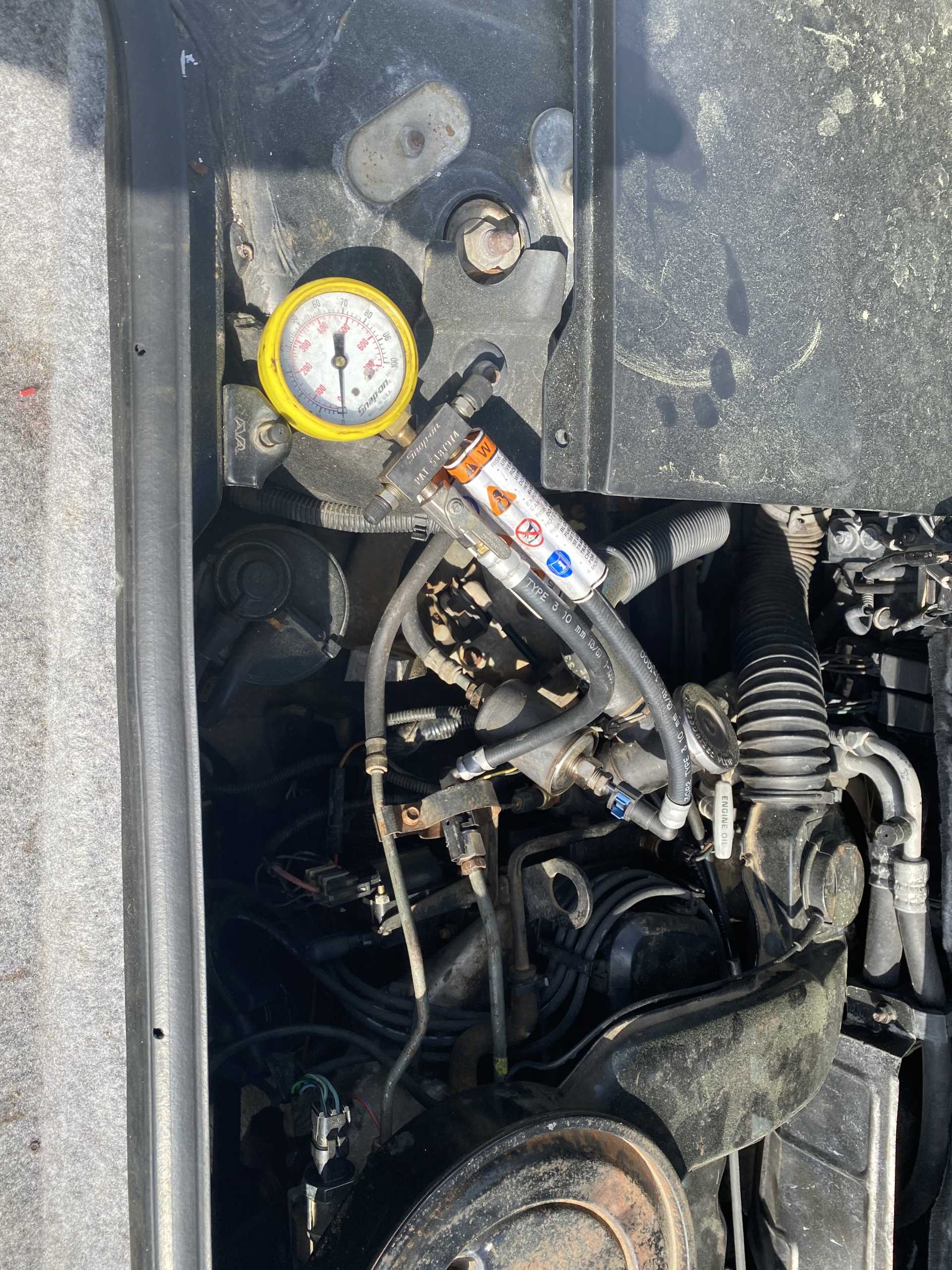

I have, but have not during the event. fuel pressure is on the high side of 13. It doesn't last long enough to check so far.. I'm probably going to fab up a way to have the gauge adapter more permanently installed as the fuel pressure test adapter I have for TBI cars is a log style that temporarily replaces the filter.
Yeah, it's a challenge checking fuel pressure on a duke. It's so easy on the 2.8 engine.

As it turns out, my fuel pressure gauge has the fittings I need to put the gauge inline after the fuel filter. Just checked it. It's got 13 at idle, but if I snap the throttle it drops too much to be good. Pulls down to almost 5.
Thanks for showing me the forest through the trees!.
Now I have to figure out whether it's power related or a restriction.
Very odd. I'll be curious to hear what you eventually discover!
When you turn off the engine, how quickly does the fuel pressure drop? It should hold for quite awhile.

It holds for a short time, but thinking back to my days of wrenching on TBI stuff that's pretty normal. The EFI systems that are 35 PSI+ will hold pressure for a while, but in my experience the low pressure TBI stuff really does not.

I've owned this gauge set for 20 years. Never realized it came with the fittings to do this. You learn something new every day!
