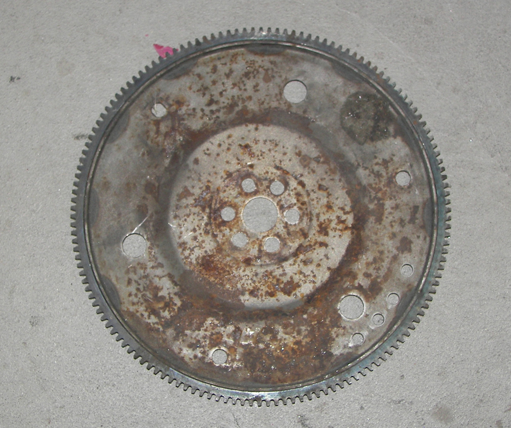

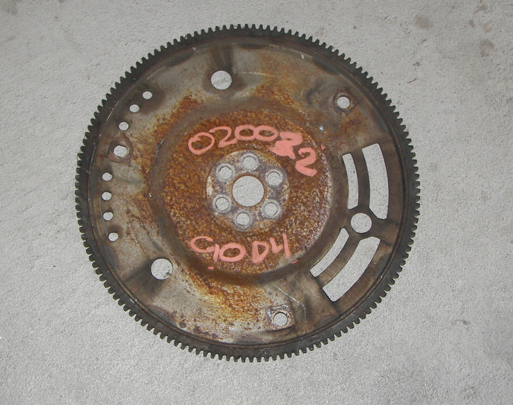

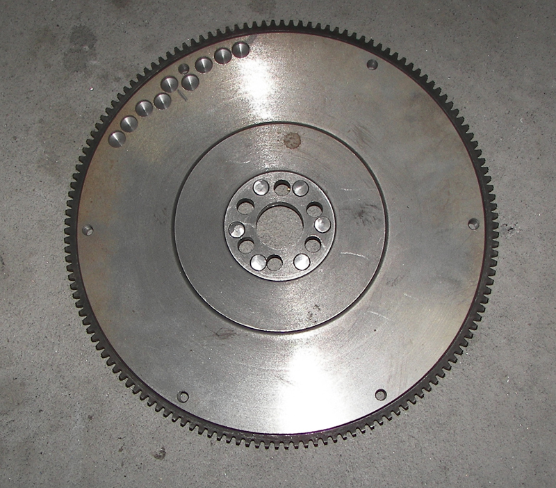

The Cadillac and Allante 4.5 engine is internally balanced on the front half and externally balanced on the back half. I found this out while building a 4.5 for a customer with an aluminum flywheel. You can tell this by looking at the 4.5 flexplate compared to the 4.9 flexplate. The aluminum flywheel was too light to balance so we ended up adding heavy metal to the rear of the crankshaft to get it to balance.
If you are using a steel flywheel, you wont have a balance problem to where you need to add weight to the crank. Just take your 4.5 flexplate and your new flywheel and have it "matched balanced" at your local machine shop. Then you are good to go.
It will look something like this.

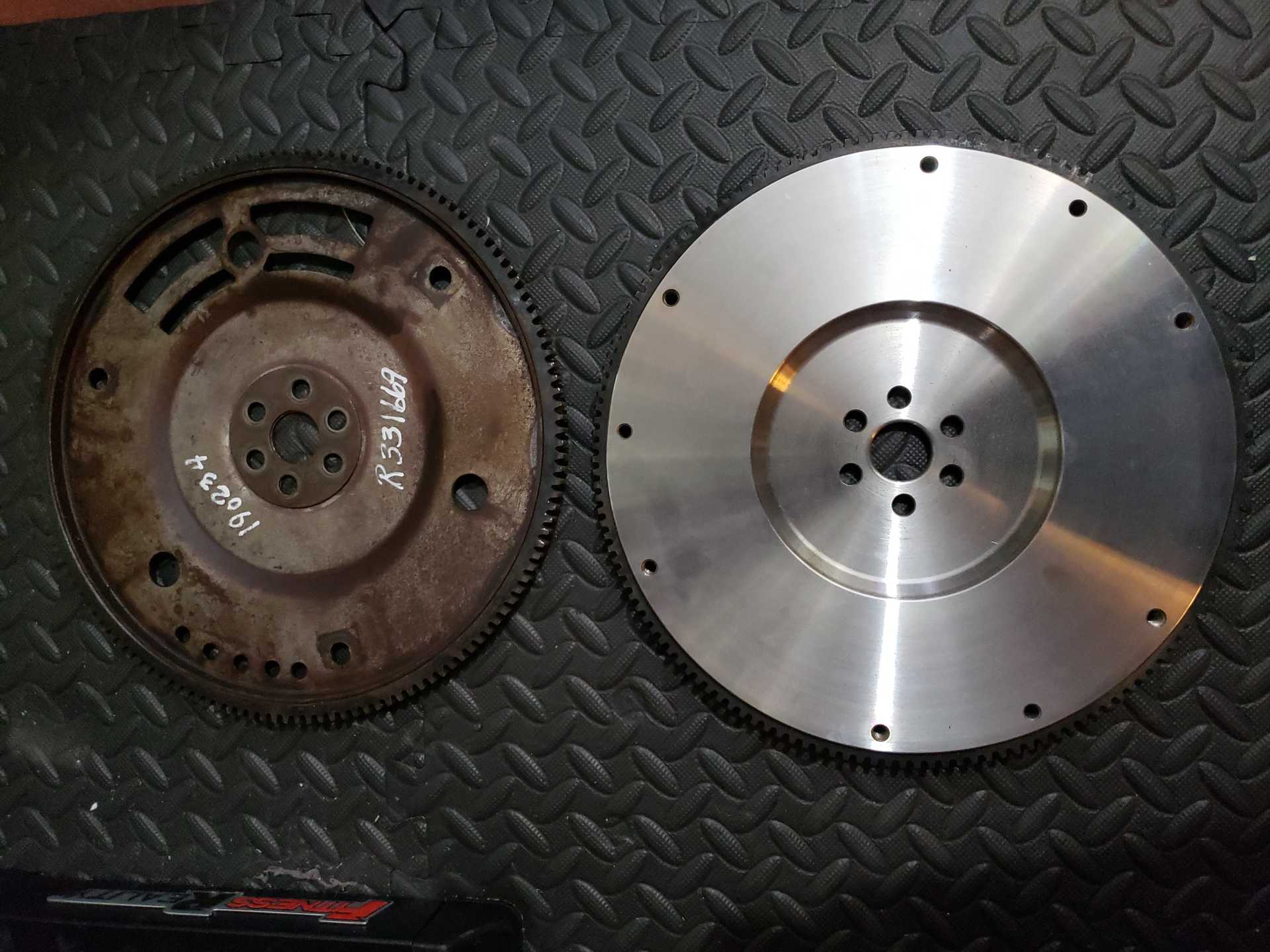

Here's what I have. I put a magnet on the flywheel and it's definitely steel and heavy AF like a street flywheel should be. I'll take them up to a machine shop and have them balance matched. Thanks John.
Thanks Raydar, Dennis, and Spadesluck. for your thoughts. I've texted John a couple times on FaceBook but I'm in FB jail at the moment.
