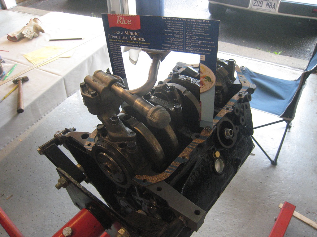

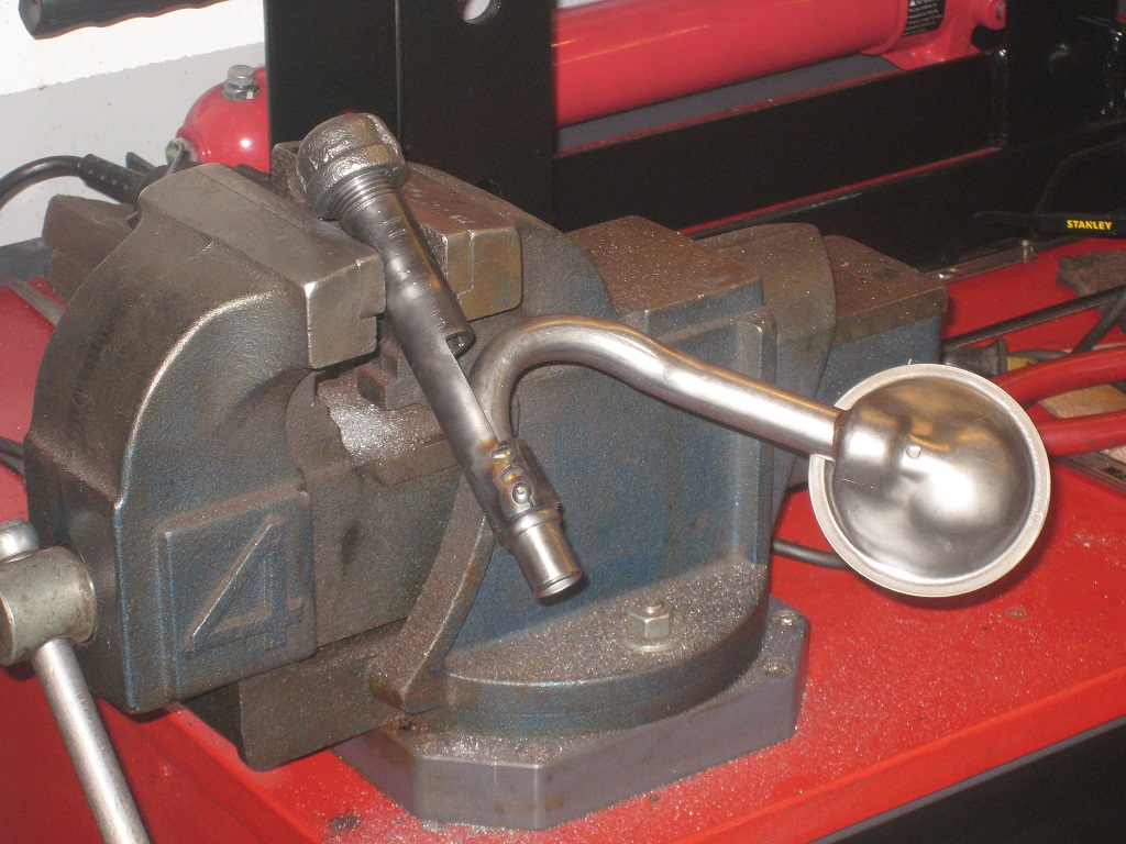

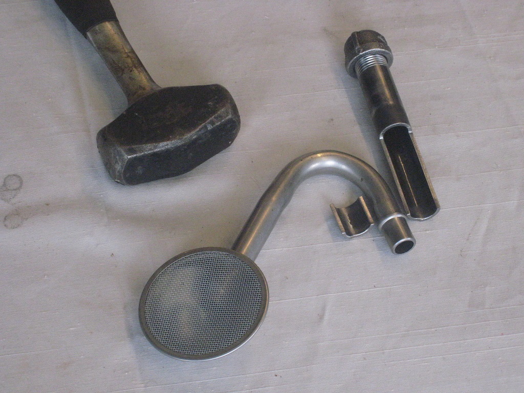

Pieces of pipe, with pipe cap, and cut as per photo.
Half-pipe sections tack-welded around the pickup tube.
Use hammer to hit the end of the pipe. Bolting the oil pump to the engine gives a steady base during this step. Also use a cardboard template to simulate the oil pan. The pickup must be at a certain distance from the bottom of the oil pan.
Once the pickup tube is pressed in place, take the assembly off the engine, and cut off the pressing tool.
Due to the questionable metallurgy of tack-welding steel to cast iron, I decided to silver-solder my pickup tube in place.

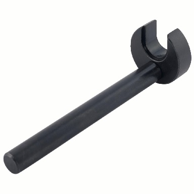

Another DIY installation tool.
https://www.homemadetools.n...up-installation-tool
Use the open end of a wrench that fits snugly above the "bubble" to measure tube diameter.
I'm pretty sure that's all I used to tap the tube into the oil pump as well.
There's even a driver tool like that available for these things.

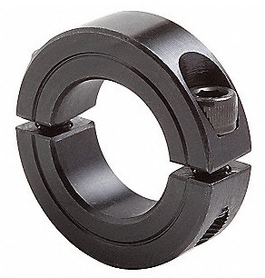

Probably the best solution would be using a shaft collar:
This could be welded to a long rod which could be hit with a hammer.
