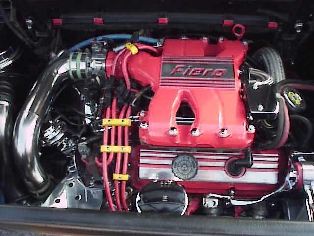

Fran Passuite's Indy Pace Car works very well. Well enough to beat Mustangs
More of Fran's car > https://www.fiero.nl/forum/A...020511-1-014026.html

I just realized after looking over that ^ ^ ^ thread, that someone was obviously very jealous over Fran's car judging by all their false claims.
You see, Fran's car is an Indy Pace Car that he bought brand new.
Fran also sent the car to Don Davis Pontiac to have everything from the back glass back changed using brand new GM parts. This included, but not limited to the fastback rear body panel, quarter windows, tail lamp assemblies and the 2.8L Fiero GT crate engine. He then had a turbo system specially built for the car. He also sent the car to Autobahn Body Werks to have the custom hood hand formed. All this along with many other mods made it a one of a kind.
Fran's IPC was the first to be converted to a fastback, first to be turbocharged, first to have 16" wheels, along with a host of many other firsts.
If someone besides Fran knows more about Fran's Indy, I'm all ears.

Don, I appreciate your optimism but I consider running that much boost on stock old cast pistons risky. If you get away with it, consider yourself lucky. Cast pistons should be fine for low boost levels. If higher than 6-7 lbs a pyrometer (EGT gauge) that will warn you if you're overheating the pistons might be a good idea. What will kill them really fast is detonation and only one case at WOT may be all that you'll need and this is the result
http://images.fieroforum.co...520LaGrua/piston.JPG
Modern advanced engine controls have allowed traditionally "fragile" combinations to make tremendous power for what used to be considered extremely long service lives. Without detonation, amazing combinations can live. With detonation, nothing can live.
This drives home the point that if you're melting pistons, your tune is bad. Full stop.
Pistons don't melt from making power. They melt from detonation.
