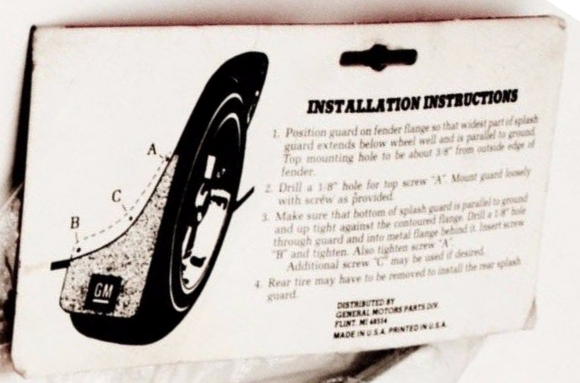

There's a NOS set of GM Fiero mudflaps for sale on Ebay. Apparently they attach with 3 screws. Here are the instructions:
https://www.ebay.com/itm/Po...t-of-2-/303490724475

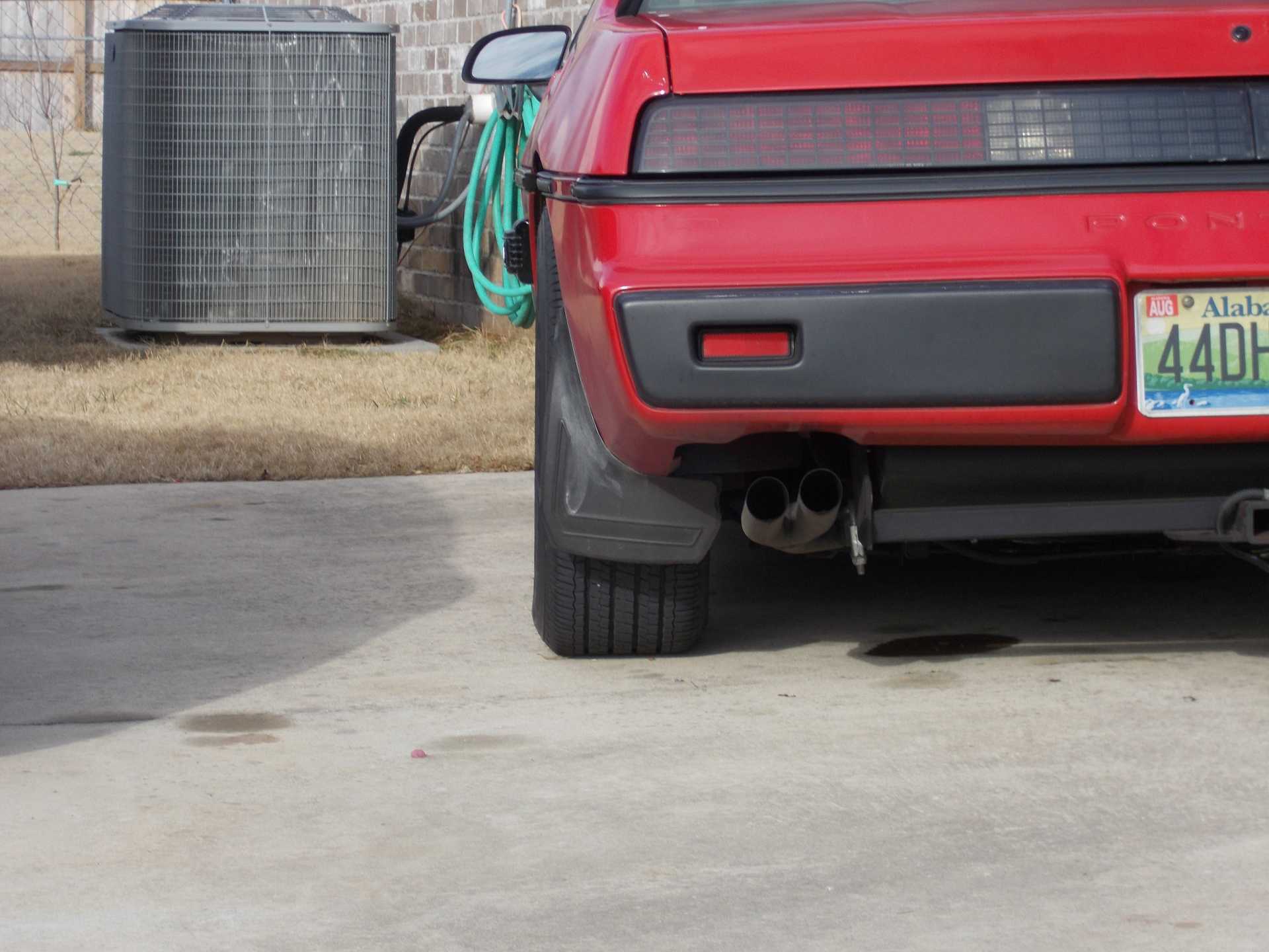

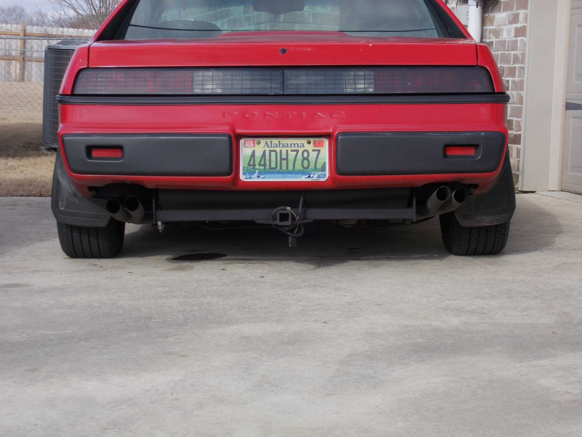

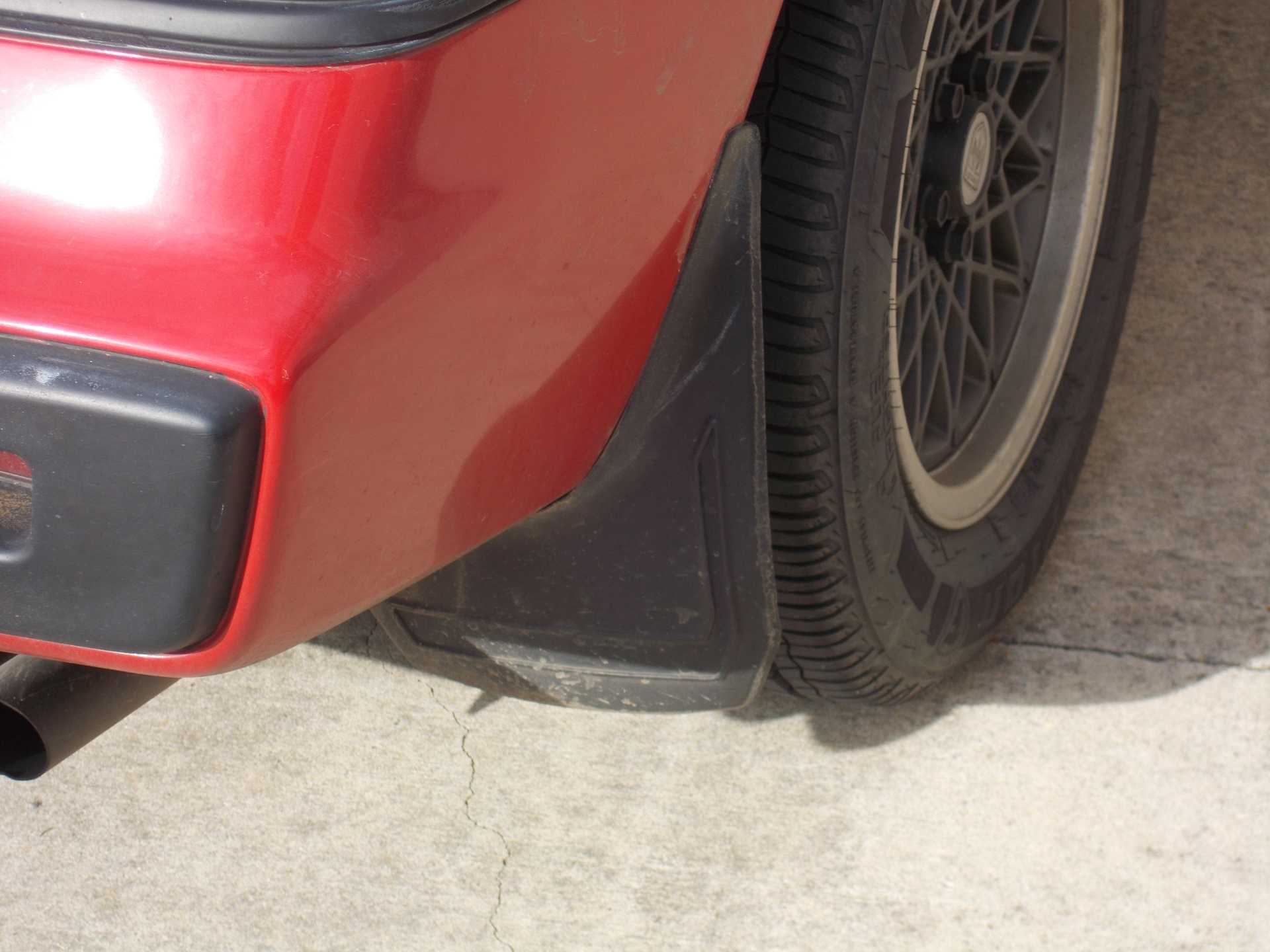

I bought a pair when the Fiero was new. Still have them on my car. I'll try to post pics tomorrow.

I bought these back in 1985 or 1986. Havent seen any like them since. [img]https://images.fiero.nl/userimages/r on768/DSCN0007.JPG[/img]
