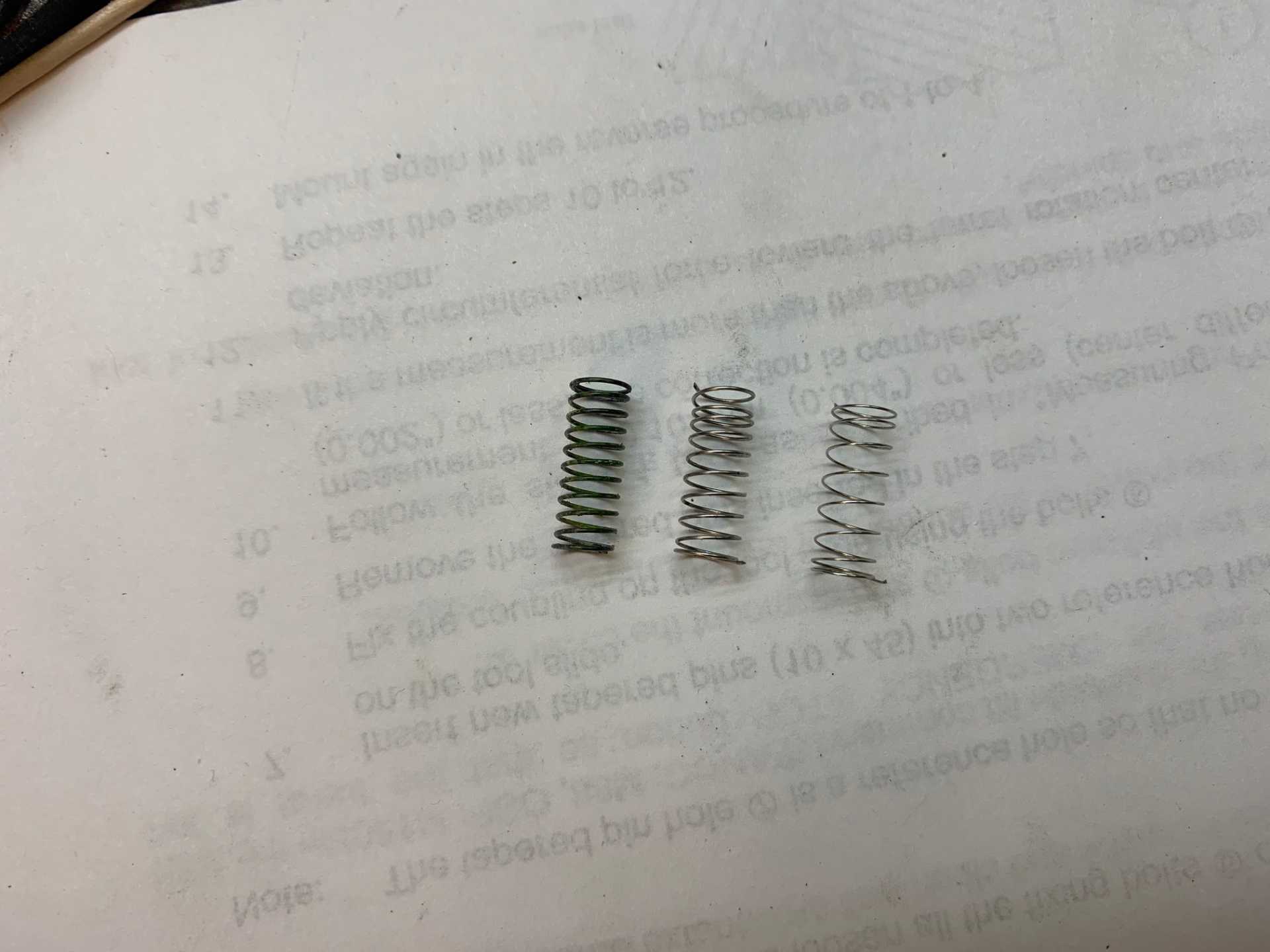

Transgo shift kit (easy enough to install "on car" but leave out replacement governor spring)
Use a big transmission cooler
Replace all fluid with Type F
YMMV

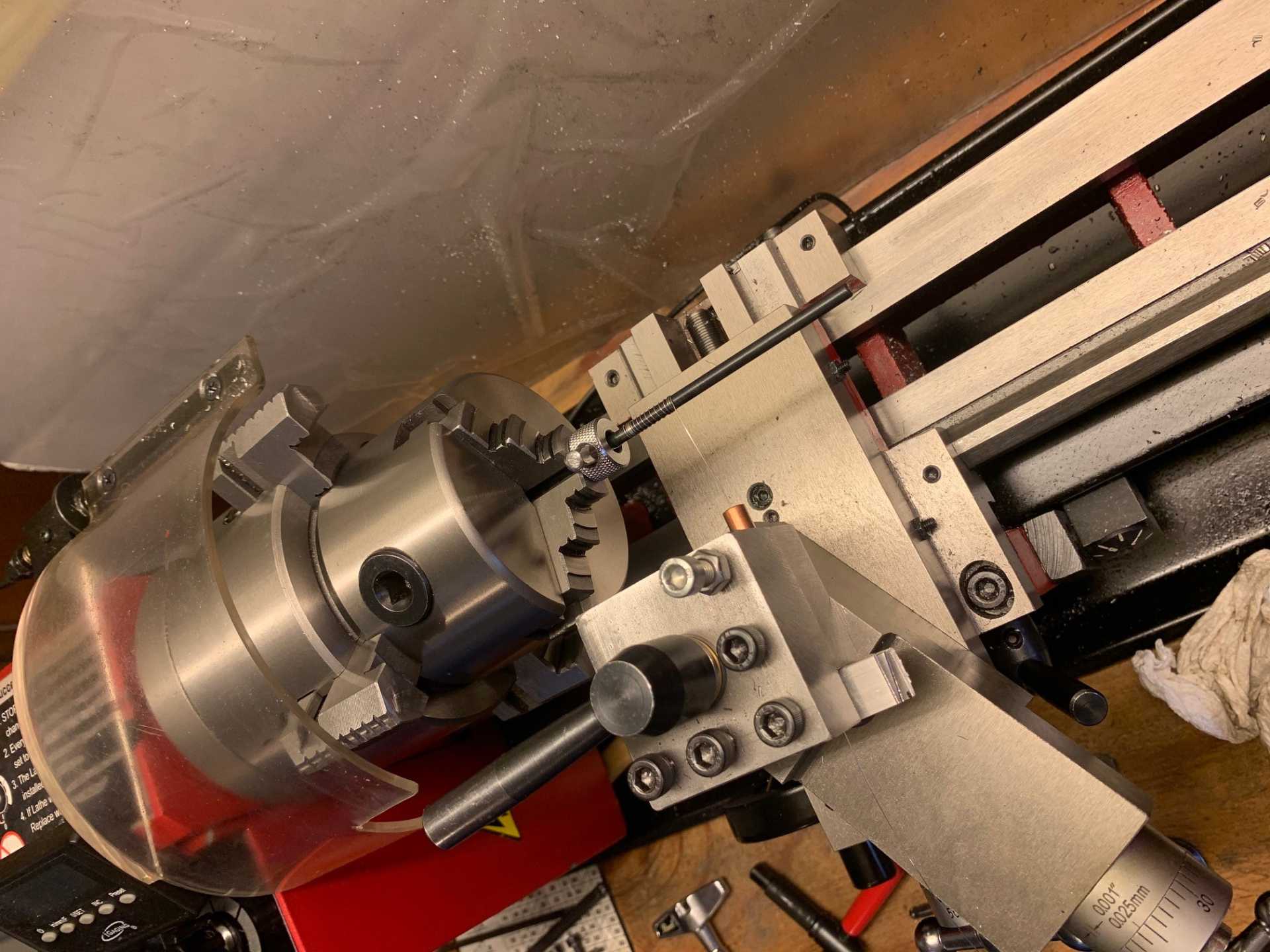

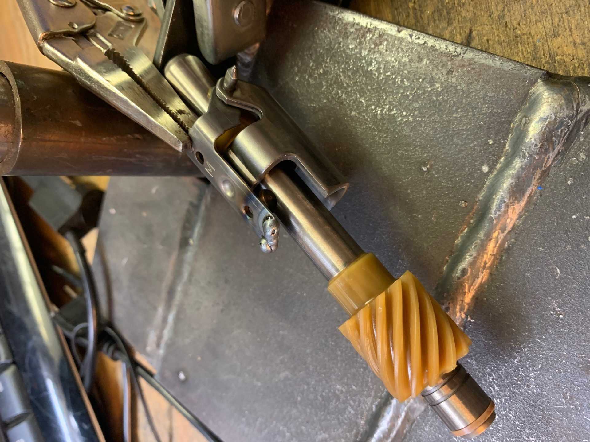

Depending on how much power the engine is making and where, the WOT shift points may move higher than you'd like due to converter "slip." On mine, I had to add weld filler for weight and make my own governor springs to bring it back down.
