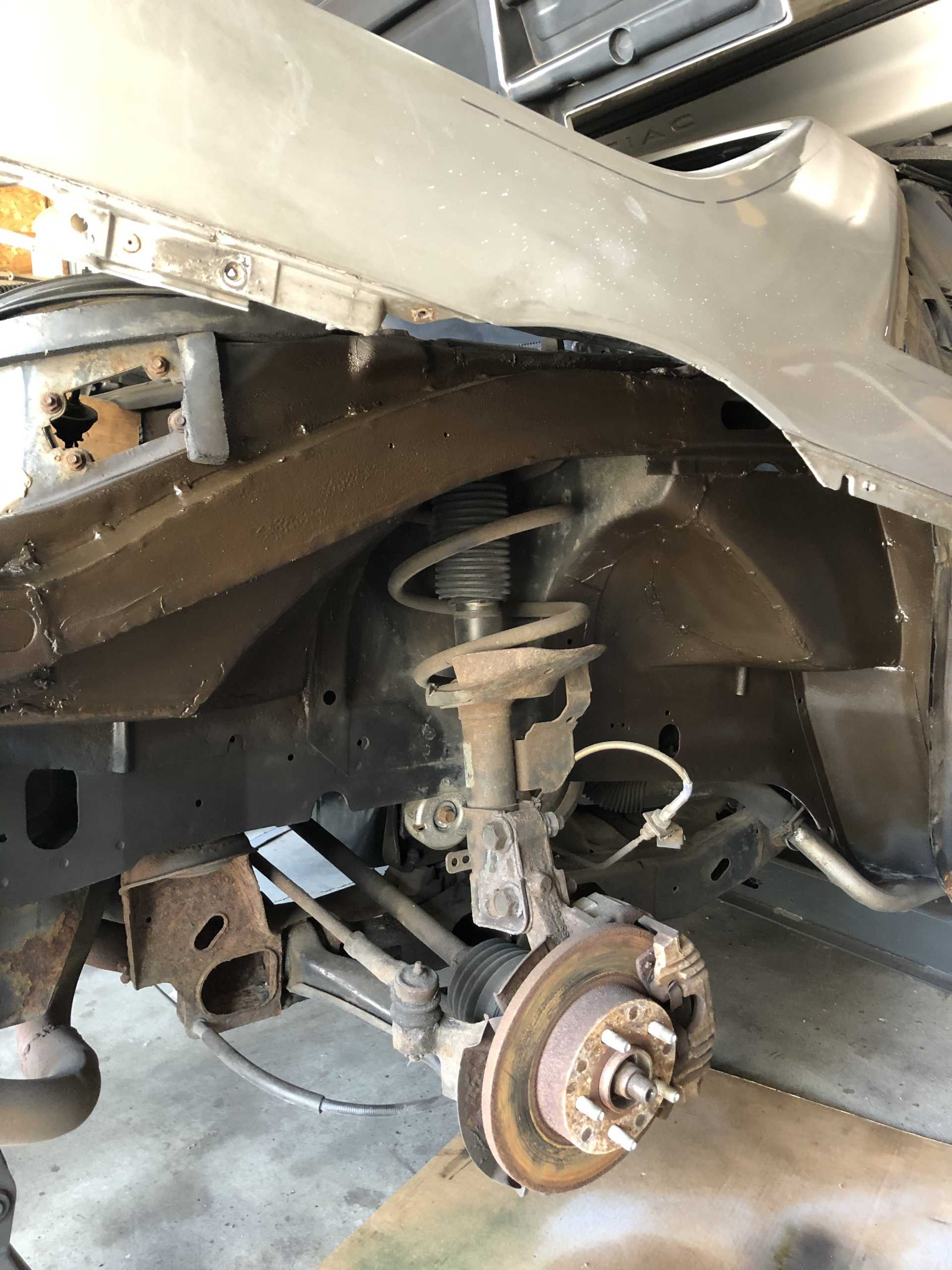

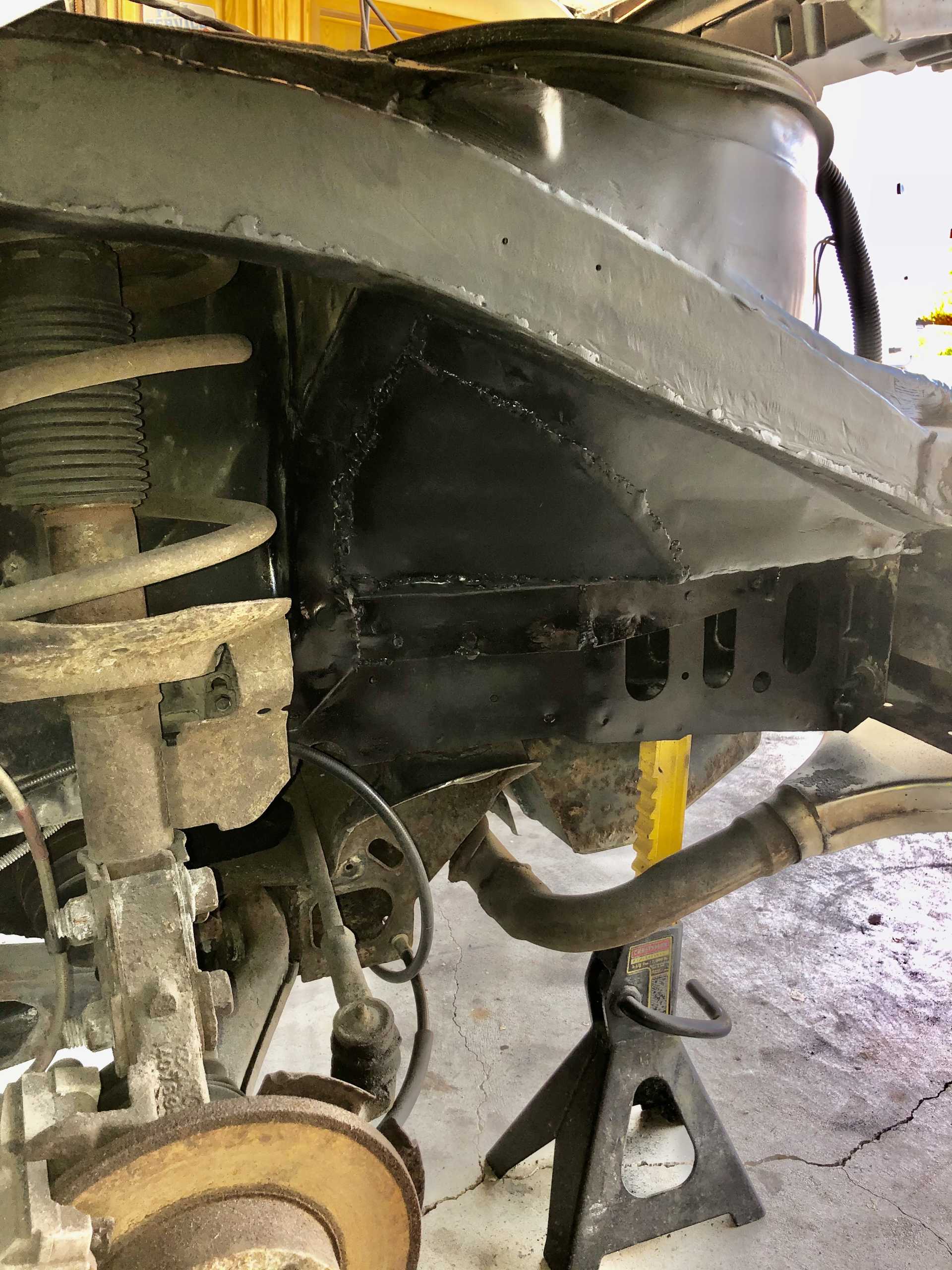

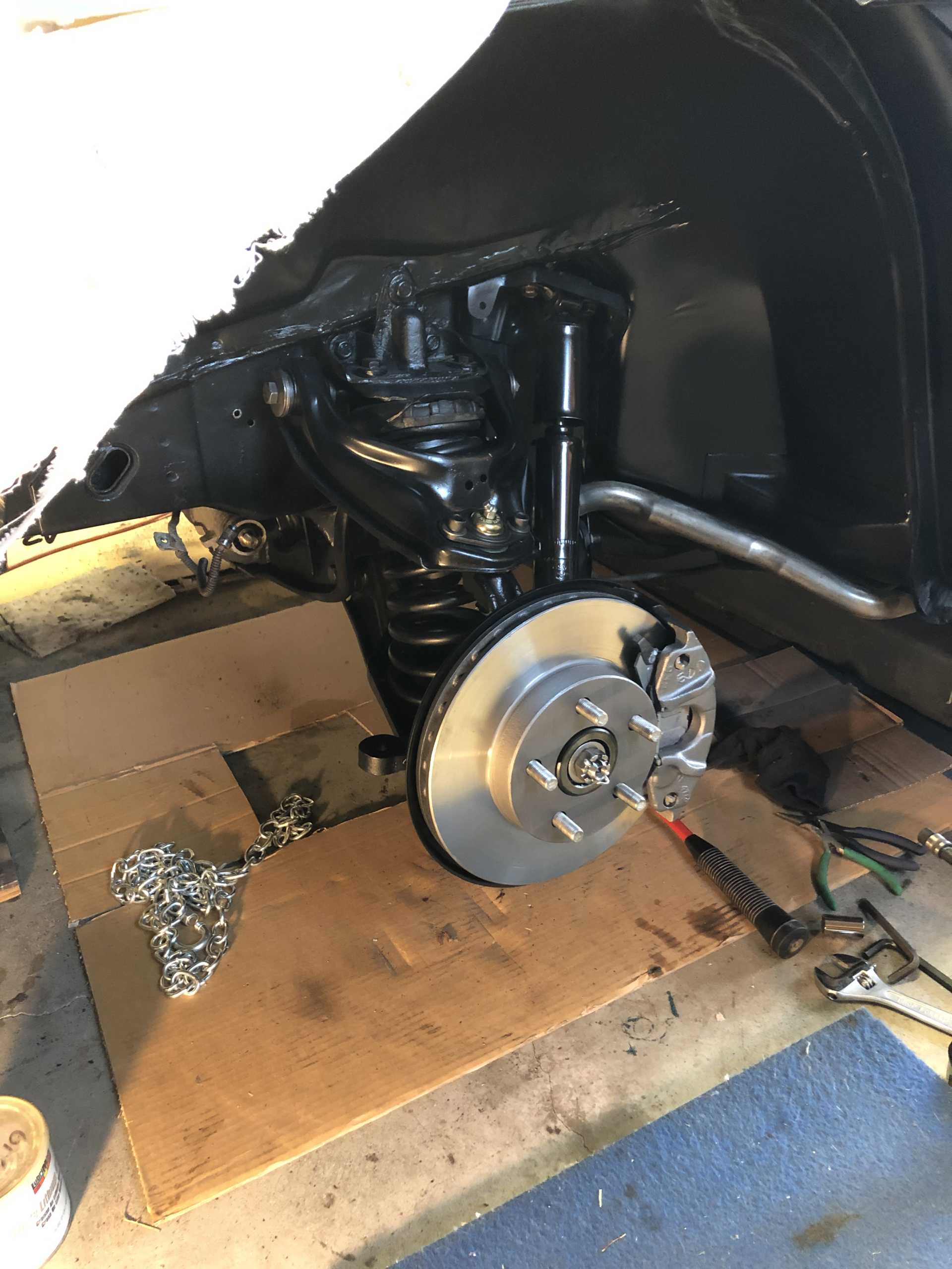

After 16 years of a daily driver... from Illinois to Texas to Ohio my son brought the car back for some much needed tlc. Started with rebuilding everything in the front of the car I’m moving to the back.

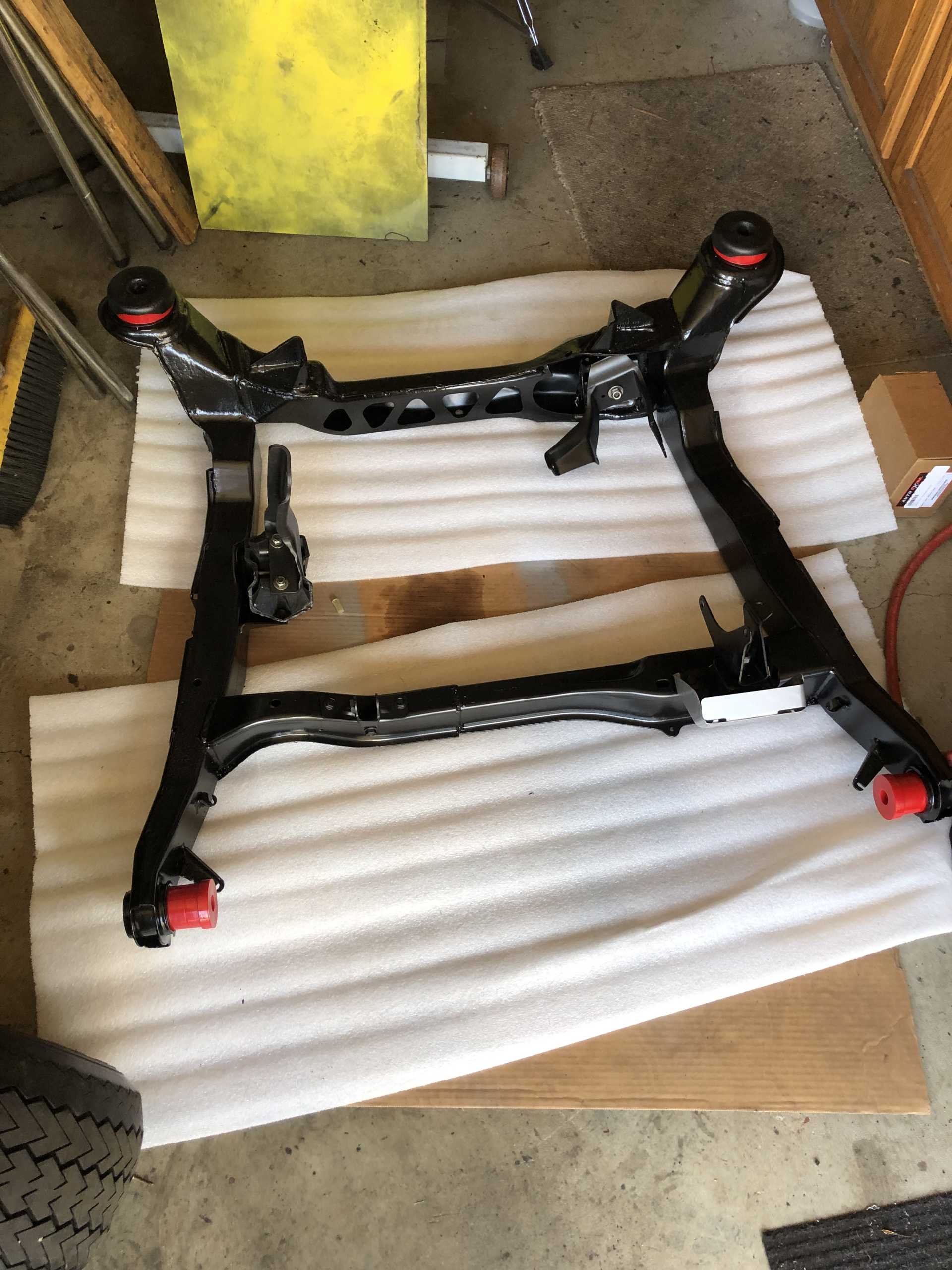

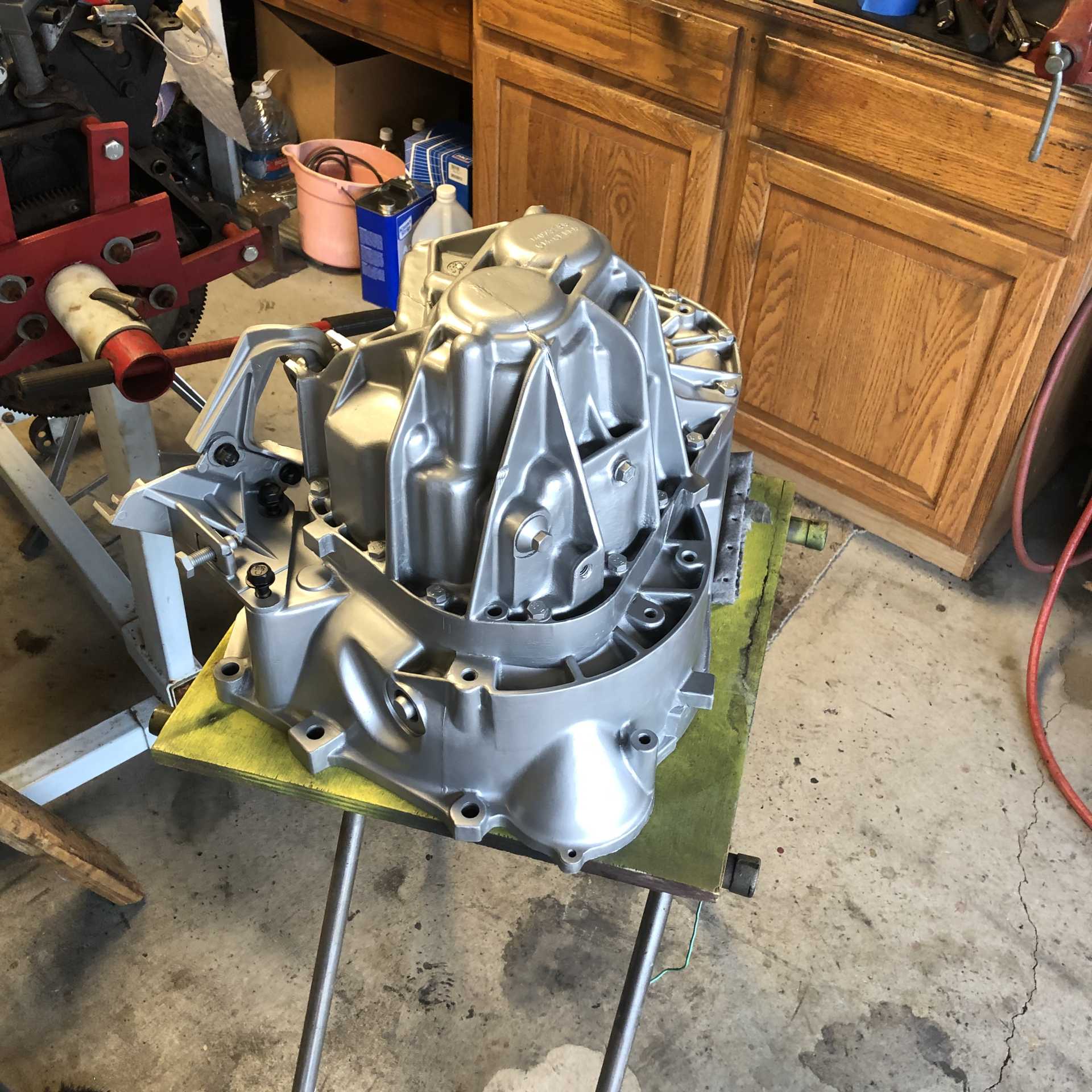

Got the cradle back from the powder coater and the trans cleaned and painted

So, is it easier to mount the engine and trans at the same time or trans first then motor ?
Posts: 16201
From: Hillsborough, NJ U.S.A.
Total ratings: 326
Report this Post08-31-2021 07:48 AM Click Here to See the Profile for Dennis LaGruaSend a Private Message to Dennis LaGruaEdit/Delete MessageReply w/QuoteDirect Link to This Post
It can be done either way with the stick, but we prefer to mount engine and transmission together then mount the powertrain to the cradle as an assembly. Nice metal work.

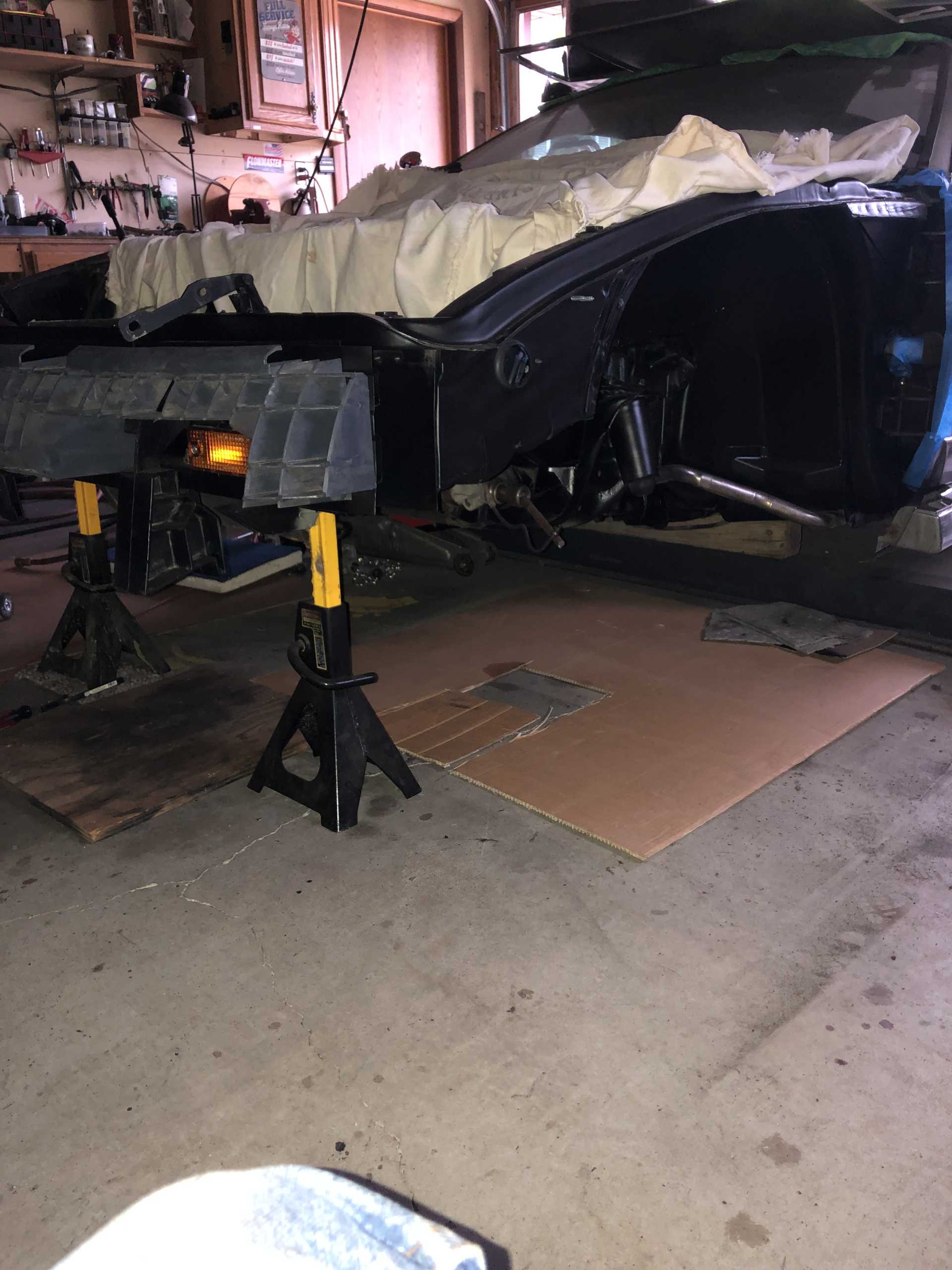

It’s back on !
