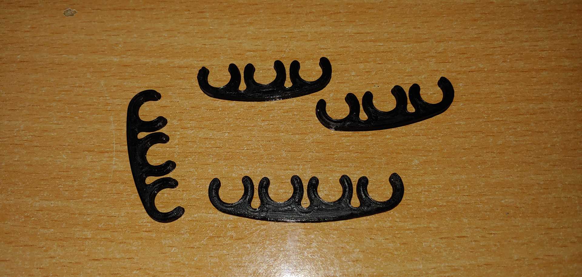

Okay, so I didn't make my own cables, but I did make these on my 3D printer. 😁

Report this Post09-24-2020 11:52 PM Click Here to See the Profile for theogreClick Here to visit theogre's HomePageSend a Private Message to theogreEdit/Delete MessageReply w/QuoteDirect Link to This Post
CLICK FOR FULL SIZE
What type filament?
Because many plastics don't last long exposed to high heat, ozone, oil/grease, etc in an engine bay even if you don't drive daily.

PLA. Ik know it's probably not going to last very long, mostly due to the heat and because PLA is a thermoplast. But it was nice having another excuse to use the 3D printer. 😁
