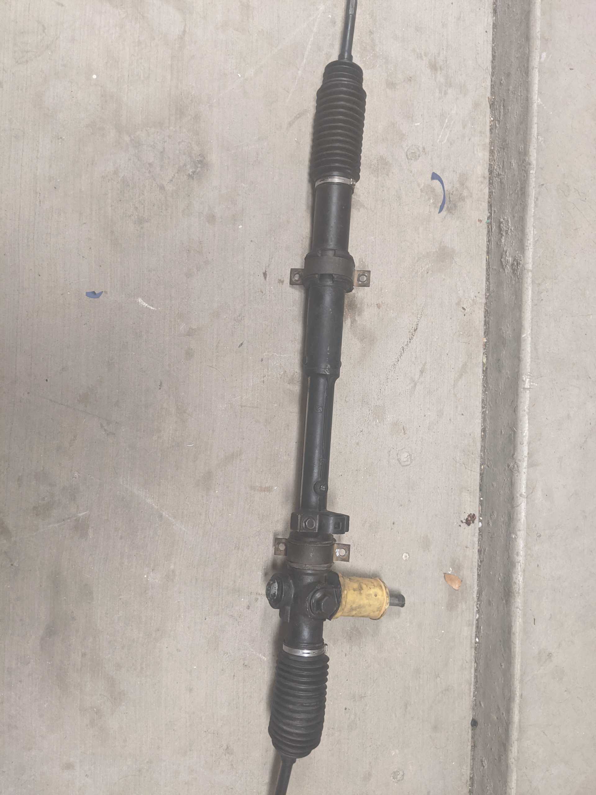

Ball joints aren't binding. Column spins freely. Problem is in the rack, but it looks recently replaced. Those boots don't last long in Arizona.

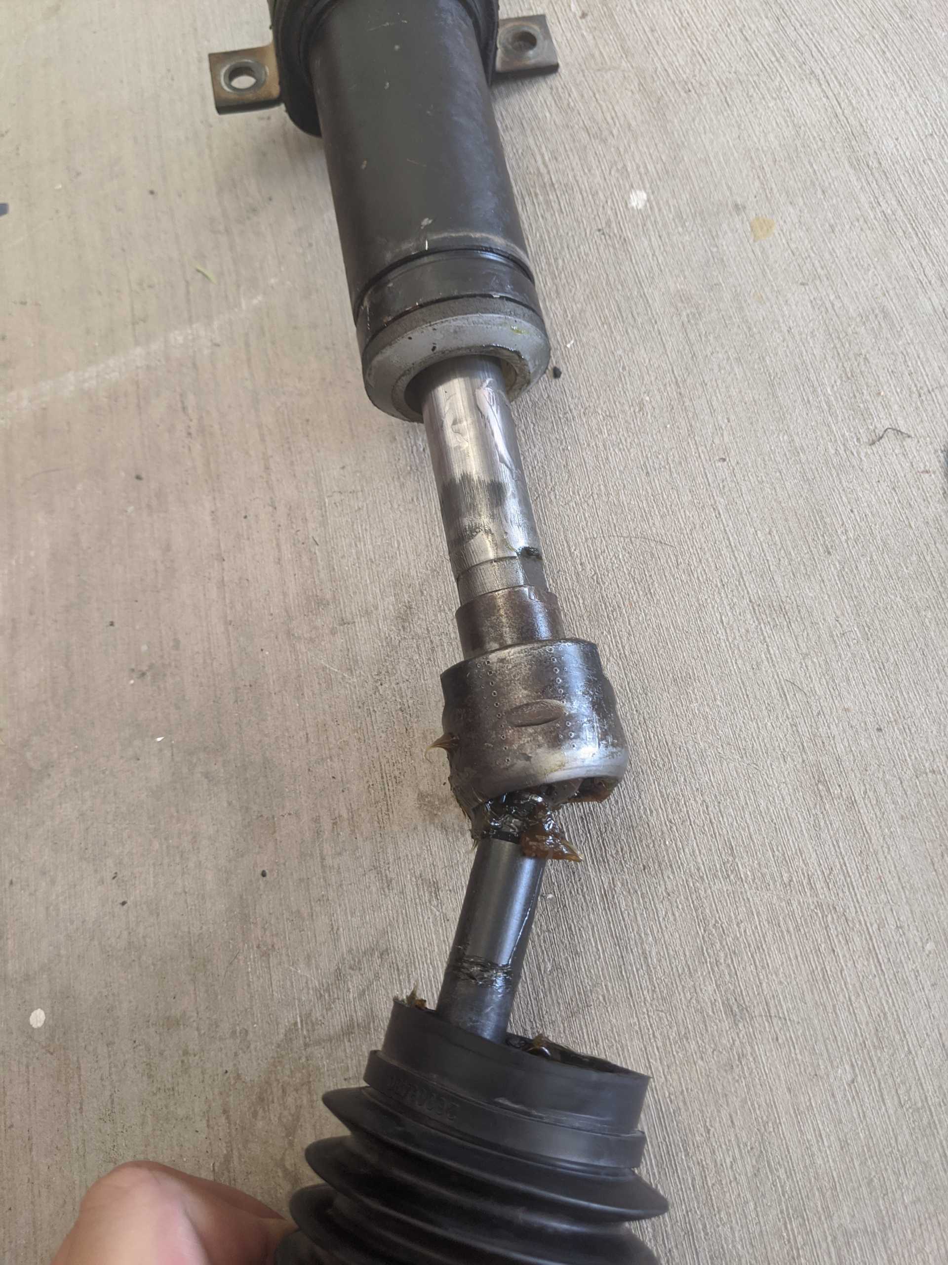

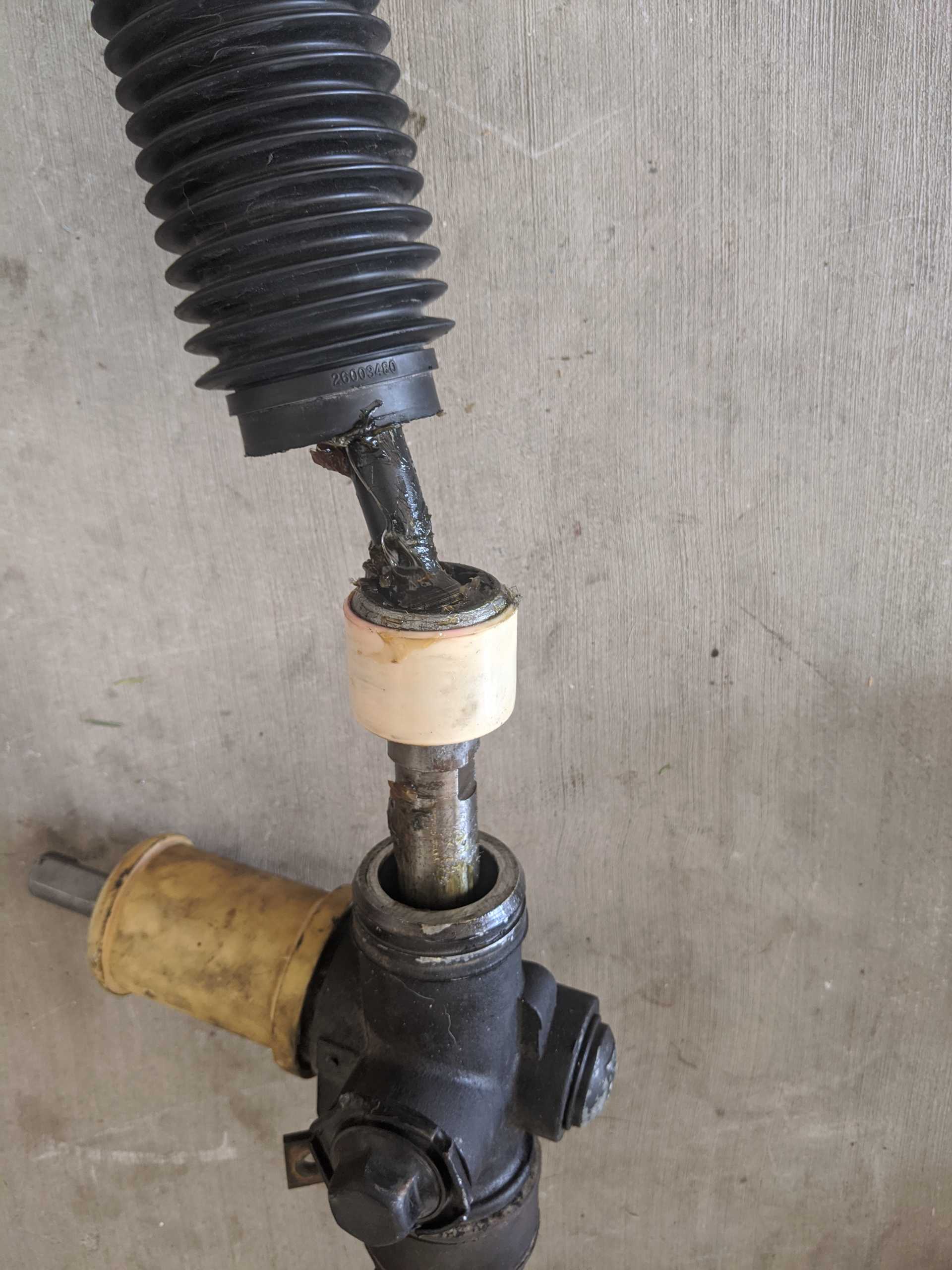

Indeed, the rack is fairly fresh. Everything looks very good on it. Sadly, someone, probably during installation, gashed the pinion seal and broke the needle bearing housing inside. It appears a chip was then ground up in the gears and I'm getting flakes of metal out while spraying brake clean through the pinion compartment.
With the pinion out, I cannot slide the rack by hand. I'm assuming this isn't normal and I need to remove the rack and throroughly clean the housing?
The rack should come through on the driver's end easily enough.
Likely old dried grease on the rack's shaft around the passenger end bushing.
Try spraying that area down with brake cleaner and may need a rubber hammer for persuasion.
