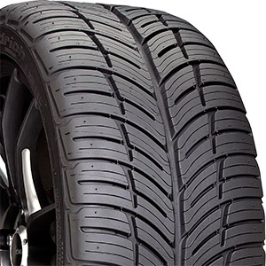

Well, all I can say is a couple months ago I put on a brand new set of 225/50-16 BFG G-Force Comp 2's, and they are easily the most impressive street tires I've ever had on a car. I can hardly believe the tremendous grip these tire have in real-world conditions, which is exactly what I was hoping. I specifically looked for a high-performance tire with a directional tread that would readily shed water and reduce the potential for hydroplaning in a light car with wide tires. Their price is a little higher than you were hoping, but they are still not expensive. W Speed rating (ie up to 168 mph). https://www.discounttire.co...104ca5f699d015e912d4

He's looking for 15" tyres.
The BFG G Force doesn't come less than 16".
You are going to be limited finding "good" griping tyres for 15" rims unless you go competition/semi-slicks like Toyo or Yokohama.

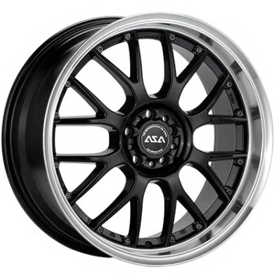

Good to know, thanks Jet! Does anyone make a reproduction wheel for these that's 16x7? Would prefer to keep the factory wheels, I'm a big fan of keeping the cosmetics exactly how the car was built to look.

I believe you asked for wheels in larger sizes that are similar to the Formula wheels....Here are three possibilities;
Konig Lace, 16 x 7, 17 lbs
Maxxim Chance, 16 x 7, 17 lbs
ASA AR1, 16 x 7, 19 lbs
[This message has been edited by cvxjet (edited 08-30-2020).]
