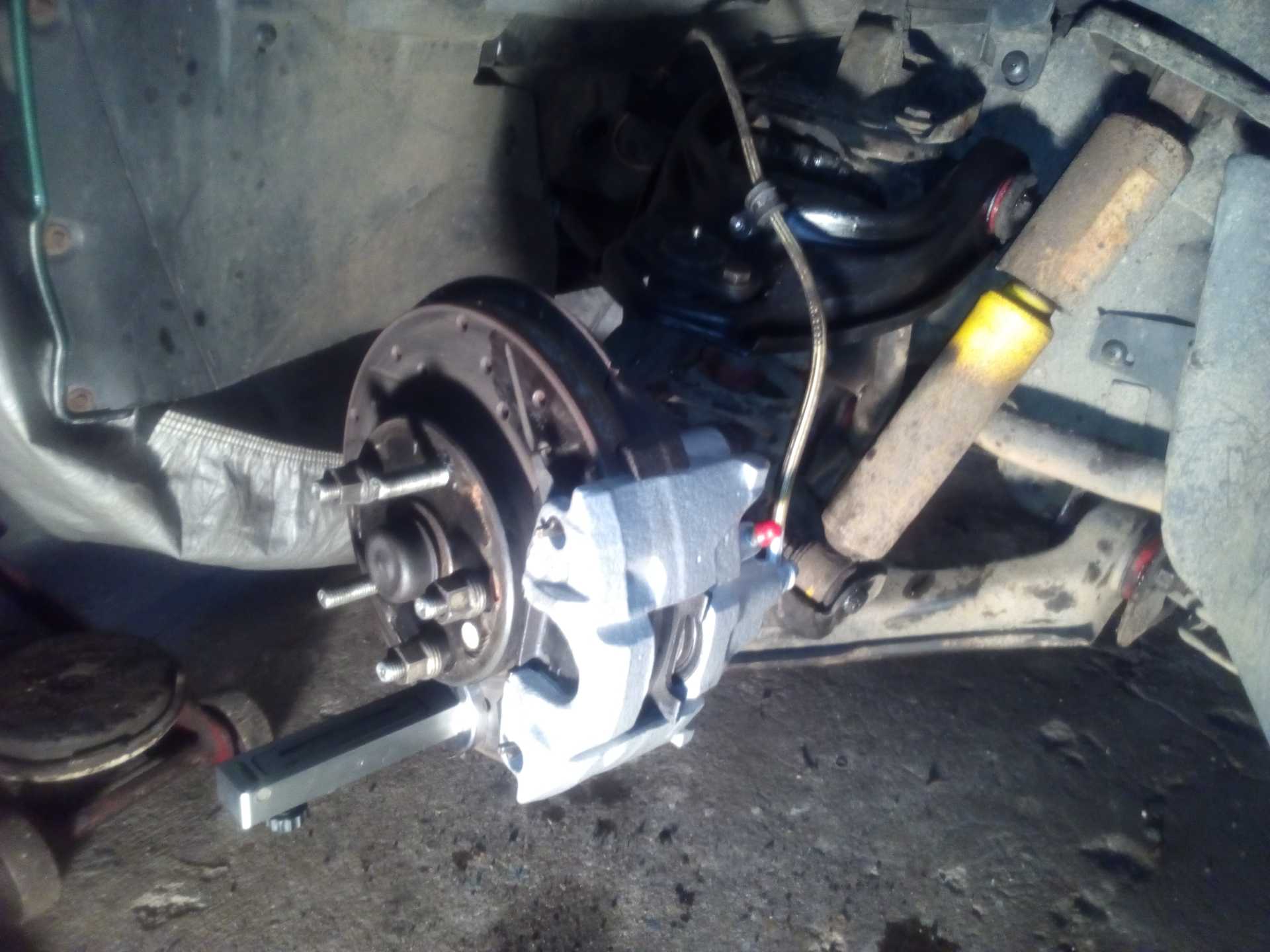

Hi, this is always an eternal debate at the track!
My research says slots up and forward (leading) with the direction of rotation.
As in this pic:
Most hardcore racers agree, but then the rich boys with their Porsches and BMWs show that the factory put the discs in the other direction.
I say that they have such effecient brakes that the factory put the discs that way for looks even though the racing teams turn them arround when the cars are really exploited!
