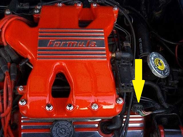

If we're talking a fuel problem, maybe some water got into the fuel injection harness connector under the MAP.
See in picture below. The one on my 87 GT is a wide flat connector unlike the one in this pic.
The injectors run in TWO banks and there are TWO fuses in the fuse box (one for each bank, can't hurt to put new ones in).
Thanks, will check that out tomorrow.

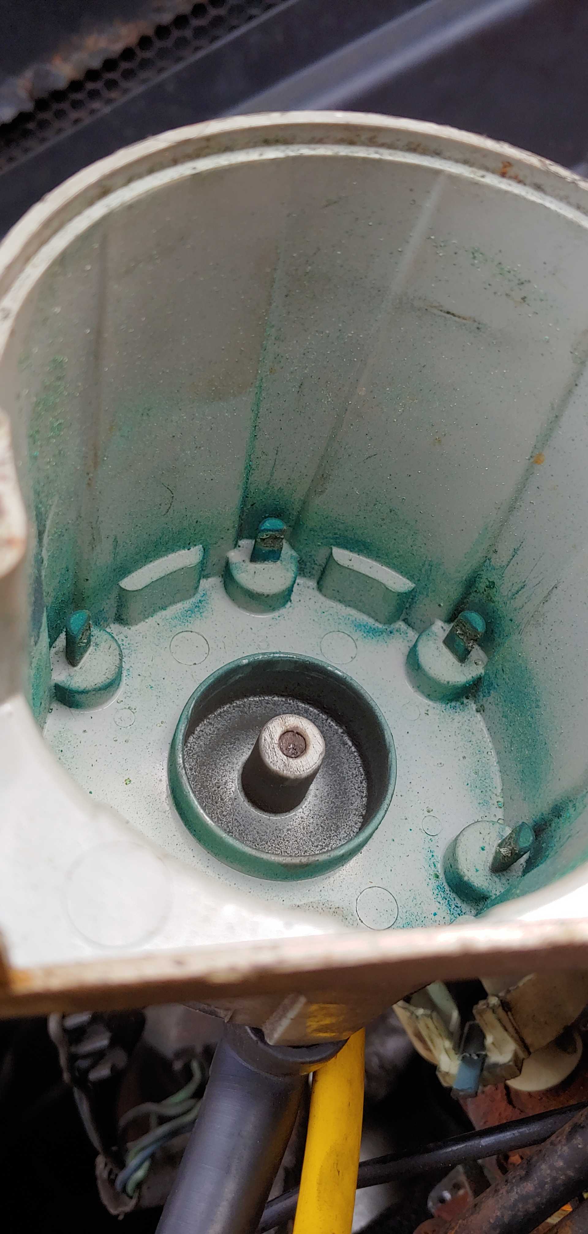

I had a look inside the distributor cap and saw this:
I'm not sure if you can see it, but the pin in the middle is actually recessed so I'm pretty sure it does not make contact with the rotor arm.
Could that cause the problem?

You could try cleaning the perimeter posts - they look a little worn... & get the dust & debris out.
I've done that many times in the last 36 years to eliminate mis-fire issues. It frequently delayed replacing the cap for months/years.
