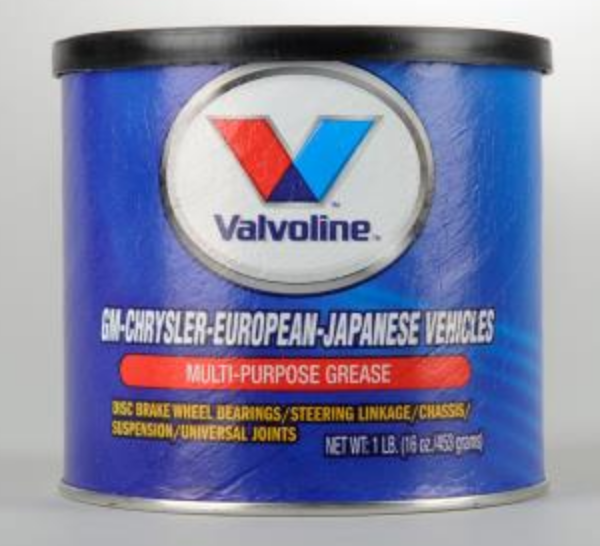

The grease I always use specifically says 'wheel bearings' on the can or tube, and is rated to 400 F, so you might be fine, what did you use?
I usually use this or Lucas Red 'n Tacky
If you end up re-doing it, a bearing packer and a grease gun would flush out the old grease.

Bit late to the game here, and I hate to say it, but make sure you get one that says DISC BRAKE wheel bearing grease. Lots of the GP stuff is only rated for *non*-disc (ie drum) at a lower temperature, and will break down at higher temps which is bad juju.
