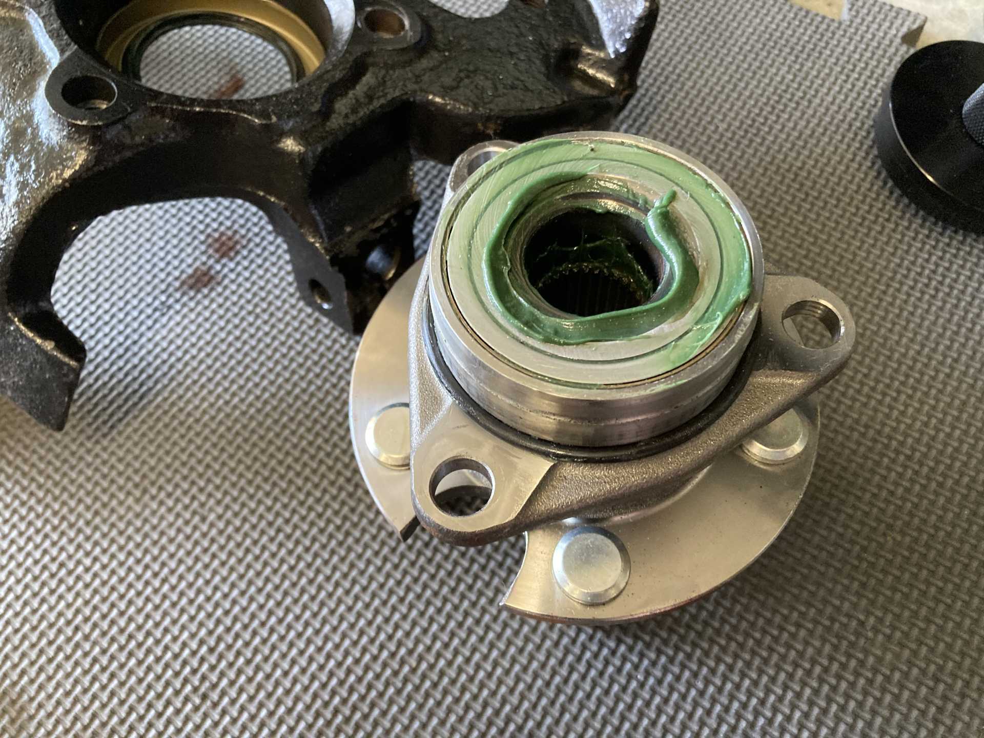

I'll see if I can find a picture, but there's a really large one that goes around the larger mass of the axle... (around the smaller circumference from where the tone ring attaches). And of course, you have one at the front as well. You're even supposed to pack grease around both sides of the bearing to help seal it from water. A lot of people leave them out, but it's meant to prevent water intrusion which will prematurely cause the hub to fail.
Ok, not the best pictures... but here's what I took ... after I did it wrong, and then had to take everything back apart, order them, and have my daughter put them back again...
Again, it's not the end of the world if you didn't install one. The bearings aren't exactly sealed from the elements, and so you risk getting water and road grime in there. The seal on both sides is meant to ensure no water intrusion.
Here's a picture of it installed with the axle in... the steering knuckle hasn't been mated (yet) to the McPherson strut in this picture, so there's a gap... but it shows where it is, and where it mates to the axle.
There's also a rubber O-Ring that's supposed to go around the wheel hub too, which is also meant to help create the seal between the hub and the steering knuckle. And of course, you have a seal on the front too which is made up of the combination of the axle w/ grease, and the big washer that goes behind the nut.
