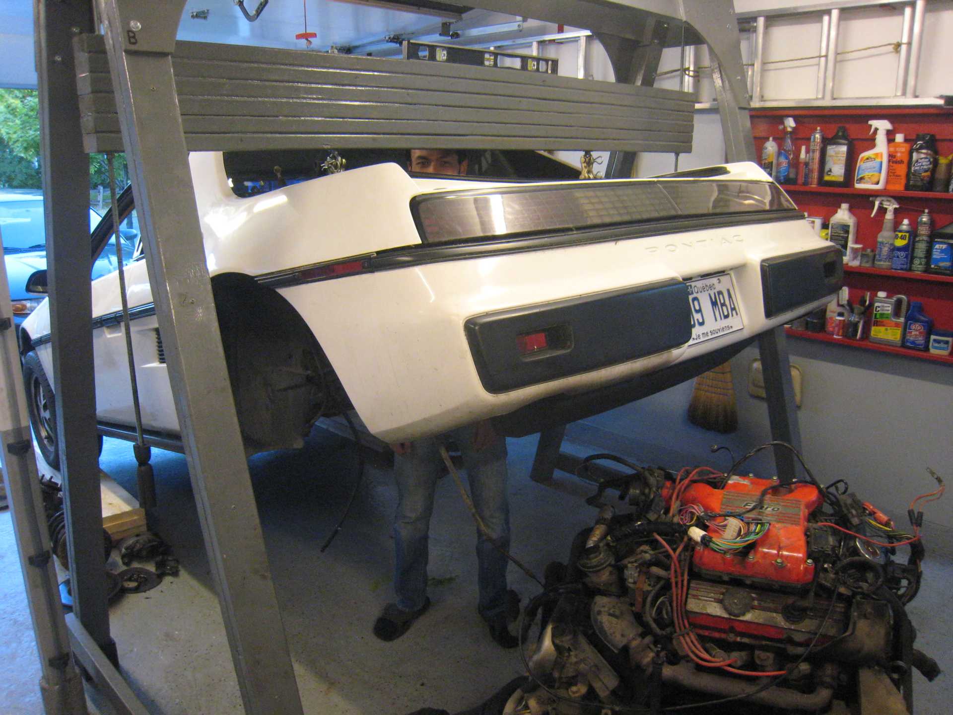

Lifting using wood might work but its risky and the pros never go that route.
Wood is risky now?
I've never actually removed a front crossmember from a Fiero, so I want to see what's the best way to do it.
Depending on how much span you are expecting between the jackstands, if the span is too much you may overstress the beam.
6x6 would be more conservative.

Originally posted by dremu:
Speaking of engineering analysis, I wonder if you didn't actually do some for this. Is that horizontal piece a bunch of 2x4's stacked, or 2x2s?
Also, any particular reason why the A-frame looks like two 2x4s, vs using a single 4x4?
Kinda wish I'd thought of that a while back for some work I was doing ... and wood's cheaper than steel...
-- A
Considering that I entrusted my life to this setup (with zero backups), I did take the time to analyse things where applicable.
The horizontal piece is a stack of six 2x4s glued together.
My stacked mega-beam: section modulus 47.2 in3 (the bigger this is, the stronger it is in bending)
4x4: 7.15 in3
6x6: 27.7 in3
I'm not saying that a 4x4 won't do the job, but it's not remotely in the same league as the solution I selected for myself.
For the A-frames, two 2x4s turned out cheaper than one 4x4, so that's what I did. Also, the thinner lumber was easier to cut with the chop saw.

As for the picture of the railroad trestle, yes they sometimes use wood but those are specially cut 12 x 15 beams. At professional shops you never see wood used to support a car? The OP is free to do it his way but I would recommend going with what the pros use....steel.
Professional auto repair shops are in the business of repairing many different cars... hence they drop the cash on an off-the-shelf lift, because they don't want to waste time figuring out how to lift cars.
The Saturday mechanic at home has more time than money, and maybe just one car to lift, so the solution space is different.

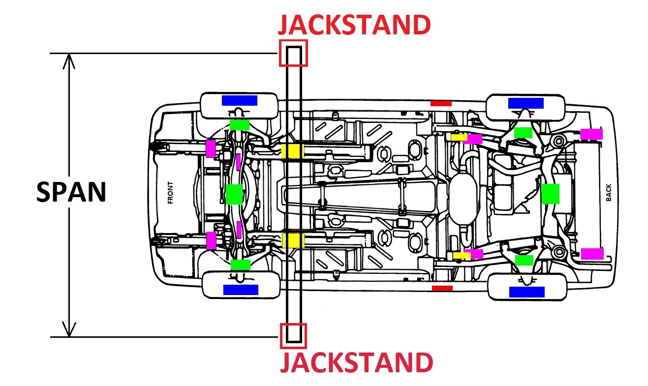

Larry, to make sure we understand what you want to do, does this diagram accurately represent what you have in mind:

Report this Post07-24-2020 02:05 PM Click Here to See the Profile for imacflierSend a Private Message to imacflierEdit/Delete MessageReply w/QuoteDirect Link to This Post
pmbrunelle
Yes! That is EXACTLY what I intend....with the rear tires on a ramp.

I guess you want to put the widest flat face against the bottom of the car? Too small... what else do you have laying around? Square tubes maybe?

Report this Post07-25-2020 12:49 AM Click Here to See the Profile for pmbrunelleSend a Private Message to pmbrunelleEdit/Delete MessageReply w/QuoteDirect Link to This Post
Usually the 4x4 in the rear is touching the floorpan for most of its length, with the spaceframe directly above the jack's lifting pad. In this case, the supports are off to the sides, and not directly underneath the spaceframe. Therefore, I feel that the two situations are not comparable, so we cannot use our experience with one situation and apply it here. Also I am a bit conservative with my suggestions because I do not want to be responsible for giving a bad recommendation resulting in death/injury.
I will look into the suggestion for a steel piece tomorrow. It is not the kind of exercise I want to screw up doing late at night.

Report this Post07-25-2020 11:46 PM Click Here to See the Profile for pmbrunelleSend a Private Message to pmbrunelleEdit/Delete MessageReply w/QuoteDirect Link to This Post
pmbrunelle
4661 posts
Member since Sep 2008
For steel, I suggest a 4" square tube, 1/4" wall.
Maximum span: 90"
A bit of head-scratching will be required to figure what how the beam should be supported by the jackstand (or other support).
You may need to weld something to the bottom of the beam to make sure it doesn't slip on the jackstand.
