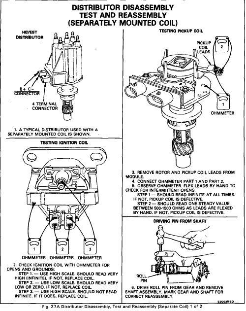

Thank you, that document is perfect. I removed my ignition coil and tested it according to those instructions. Step 1 and step 2 check out perfectly. Step 3 measures 4.73k. Is there a range this should fall into? Not equal to "open/infinite" leaves quite a few possibilities. The only ones I have to compare to are others on Youtube. One measured 8.8k and was deemed good while another was 3.7k and deemed bad. I'm guessing mine is bad being closer to 3.7k than 8.8k but wonder how widely it varies. If it matters, mine is an MSD ignition coil from the previous owner. Thanks,

Got online last night to buy new ignition coil and found the specs for the ignition I currently have. (MSD 8226) It says the secondary resistance is 4.8k... so now I'm not so sure the coil is bad.
