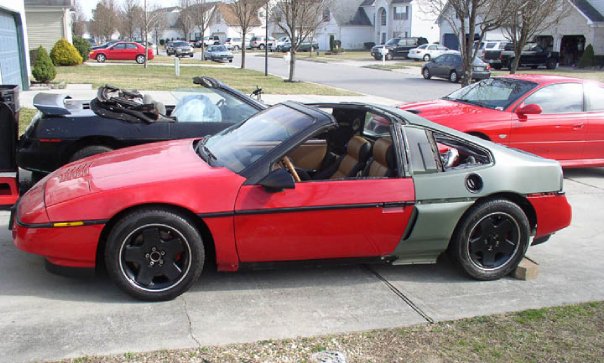

Bla.. bla... bla... you all make it sound like is so freaking difficult. Its not, just do it and don't listen to all this crap. Best bet is to find someone who wants to go from a coupe to a GT fastback rear clip. Put the two cars next to each other and start swaping stuff. Lots of folks want to put the fastback clip on their coupe, not many want to go the other way. Put the word out and you may get lucky. May even find someone with the same color car as yours. pulling/replacing body panels is a snap. hell, i've known a few guys that have changed the color of their car by just swapping the body panels w/ another color. Super easy.
I put a fastback clip on my coupe and as long as you have all the parts its a weekend job. The tail lights was one pin, one pin had to be moved from one spot to another. I don't remember which one but google it and you'll get your answer. Its a 3 minute job.
pic of mine in the process of the swap.
