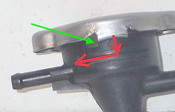

I noticed I have a leak from my radiator cap when the engine is hot. I literally have a small puddle on the ground after the car sits for a few hours after shutdown. I have a SPECTRA PREMIUM CU828 replacement radiator if that says something. The cap seems kind of loose when installed. I have three different ones and they all do the same thing. I read in a thread before that you need to put the cap on "two clicks"(?).
https://www.fiero.nl/forum/A...120111-2-112196.html
Could this be my problem? Is just turning the cap on clockwise not enough (green line)? Should I push it down so the ears turn over the "stops" and they stay there so it seals tighter (red line)?

Yes, you have to push down to clear the first stop and keep turning. Nice diagram by the way!

Thanks I found it on the internet and just drew those two lines so I can't take credit for that.
So I guess my new radiator trolled me because there's no other stop after that point. Meaning if I continue to "screw on" the cap it'll just come off since there's no more lip to hold onto. And I didn't remember how the original one went on... Hope this fixes my problem, will know tomorrow when I'll drive the car. Thanks.

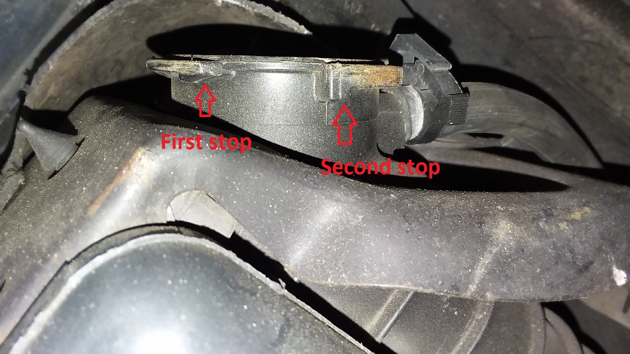

If you look at the picture in my first post I guess you should see it. If the cap lip is already under the stop after the red line and you continue to turn it clockwise it'll just fall out like it was never even screwed on. I wonder if that's just a design thing of the new radiator or am I missing a piece there or I don't know...

Here's the neck on my radiator, but I don't know if it is original or not. The first stop requires the 'push down' and the second is just at the end of the cam. Are you continuing to 'push down' after stop 1? If so that might allow one to go beyond stop 2.
Exactly. I didn't notice a "first stop" on my radiator or if there is one it doesn't need any pushing down of the cap. All my different caps screw one freely. So what I did was actually put the rad cap lip over the second stop on your photo. Before that the cap kind of wobbles with very little force. Maybe I have to bend my lips a little so they seal tighter?
EDIT: All right I see where I messed up. The first diagram is wrong. Here's an updated one and the blue area is the stop I meant to point out. Sorry for that. So the cap should seal before that stop?
That is the second stop.
Yes, sorry for that, I edited my post above, the diagram in the first post points to the wrong stop. My rad caps go over that 2nd stop easily with some hand pressure on it. If it turns out it seals well with the lip over the second stop can I run the car that way? Or is there some bending or other risks involved?

Yes,
Rad Tube has 2 spots for the cap.
The 2nd step w/ final hard stop is Full Close is to operate the system.
The 1st step w/ a small stop is to release pressure when trying to remove it w/o blowing the cap off. This small stop may not work well for several reasons and can turn the cap complete off and have hot coolant burn you.
