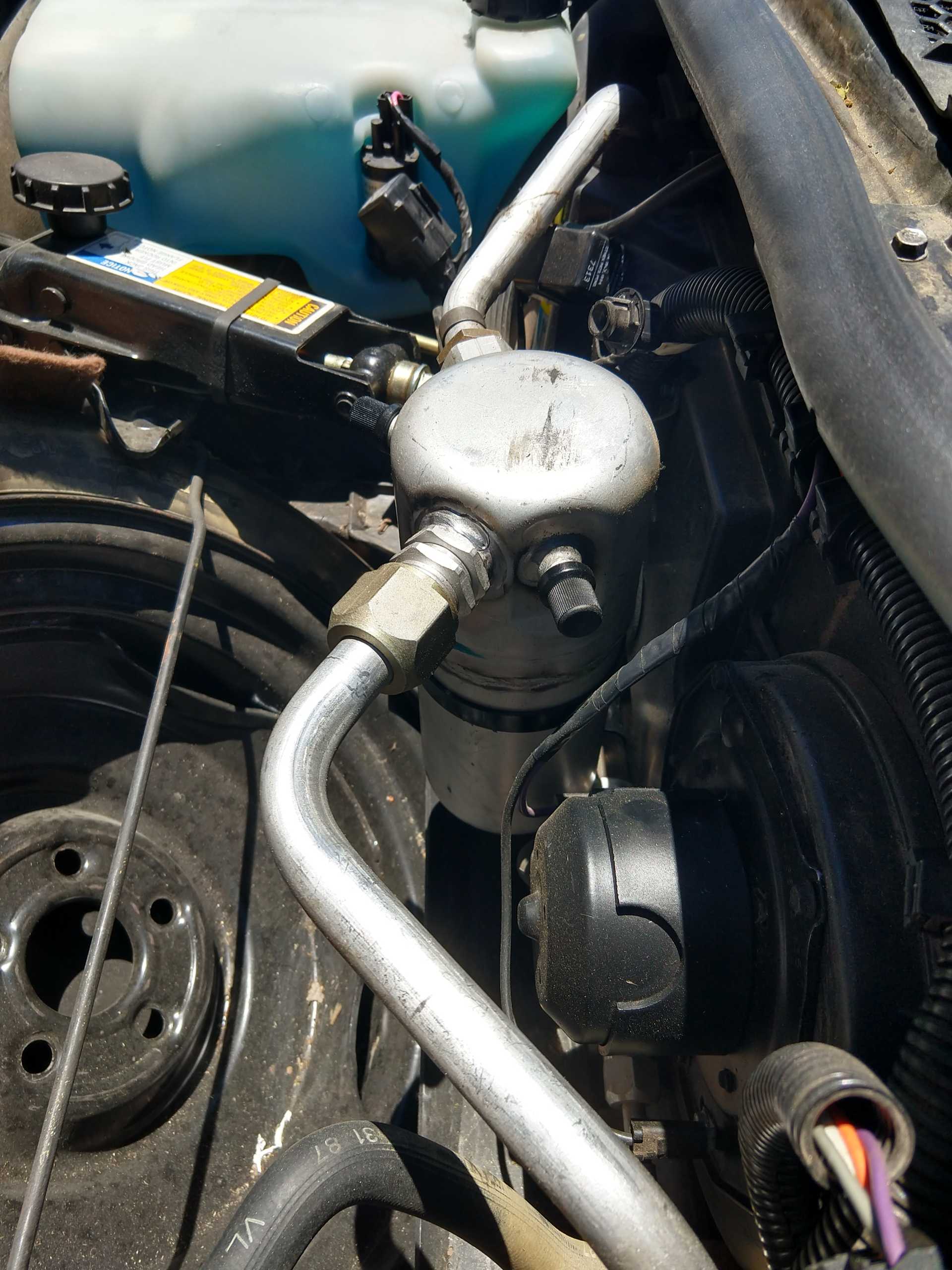

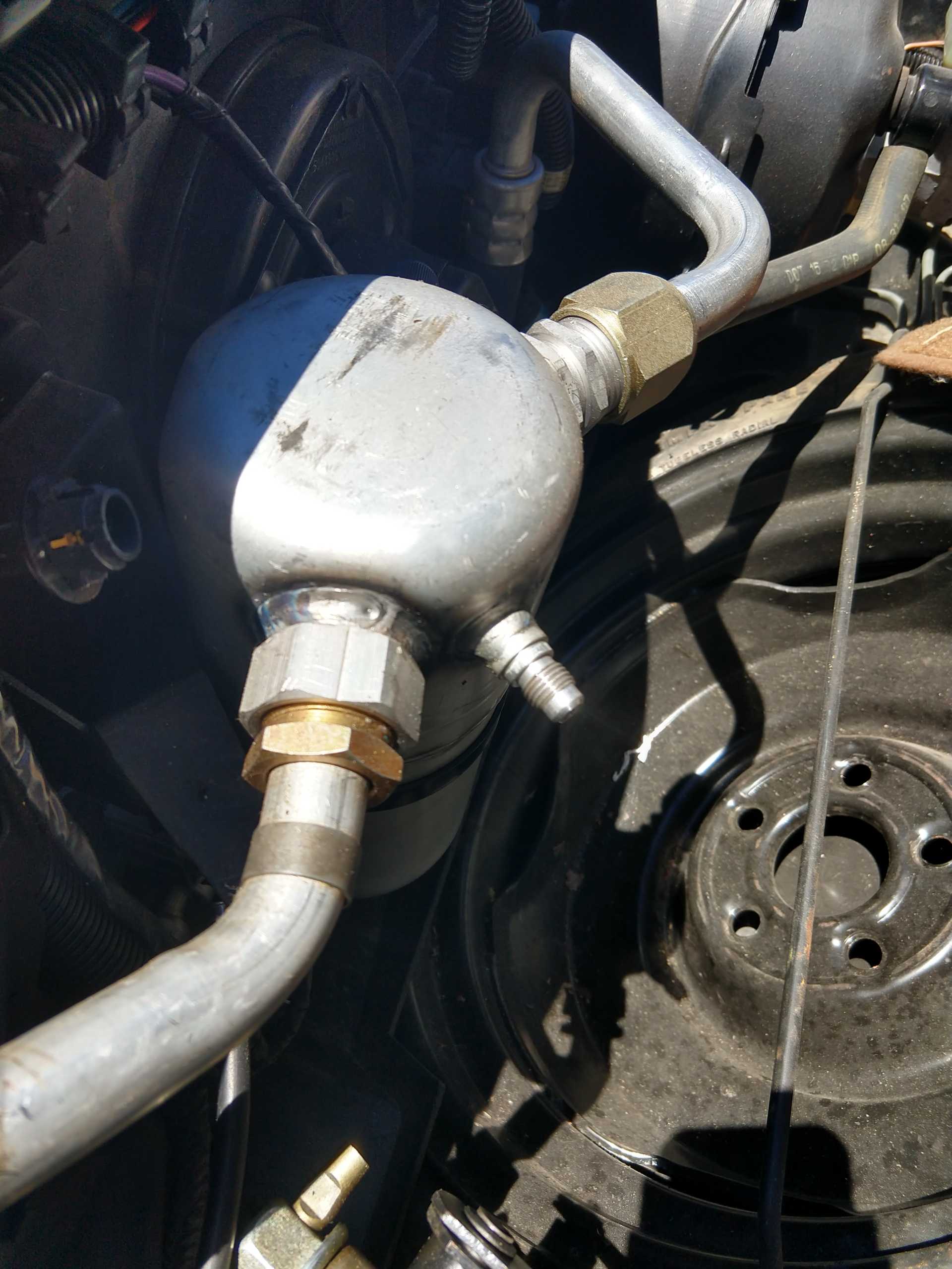

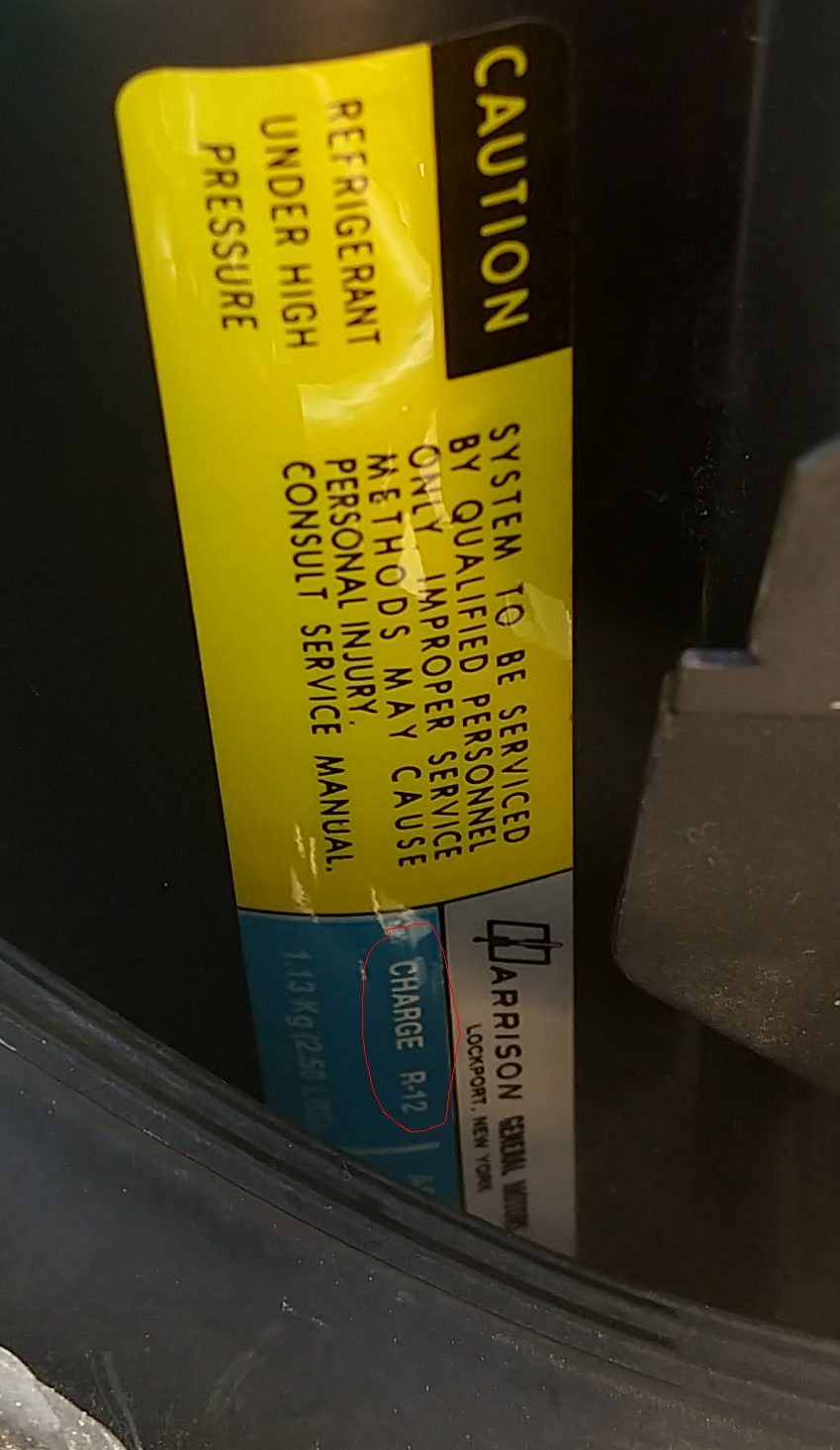

Sledgehammer's question seemes similar to mine, so I'm going to post here. When I bought my 1988 4cyl Fiero the previous owner, who'd had it for about 18 months, said that the A/C didn't work. He gave no specifics beyond that. Here's what I've learned:
1) When turned on, the system does not cool the interior of the car. So, it wasn't like the previous owner didn't know where the A/C on/off switch was or anything. I was kind of hoping for that, but I guess I was a little optimistic.
2) The compressor appears to kick in and its clutch appears to function. When I turn on/off the A/C I can hear the clutch kick in. Also, my rev's change indicating that the clutch is putting a load on the system.
3) The system appears to pressurize at least a little. It was probably wrong, but I let a little air/gas out through the schrader valve at the top of the accumulator and I got an encouraging hiss.
Here's what I don't know:
1) Is this system set up for R12? How can I be sure? The accumulator has, what I've been led to believe are R12 type fittings (Shrader valves) and there's a sticker with "R-12" on it:
2) If the system is set up for R-12, what else do I need to know in order to make a decision regarding topping off with R12 or going to R134a? After 32 years is it possible that the system will still work with just a charge of R-12? I know for a fact that the car spent many years in Arizona, so it is very likely it's A/C got a regular workout.
Thanks again!

1. Yes, that system is still set up for R-12, the ports don't have the conversion fittings and no sign of a conversion sticker.
2. You need to determine if the system has any charge. You can press a screwdriver tip on one of the schrader valves briefly and see if anything comes out, if there is pressure, you'll need a gauge set to determine the state of charge.

So, this comment and comparing prices for R-12 vs R-134a has kind of convinced me to retrofit. I've also done some looking around to see what's involved in a compressor retrofit and it looks do-able, assuming I can find a way to acquire/borrow some of the specialized tools.
So, my plan right now is the following:
1) Pump out any remaining R-12 in the system.
2) Get a "no A/C" belt, and remove the compressor, and the hoses to it, plugging them and storing them somewhere clean and dry. Also, plug the system so it stays as clean as it is prior to flushing it.
3) Refurbish the compressor as time permits. I'll try to follow this youtube video: "Delphi Harrison V5 A/C Compressor - Full Teardown and Reseal"
4) When the compressor is ready.. or the refurbish failed and I get a new compressor, install, flush everything, vacuum test, replace other gaskets, etc.
5) Charge with R134a.
6) Chill
Does anyone have tips/advice regarding getting the loan of specialized pullers, tools, etc?
