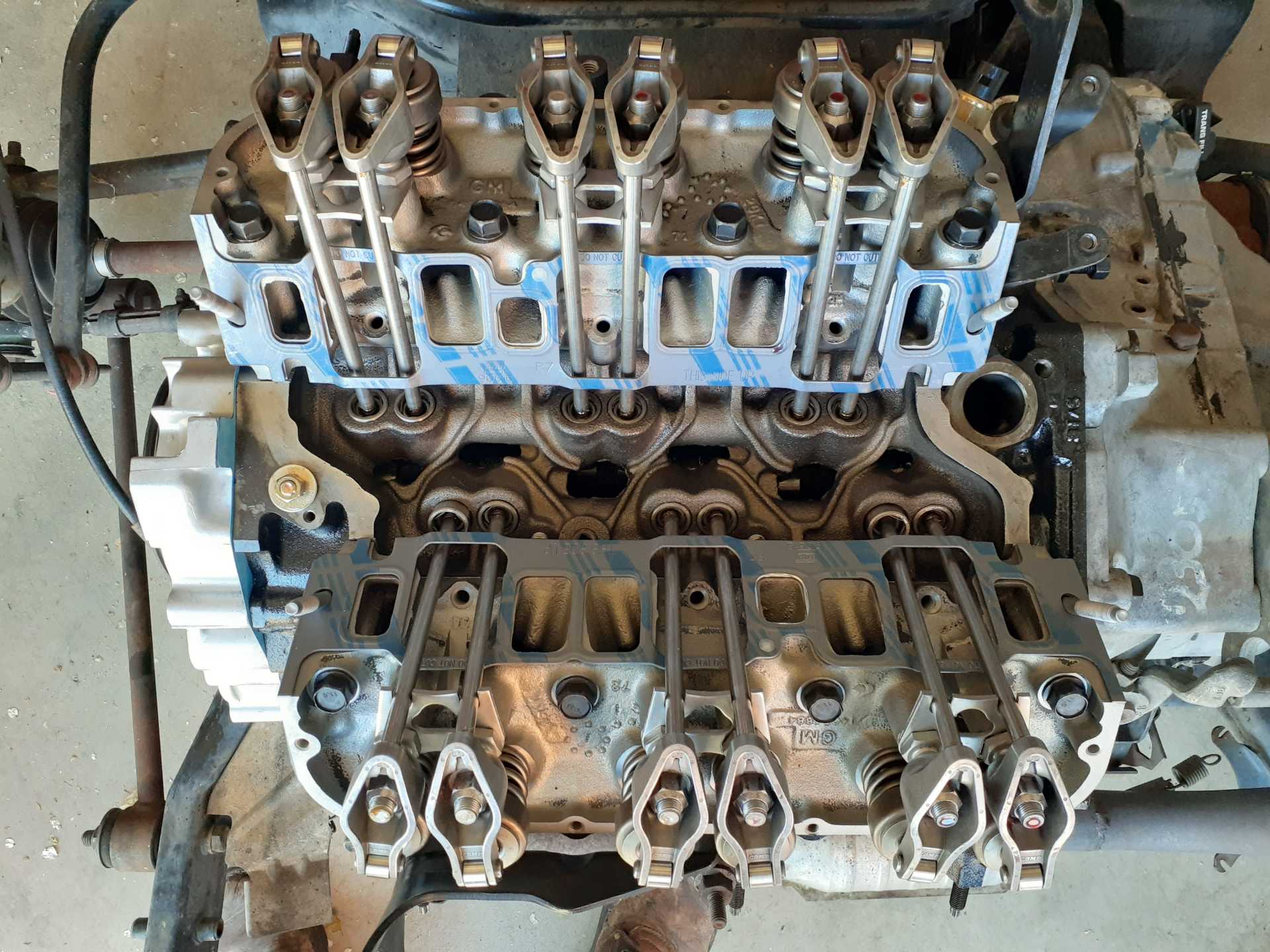

Well I have the intake off. And I'm using a dial indicator with an extension. The extension goes on the piston/plunger in the lifter. Set indicator to zero and tighten to desired preload. I chose .060, 3/4 turn. My engine builder suggest .050. I might contact the seller (ARI?) and see what they say.

Can you take a picture of what you're doing? Perhaps I'm the only one, but I've got no idea what you're describing.

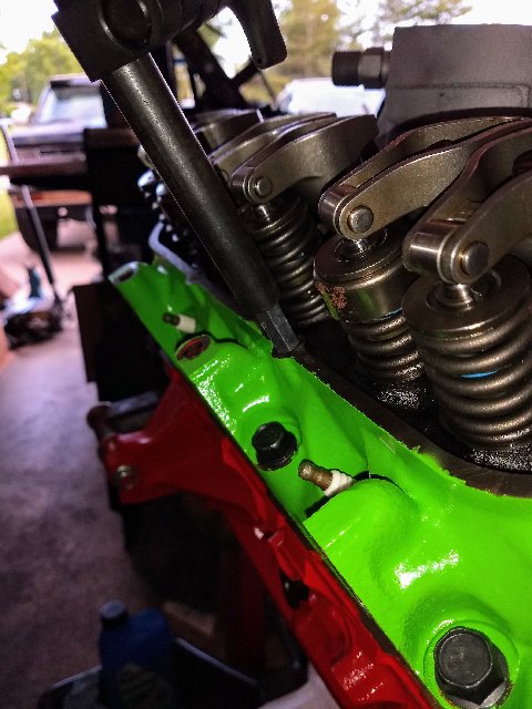

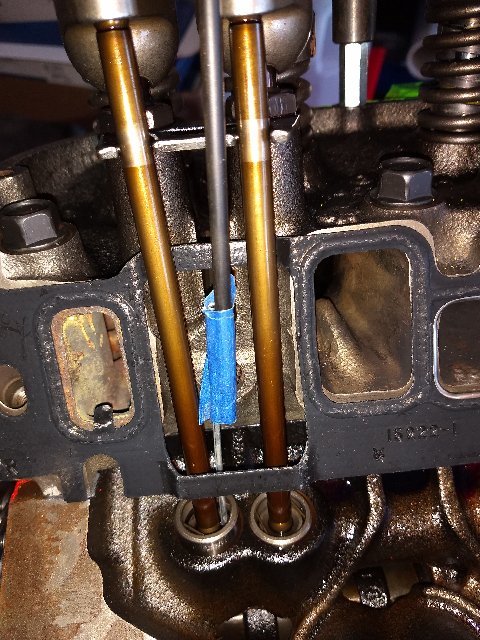

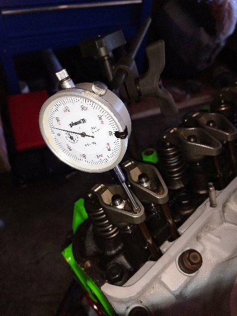

Here's some pictures of how I adjust my valves. I'm actually showing 2 methods same principal. I had to retap an althread coupling to a metric size to go in to the valve cover bolt hole. Just set the dial to zero and turn till the needle starts moving, being careful not to push down on the fulcrum (?) half round washer thing under the nut. Set to desired turns or thousanths of an inch. The compcam timing degree kit is where I got dial indicater from. I degreed the ARI cam and came out right on the money, .421/.444 llift.
This is actually for my s10. I think the intake is better than the fiero intake. The throats at bored to fit a 4.3 tbi which equals 60mm, runners are bigger and a whole lot shorter. Hope this helps someone.
