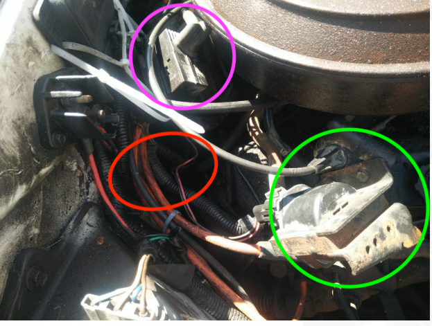

I have never had any problem finding the distributor mounting bolt- It is right at the base of the distributor.....But there are a lot of things in the way.
Here are some pictures to help........
[This message has been edited by cvxjet (edited 05-03-2020).]

Well, i figured out the timing. A friend loaned me his timing wrench but it was 9/16 and that is too small to fit on the 15mm bolt. SOOOOOOOO
i figured that Chevy didn't care about mechanics, but profitability, and if ya gotta pay at the dealer well, thats just more profit for chevy. So they put the distributor in the hardest spot to get to and in addition they put a bunch of crap around it (red circle) to make it impossible without removing the aforementioned crap. Well i decided to remove it once and for all and relocate the coil and some vacuum thingy. But first i had to get the bracket thingy out of the way.
A sawzall and a grinder made short work of that bugger. Gone and good riddance!
A shorty 15mm 12point box wrench did the trick on the bolt. The trick was to put the wrench UNDER the wire loom and use the loom to hold down the wrench so it wouldn't slip. About 12 turns of the wrench allowed the distributor to be moved COUNTERCLOCKWISE to advance the ignition. Still have to check with the light.
What to do about the all crap in the way? Well the coil, i turned around and bolted it to the unused cruise control hole on another bracket, (green circle) and the vacuum thingy i zip tied it to another thingy on the firewall (fuchia circle). Easy Peasy.
We move stuff around all the time on our Fiero swaps so why not on Charlie, my work truck? Hez gonna need a new distributor at some point if the good running 2.8 keeps going, so why not make it easy next time?
