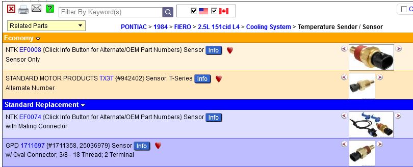

ECT in the Tstant tube for ECM HAS Changed w/ Metripak ends starting w/ 87 cars and no-one makes the old style one since.
For a short while after could get NOS old ones but still had old iffy plugs causing problems w/ replacement sensors.
NTK EF0074 have the sensor and pigtail but Don't use crap splices shown.
If you want other brands of sensors...
Just the pigtail is:
WVE 1P1006
FOUR SEASONS 37231
under Electrical-Connector > Temperature Sender / Sensor Connector (84 doesn't list FS one. Other years does.)
