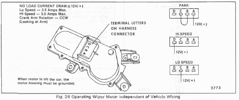

so next step is to test the wiper motor but i dont know where i can put +12 V to test te motor it self
can i put on any of the 4 connector that the wiper board clip on ( with the board remove of the car obviously)

Yes you can test just the motor... Pull cover and board off the motor.
Ground/neg to case.
+ to low or high speed pins where delay board connects to motor.
No Load Amps only applies w/ motor arm not connected to wiper trans etc.

so the motor works fine and i also test the pulse board and when the plug is connected to the board and i start the wiper at high there is 12 V on the outlet of the board on the pin for the high speed so ... board seem to provide volt to the motor but nothing happen
if i bypass the car connector and connec 12v power straight from the battery to the high pin inlet in the board the wiper start but really slow even at high ...
i dont know what it could be ? could that be the 12v comming from the wiper switch is to weak ?
