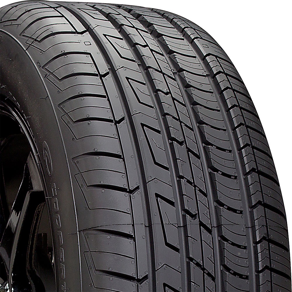

Cooper CS5 Ultra Touring (retaining stock sizing) at $90/tire

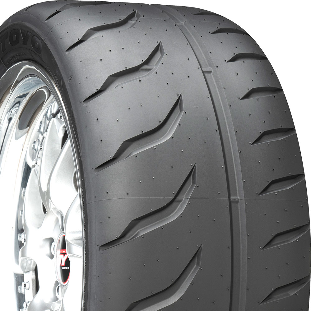

Toyo Proxes R888R (would have to move to 235/50s for the rear and 225/50s for the front, both are about 3.5% smaller than stock diameter) at about $170/tire

I have those Cooper CS5s on my daily driver 2006 Subaru Impreza for a few years now and they have been very good to me in all conditions. When my Firestones on my 88 wear out I would put them on my Fiero with no hesitation.

I use exactly those Toyo Proxes tyres on my car in exactly the same sizes.
Yes the ride is harsh (suspension mods as well).
Yes you can nail those corners at high speed without scrubing the front tyres or losing the back end (spinning out), in the dry.
No, you can't take the car out on a wet day! Not unless you like wheel spinning burnouts at each gear change and losing it totally on the same corner that you did so well at the day before when the sun was out!!
Saying that, I wouldn't put cheap "normal" tyres on my car any more. I like the precise feel that the Toyo's give.

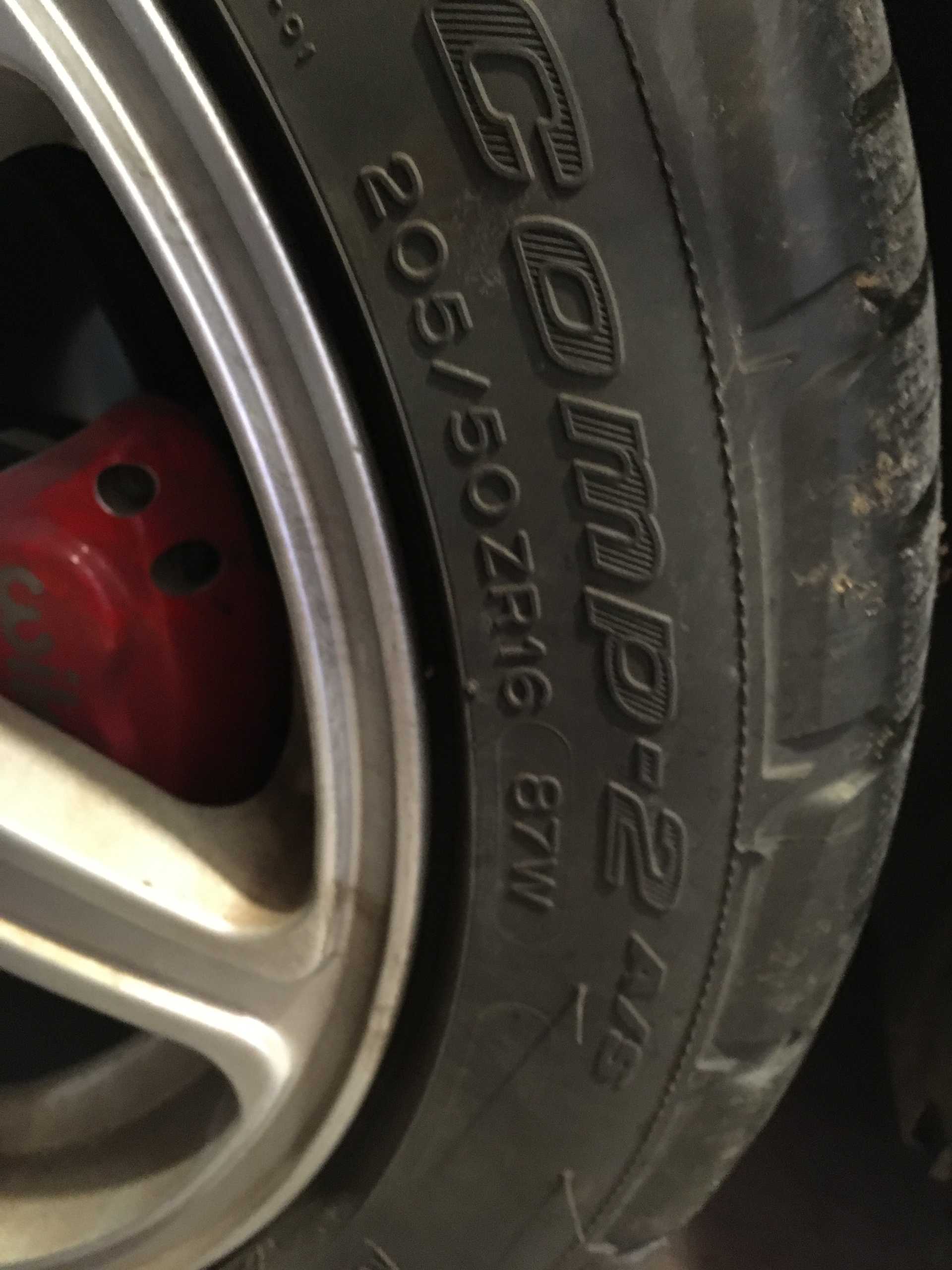

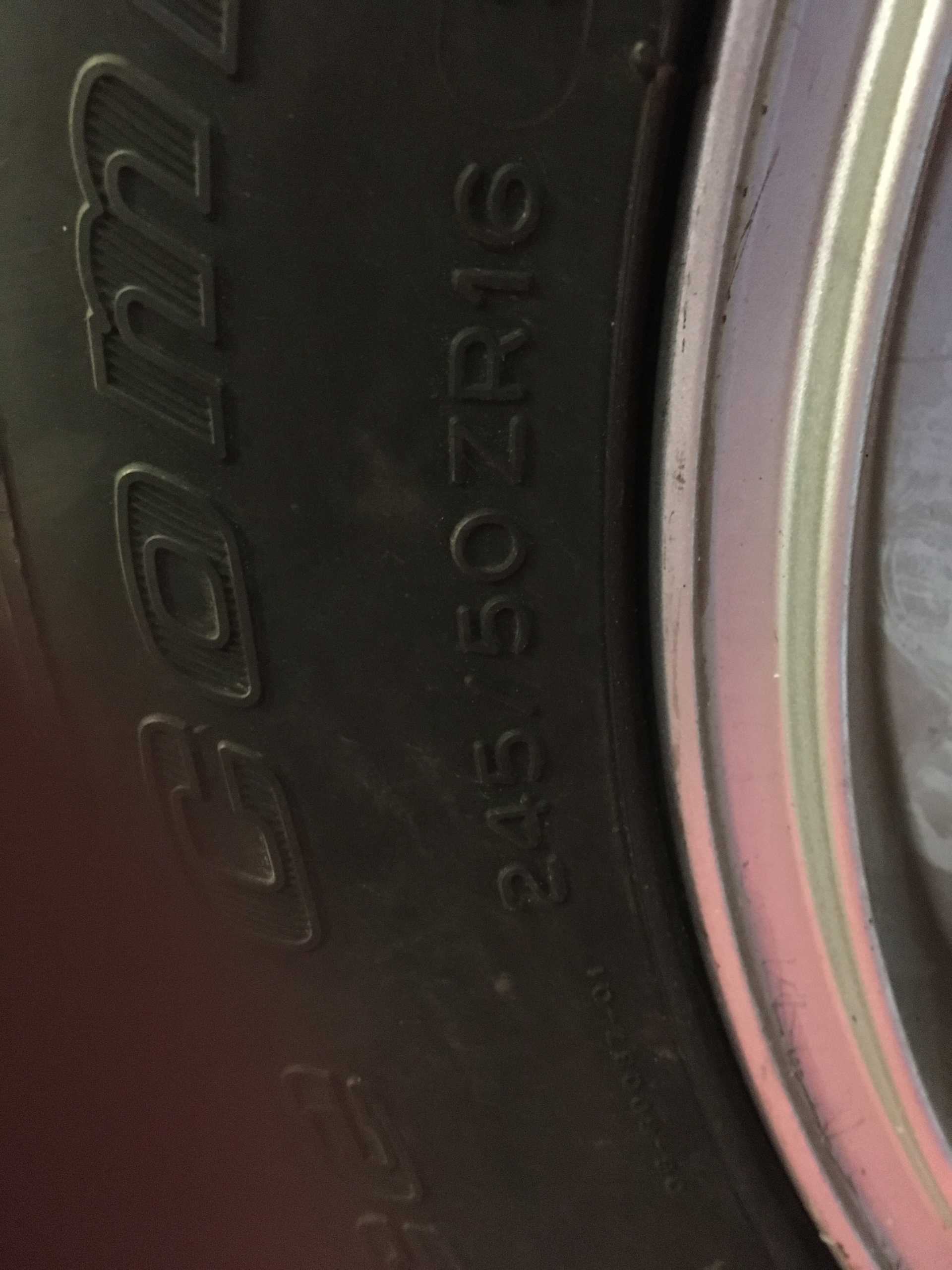

My old tires were high performance summer tires in the same sizes. Kumho Ecsta SP . They worked great when they were new, on the track and on the street. There was a gap between track days of about 7 years and as they got older they got rock hard. Howled on every corner last time out. But even aggressive driving on the street I could not get a peep out of them. I bought the tires above for occasional track day use and they are also an all season tire so I can still drive at lower temperatures. For the weight of my car and how it is set up I expect good things on the track but have not been there yet. On the street they are impressive and unexpectedly quiet.
I tried to get a 215/ 255 combo in the same tire but the 215 was not available in a 16" size. As you can see by todays photo at the bottom, no going for a drive today.

Toyo Proxes R888R and related are "Street legal" but have many problems.
Most are made for clean dry pavement regardless on whatever "Tread" to pass for DOT tires. Clean means no sand, dirt, leaves, grass, and more on the road or track. Dry means Dry same as NASCAR etc require Dry on their tracks or stop racing. Some Race Org's allow "Rain Tires" but still have problems if track is wet for medium to heavy rain.
IOW These tires are made to pass tracks requiring some classes to have DOT Tires. Not to be run on the Street and if done so will wear out fast and have other problems like hydroplaning very easy.
Cooper CS5 Ultra Touring and other "All season" "M+S Rated" tires work better to much better but can have problems driving in heavy rain or any snow/ice regardless on publish data/hype on the manufacturer sites.
