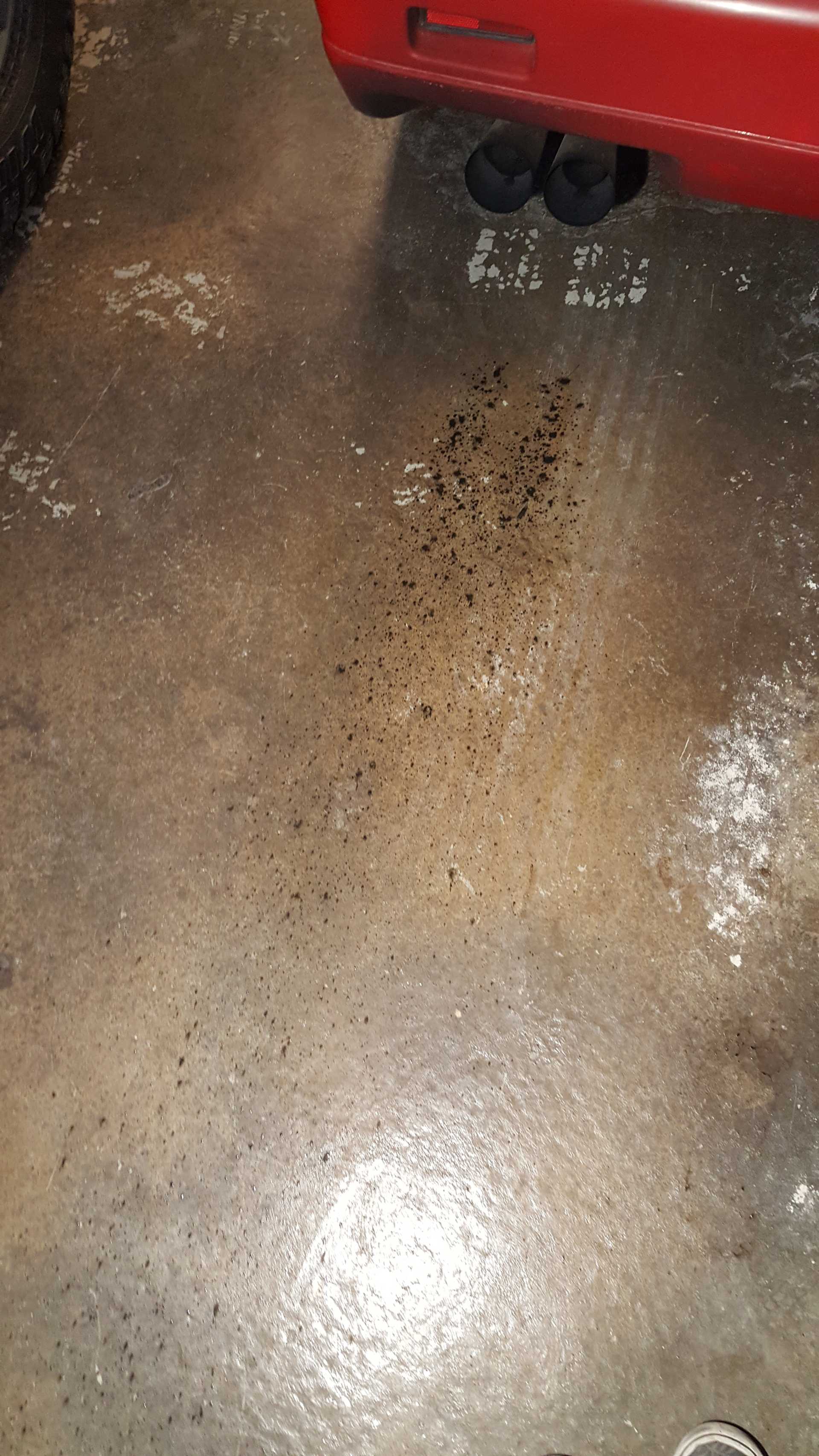

Also don't know if this would help but whenever I start the car it spews this out, cats gonna and it's still doing it?

Is that water, fuel, or oil?
I'd pull the plugs on the trunk side and see if they are fouled with soot. If they are then, it may be a fuel injection issue.
I'm 90% certain it's water, and I'll check those and the injectors tomorrow and let you guys know what I find, also I really appreciate the help with this, wouldn't be able to do it on my own😂
If it's water, chances are it's condensation . Does it happen every time the car is started or only after it's been sitting for a while and the car is cold? If it happens every time the car is started whether hot or cold then it could be serious. If only when it's cold, I'd guess it is condensation from the atmosphere
Every time car is started
If so, make sure to monitor the coolant level in the reservoir. If it continually drops, you may have a problem.

Originally posted by Patrick:
If so, make sure to monitor theycoolant level in the reservoir. If it continually drops, you may have a problem.
The Coolant level dosent drop, I've been checking the reservoir.

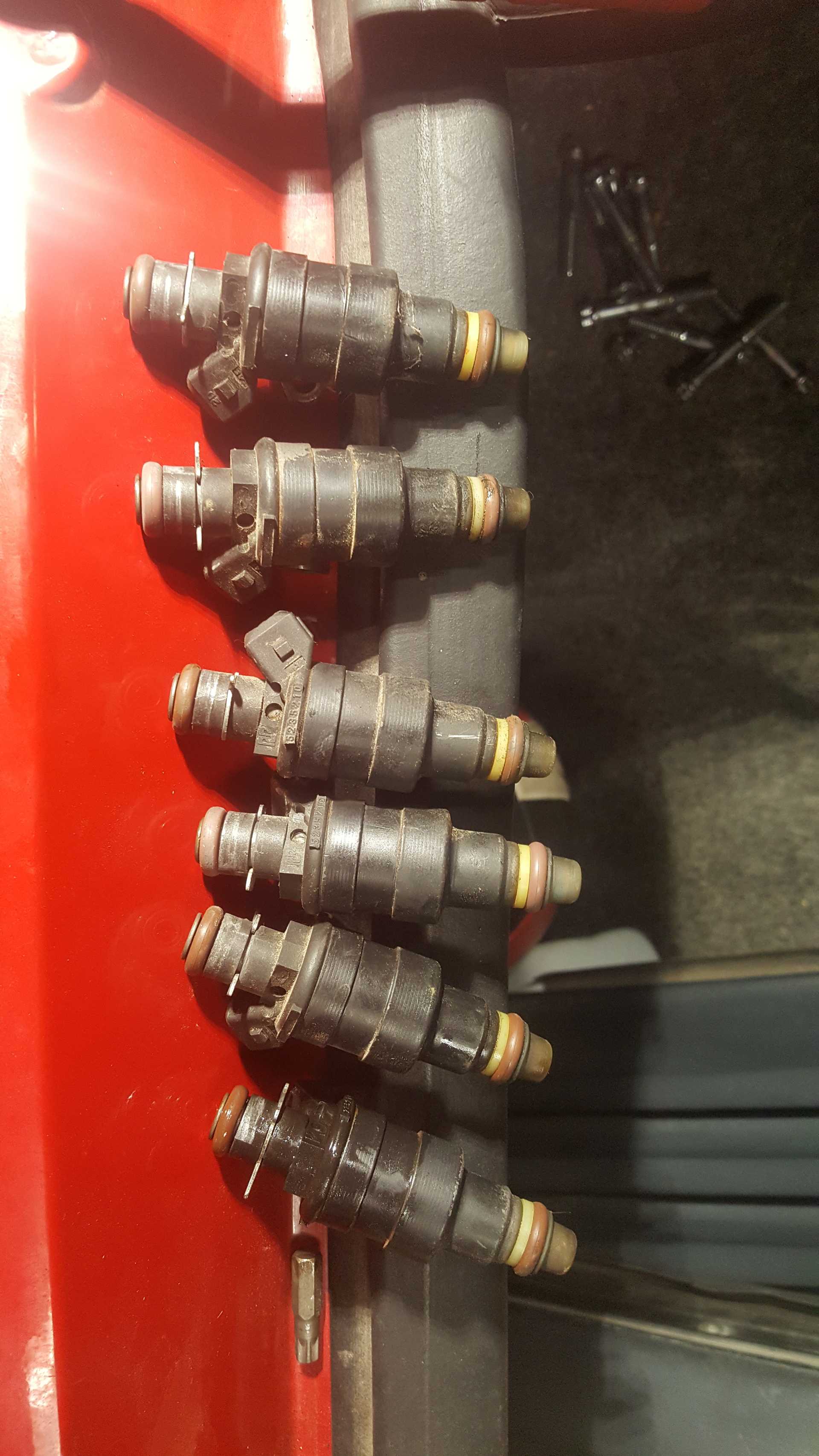

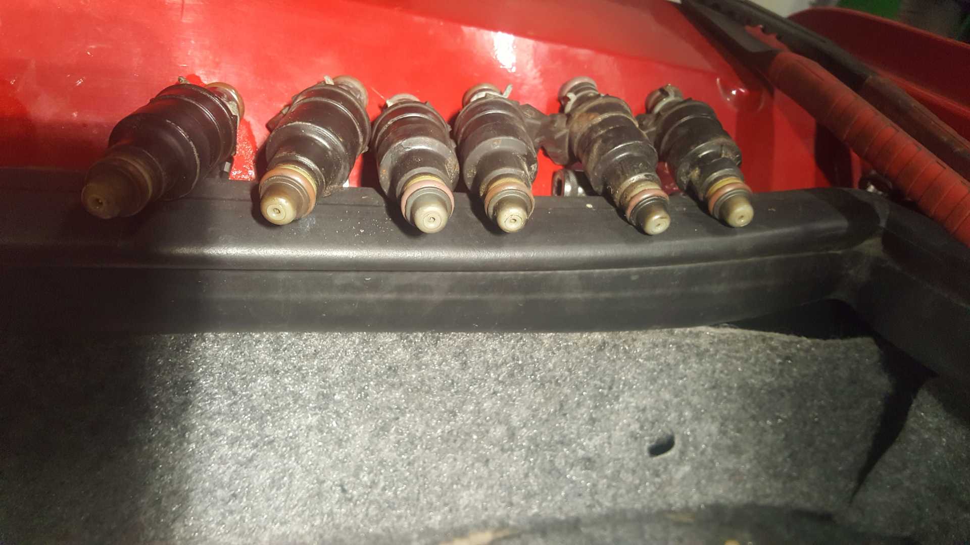

Alright here's the injectors in my opinion they don't look bad at all?
I'm not sure what looking at them is going to tell us.
Did you do the fuel pressure leak down test before you pulled them?

I thought I would pull them out first and make sure they didn't look like garbage since I've seen some preety bad ones that are stock that look super bad so I thought I'd check with that

While you have them out, check the resistance of each injector since they're now easily accessible. Maybe also use a battery to make sure each one "clicks". Details on doing this can be found online.

The water coming out the tailpipe is just vapour that condenses back in to water until the exhaust piping and muffler warm up. The black splatter marks are the water washing the carbon off the inside of the tailpipe. All fuel injected cars do this, newer cars just do not produce the black splatter marks as much.
Good to know it just seemed like quite a bit Coming out of it so just had me worried was all.
Checked them for resistance and for clicking good in both categories.

If the injectors are still out of the car....clean them or get them cleaned by a service. They are most likely good and should not be replaced because they are probably better than new ones.
There are tutorials on line if you want to clean them yourself.

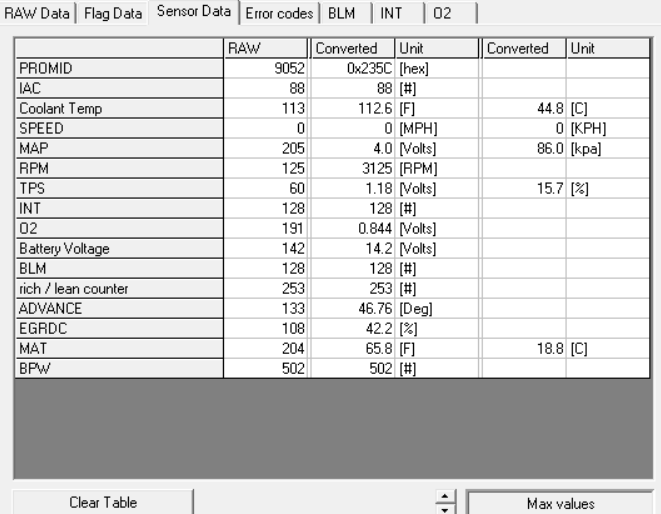

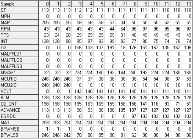

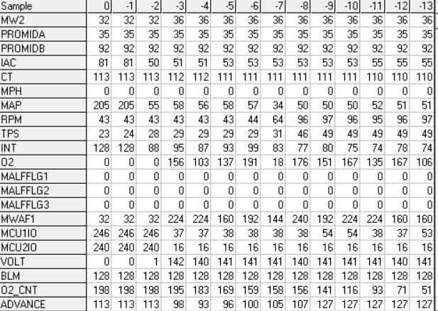

Also something I am noticing is in the data pics I posted before the MAP sensor drops drastically with WOT is that normal ?

These were the readings I got, yes I know about aldlview it worked once for me and then has never worked again 😂

Oh yea....Coolant temp is not functioning...... what's up with that?

Fixed that apparently previous owner had taken out thermostat so not it has a new one in and functions correctly 😂

edit: Although if your ADVANCE is 46 degrees as it appears to say....it won't be running well.

Just to sort of update the thread took it to the shop in town and map sensor was bad .....woooooooo, and apparently two injectors were bad , 1 and 3 so with new map sensor car actually accelerates still a little choppy but so much better , going to be getting some injectors from a lovely fellow on here and hopefully should be all good. Thanks for the help everyone sorry if I was a nuisance I really appreciate the help I got from everyone, I will let everyone know how the car goes after the swapped injectors.
