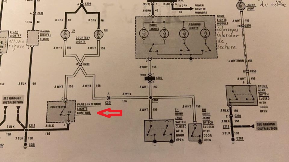

Hello everybody ,
I currently have my two door lights which stay on as long as the battery is connected to the car.
Anyone know where it could come from?
Here is the electrical diagram
Thanks all
Andy

Meaning Lights under dash on both side of car? And light above windshield is off?
Check fuses.
See my Cave, Sneak Path and Lighter
No blown fuses then might have wiring problems.

Yes i mean the Lights under dash on both side of car

This problem could came from the Panel interior light control ?
No.
That "switch" is part of Dash Dimmer and 2 dome lights above the glass would be on when you turn the dash dimmer to the top. (Side note: Turning off the dimmer will kill power to the chime unit.)
Or see page 8A-12-0 (Page # may change depending year of car covered) Light Switch Details that shows dimmer part on same page.
