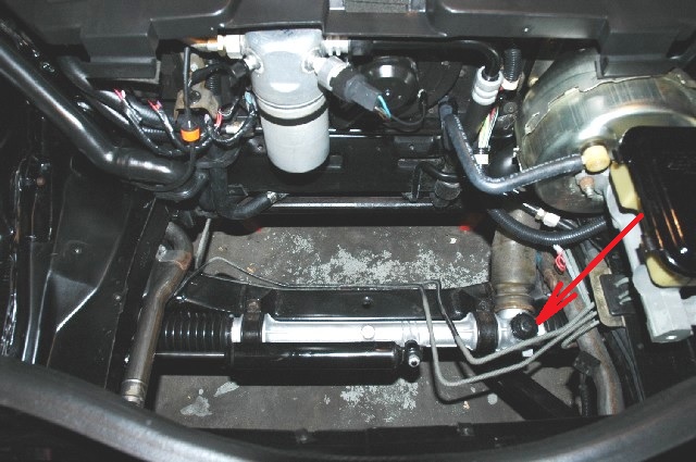

You might want to try adjusting the rack preload while on jack stands first. Don't overdo it.
Take the time to remove the spare tire tub. It makes things A LOT easier.
As does this http://rodneydickman.com/ca...h=27&products_id=126
This looks like a good place to start! Two questions: What is the function of the preload? Edit >> answered by theogre above "The "Preload" parts are the backstop pushing the rack into the pinon." <<
And how do you guys measure 2nm torque? Most torque wrenches don't have accuracy that low. I think mine starts at 5 ft lbs.

Do you have the rack already out of the car? Can't measure that otherwise.
If not, you can still try step 2 first and see if that makes any difference.
2. Turn adjuster plug clockwise until it bottoms, then back off 60 degrees.

Thanks guys! I'll be working on this next weekend. Just ordered the tool from Rodney.
