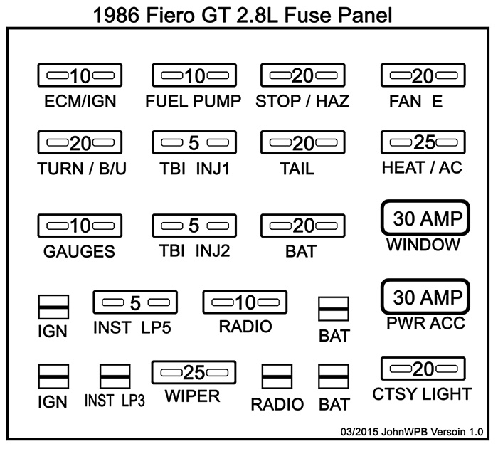

Check the 25 amp fuse HEAT / AC.

One problem solved.
I purchased a new relay after testing everything: motor, relays, control switch (dash head), and after a whole bunch of reading and asking questions, thought that a minimal expense was to replace the relays. I purchased and replaced the 'speeds' relay, and the motor now works on speeds 1, 2, and 3. I will pick up the second relay on Sunday (January 12) and replace the high speed relay. Hopefully, it will be the fix to the second issue (high speed - blower motor).
