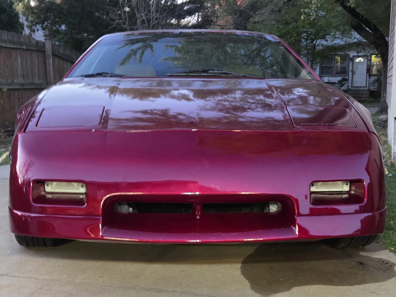

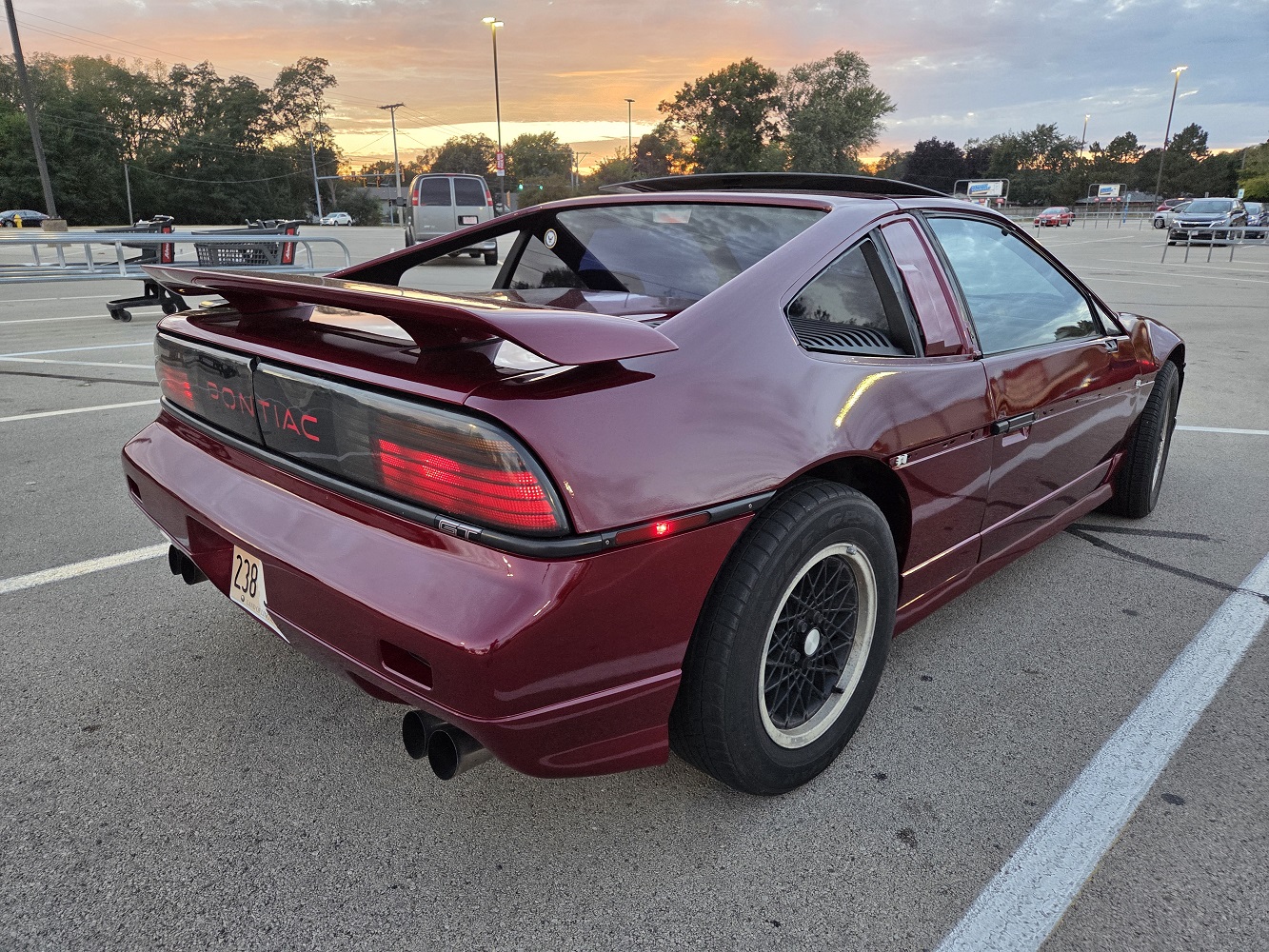

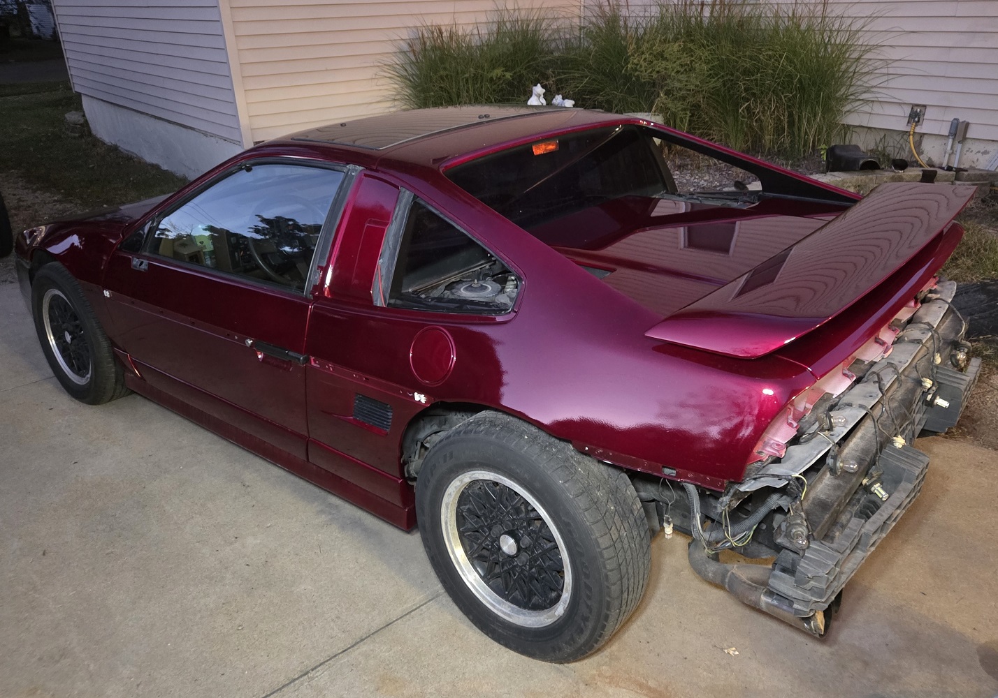

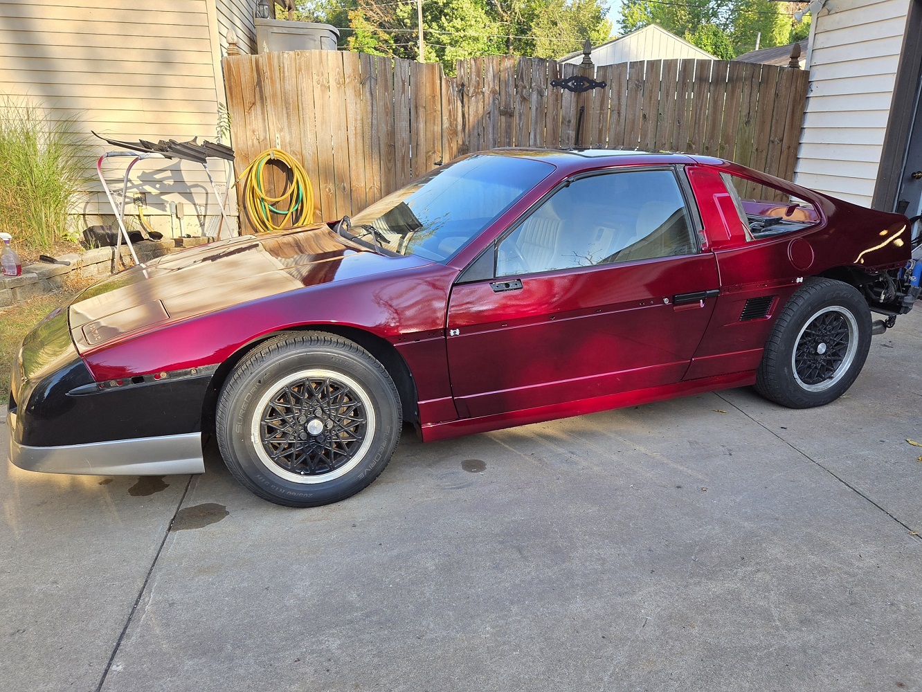

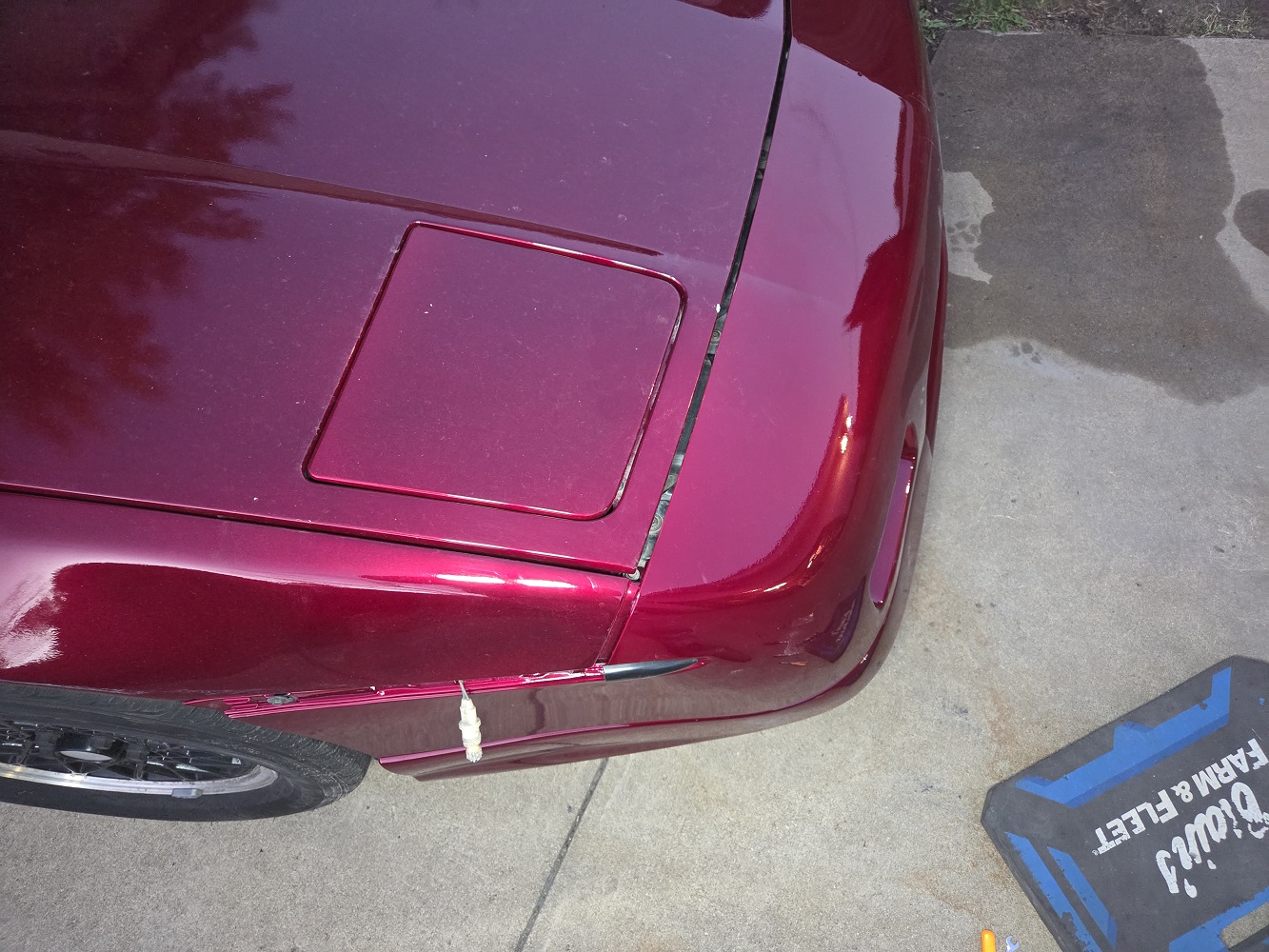

I picked up an 88GT from the Las Vegas Fiero Club a few years ago. I figured that I would start a resto thread since I am going to paint it. Here goes.
This how it looks right now.
I have done a lot of work to it since I got.

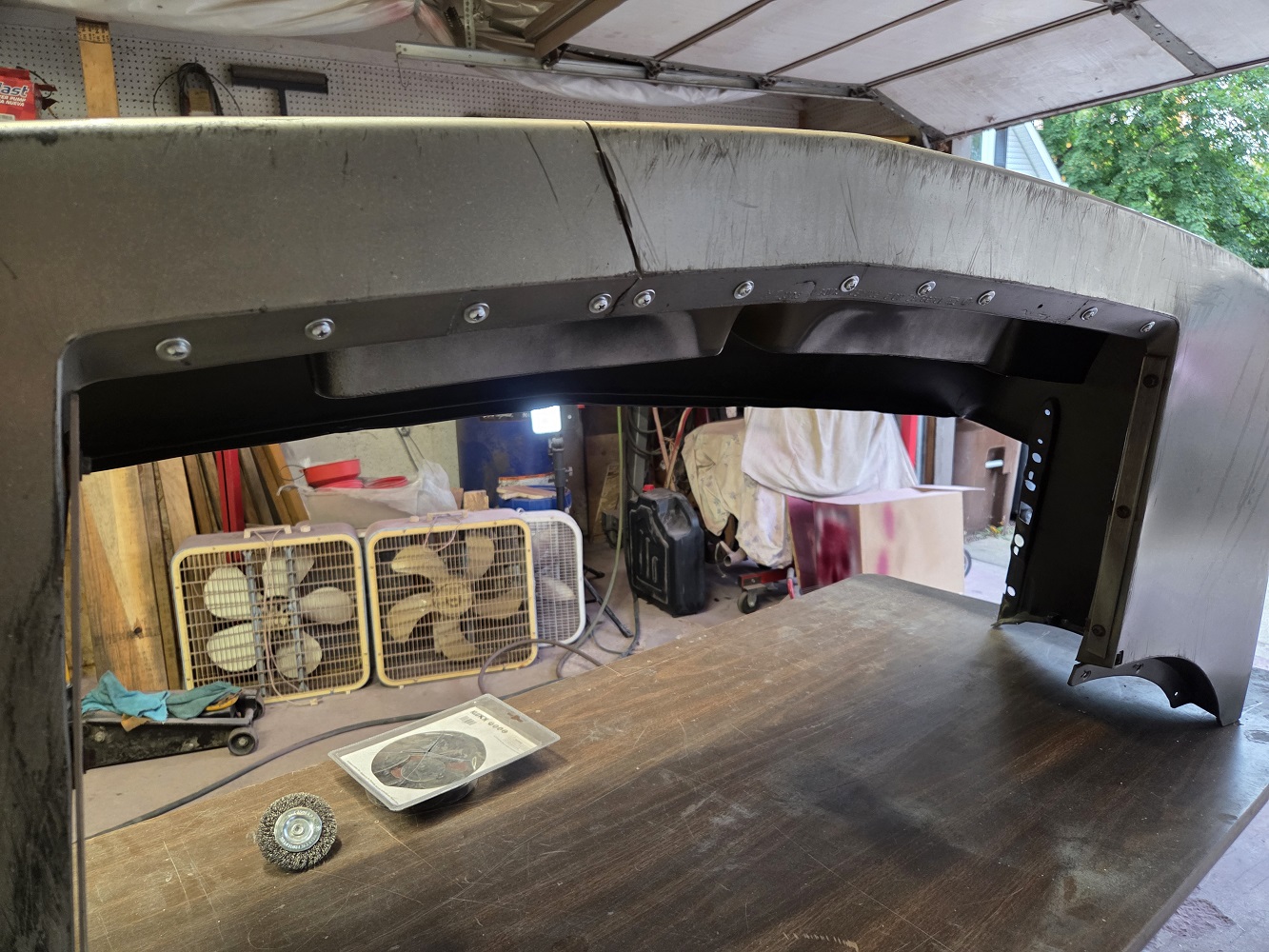

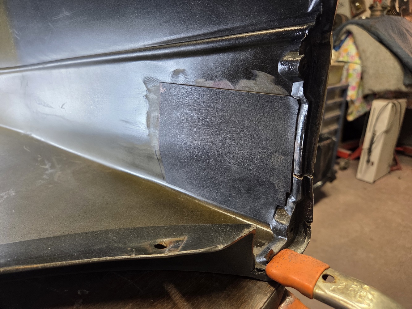

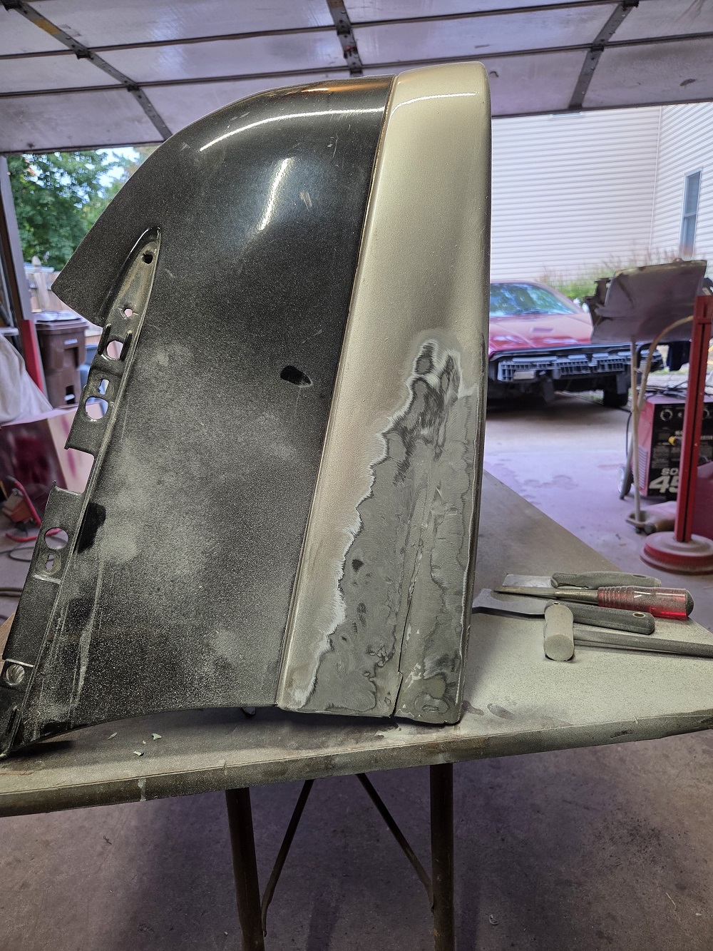

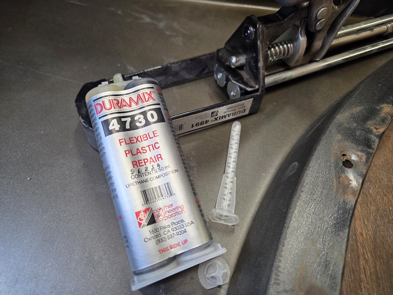

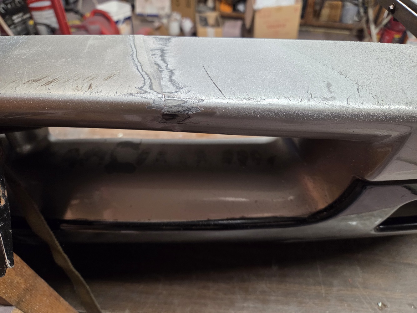

And so it begins. Body panels need to be replaced because this car came from the desert and is black. Also the car has been painted in the past with some sort of single stage enamel paint. They are all warped pretty bad. I have already replaced the front bumper cover, driver side door skin, and front hood. I have the passenger side door skin, rear clip, and rear bumper cover. All of my replacement panels have OEM paint on them at least. The fenders, lower quarter panels, and rear deck lid are all salvageable.
One of the threaded studs spun out, I had to cut he skin off.
We had this exact same problem on my daughter's 85 Fiero, and even on the same stud as well. I was able to cut it off using a sawsall, and then miraculously, I was able to re-weld the same stud I'd cut off, using my mig-welder, and then epoxied the base of it on the fiberglass so it wouldn't spin. We were able to get it all back together like new without having to cut.
lucky for you it's not difficult to repair that panel afterwards.
lots of chamfering on both parts and getting that cut out center peice sanded much shorter to them use a fiberglass epoxy or a specific boat resin and standard fiberglass sheets to make it strong before sanding it down and using gold filler then icing and spot filler before filler primer

You don't have to cut the skin off for that spinning stud. There is a retainer in there that keeps the bolt shoulder (square) held against the skin to prevent the stud from moving up and coming loose. You just need to apply some force on the skin upward to keep the stud down as you remove the nut.
I found my retainer sitting on the roof of the car rusted out. Replaced it before putting the clip back on.
Thanks guys. I wasn't planning to save that skin anyhow. It was cracked and sunstroke rotting.
I did try to save it, in one of the pics there is a crowbar under the skin in one of the pics. The rear clip has been replaced before and not very well at that. It was garbage to begin with.
Heres my replacements. They are from northern Illinois here so they are very straight. The rear clip I got from Paul Vargyas when he moved.

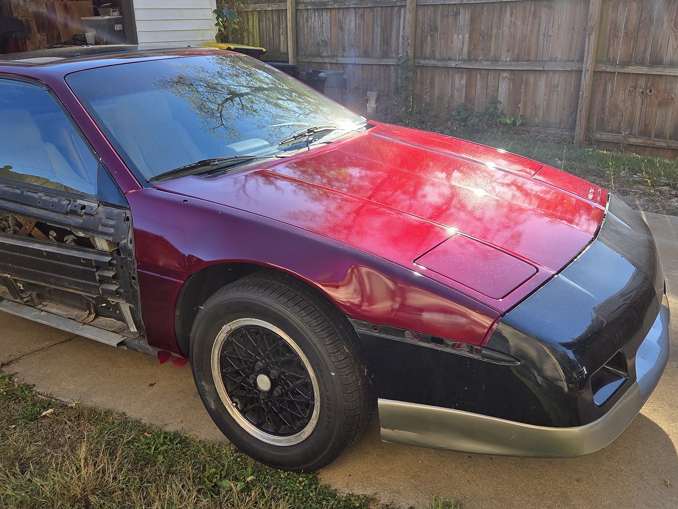

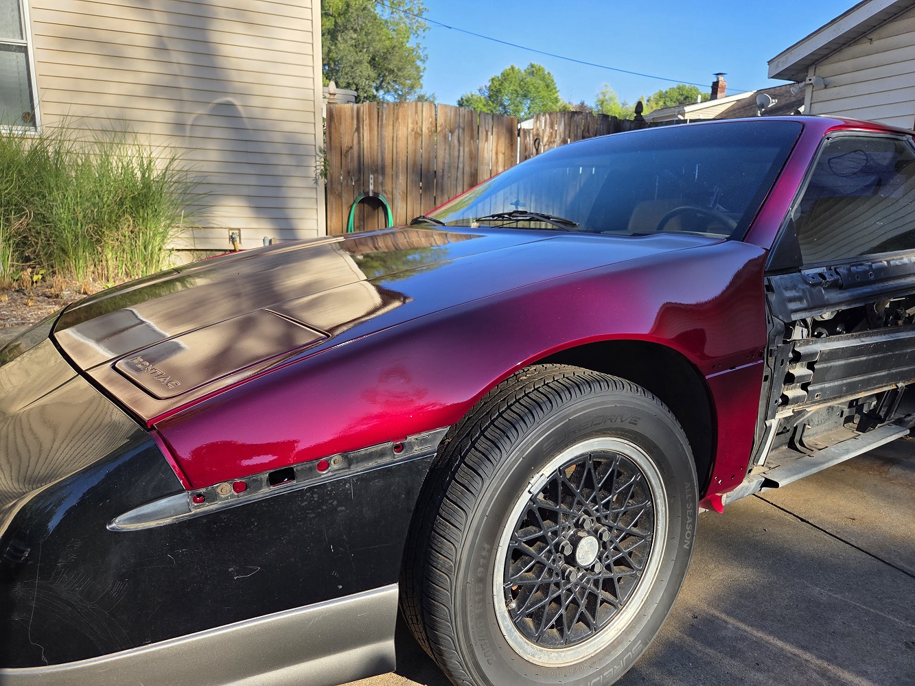

Report this Post09-24-2024 11:46 PM Click Here to See the Profile for hercimer01Send a Private Message to hercimer01Edit/Delete MessageReply w/QuoteDirect Link to This Post

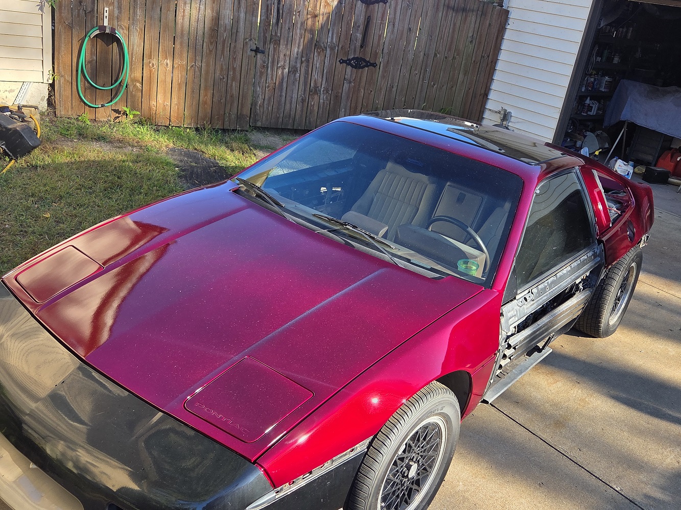

I took the last few days off to start painting the car, but I did find a bit of rust. I had to repair it before I could move on. For a desert car this isn't to bad.

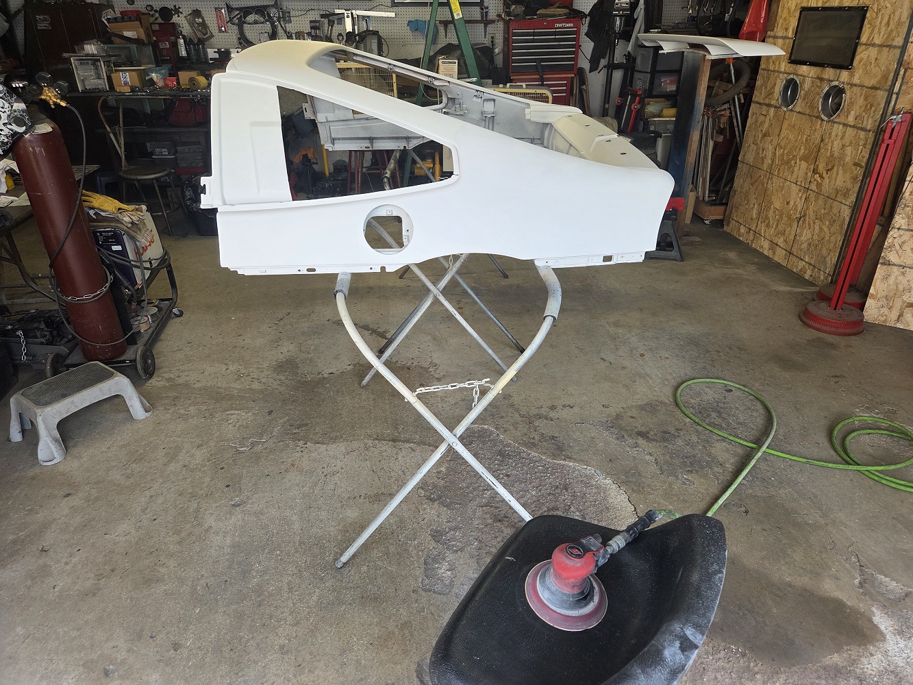

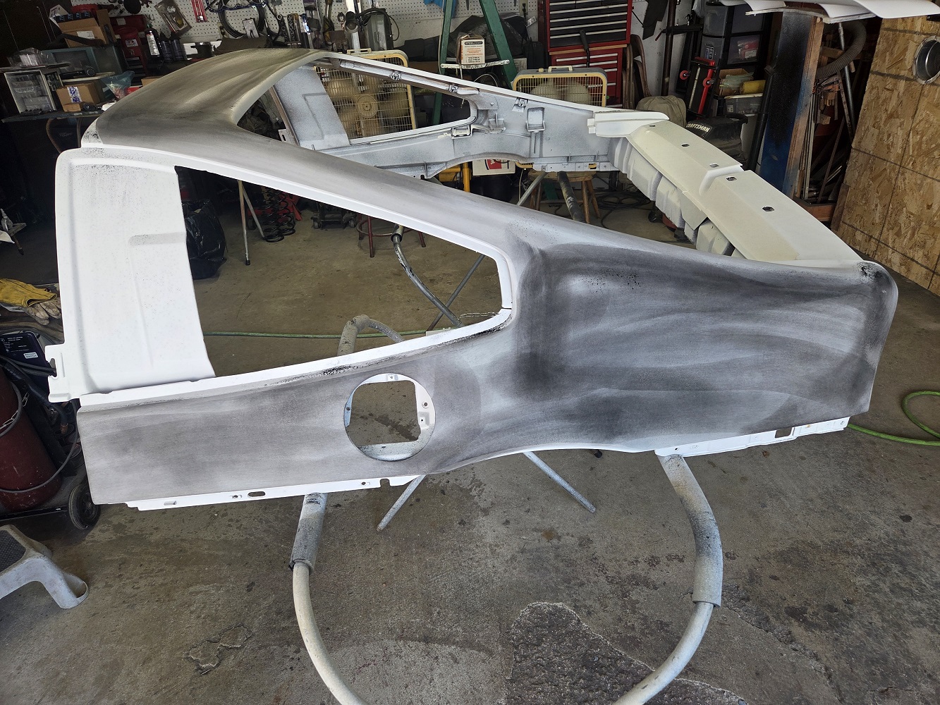

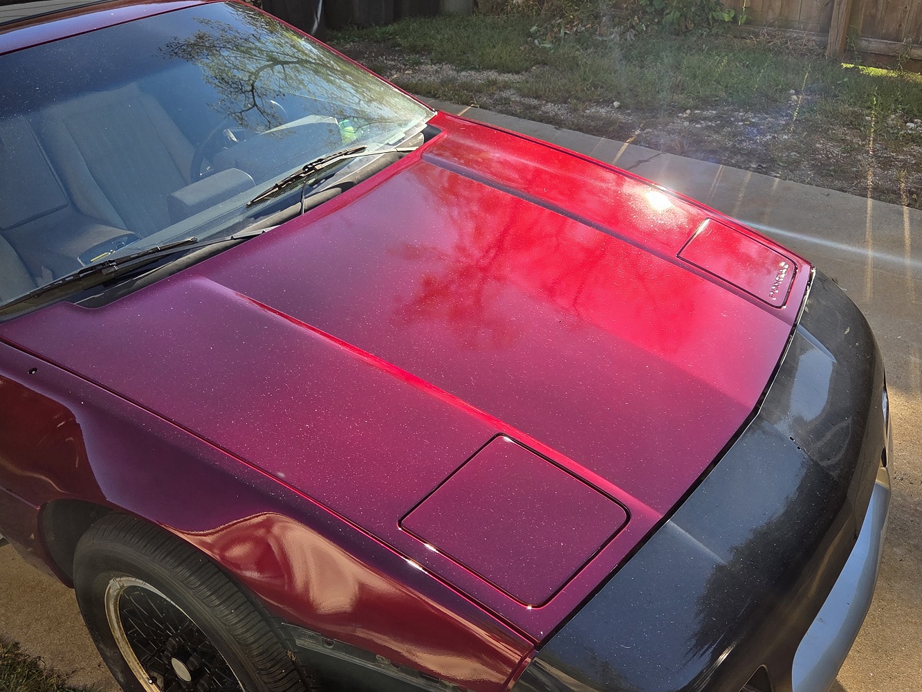

Report this Post05-19-2025 11:58 PM Click Here to See the Profile for hercimer01Send a Private Message to hercimer01Edit/Delete MessageReply w/QuoteDirect Link to This Post

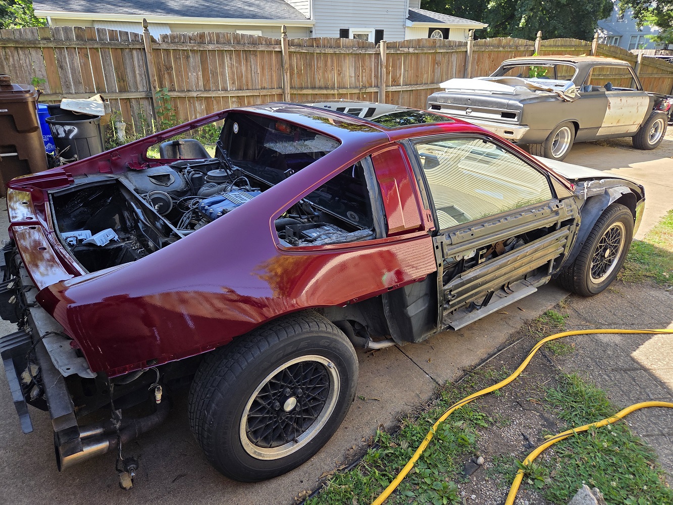

The thread stopped due to my mothers move across country. I was so preoccupied with uprooting a lifetime of her belongings last winter.
I am also restoring a 1969 AMC Rogue by stripping it down to bare metal. It is also ready for body filler and paint.

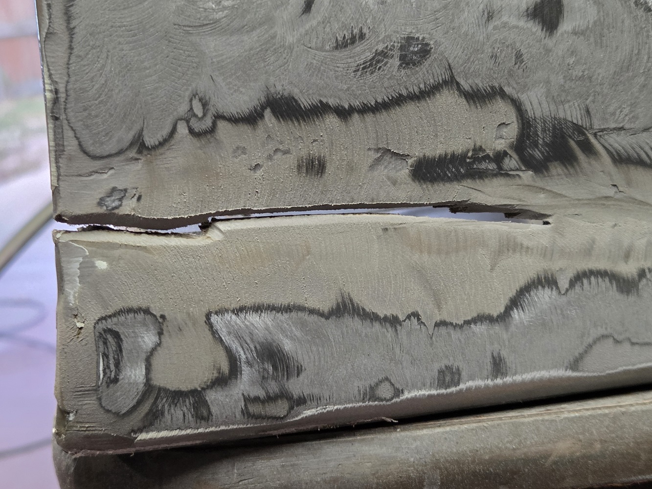

I'm back at it now. I have been sanding the body panels and getting them ready for primer.

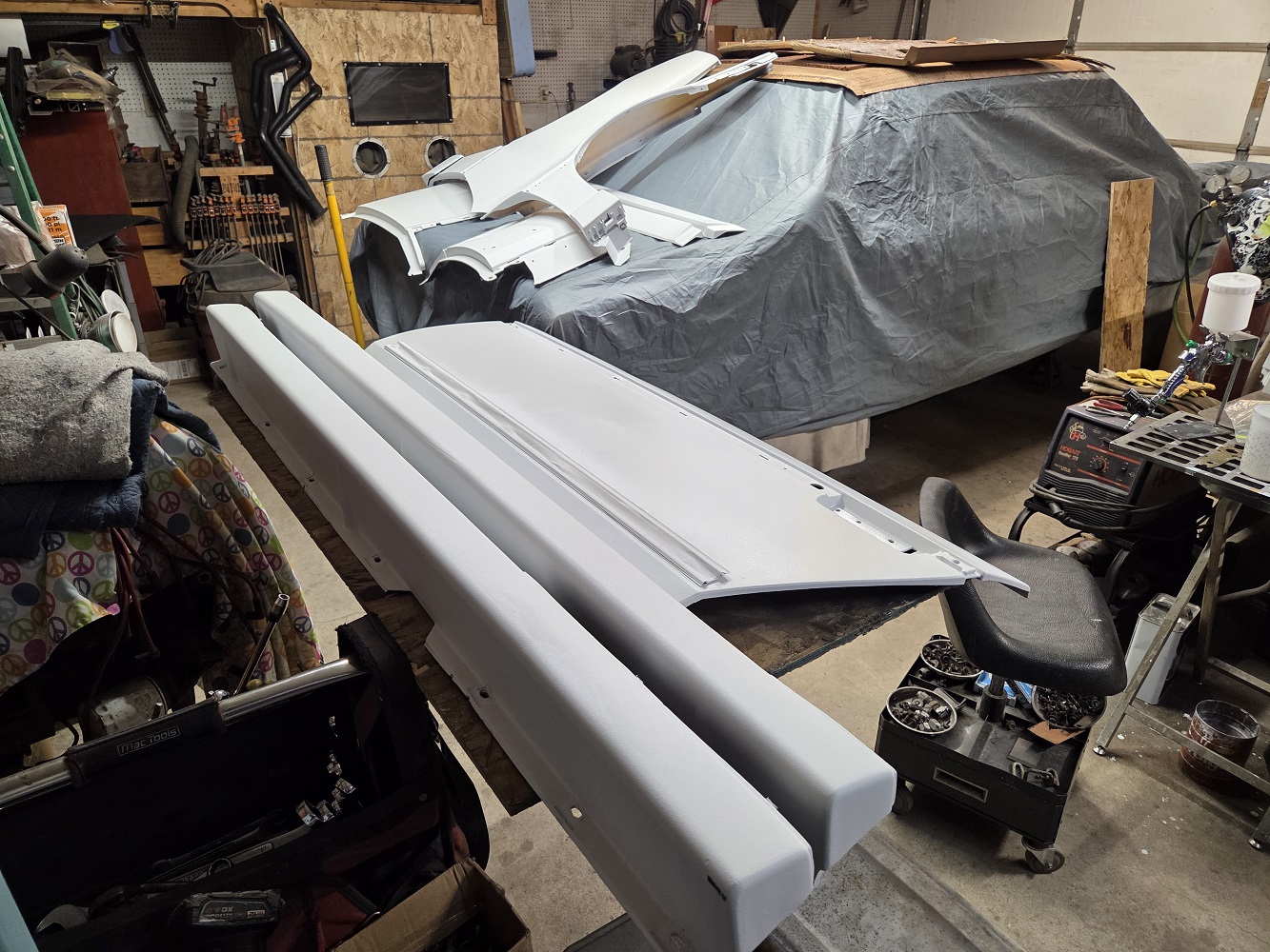

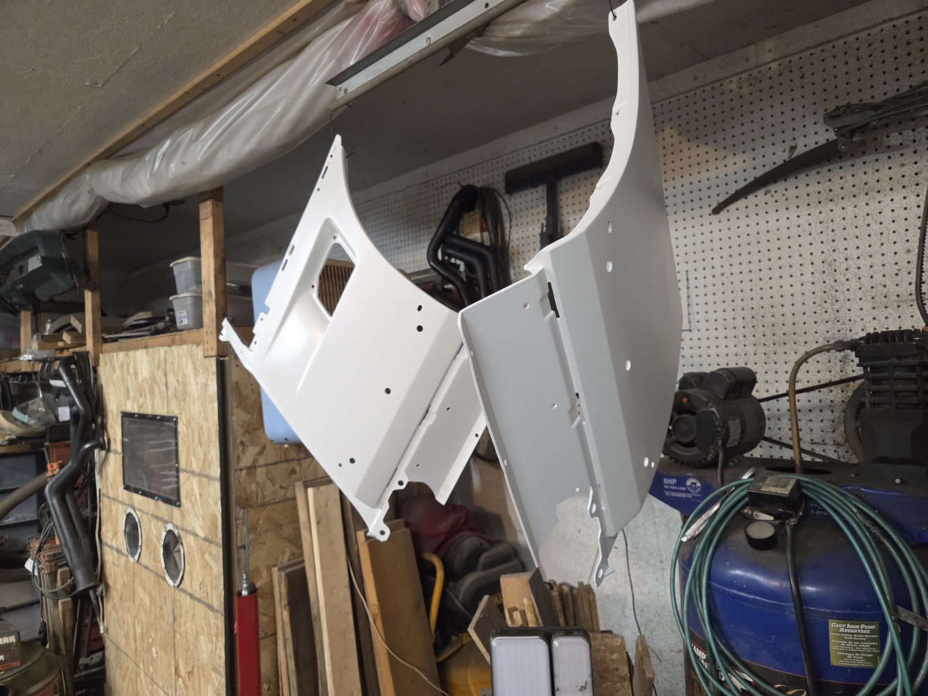

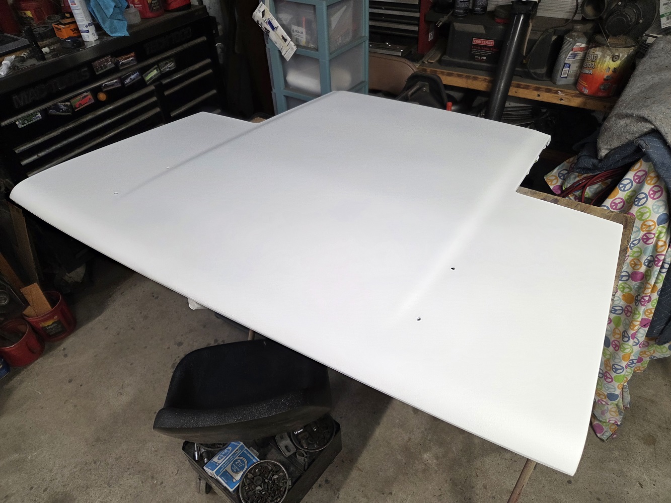

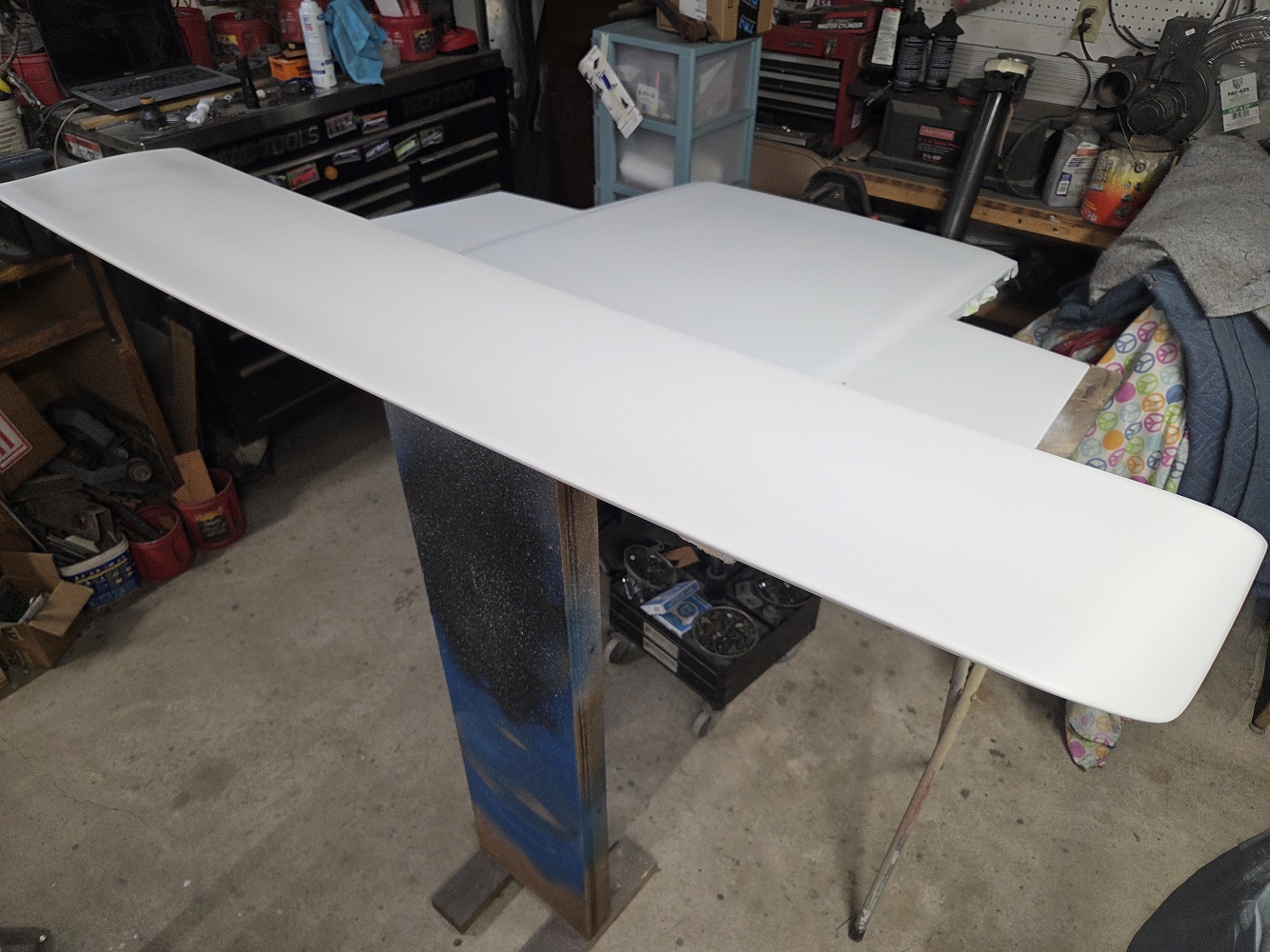

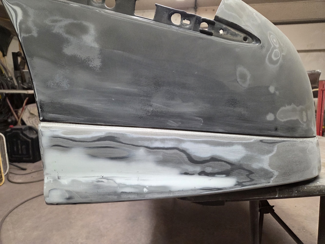

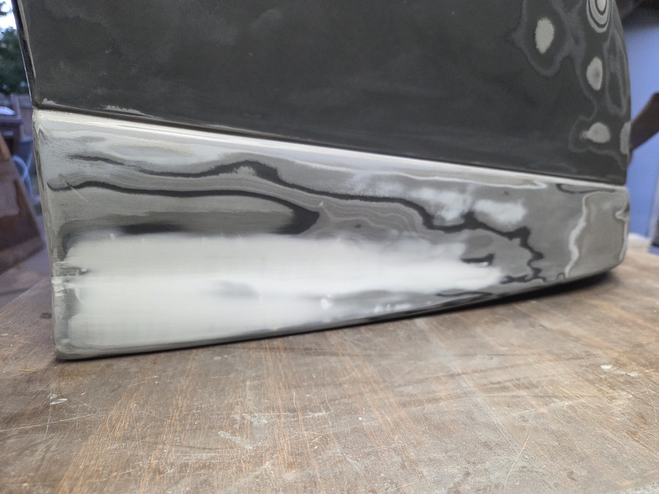

Report this Post05-26-2025 12:58 AM Click Here to See the Profile for hercimer01Send a Private Message to hercimer01Edit/Delete MessageReply w/QuoteDirect Link to This Post

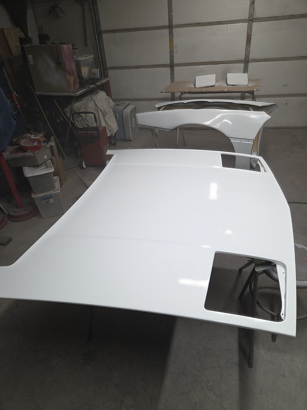

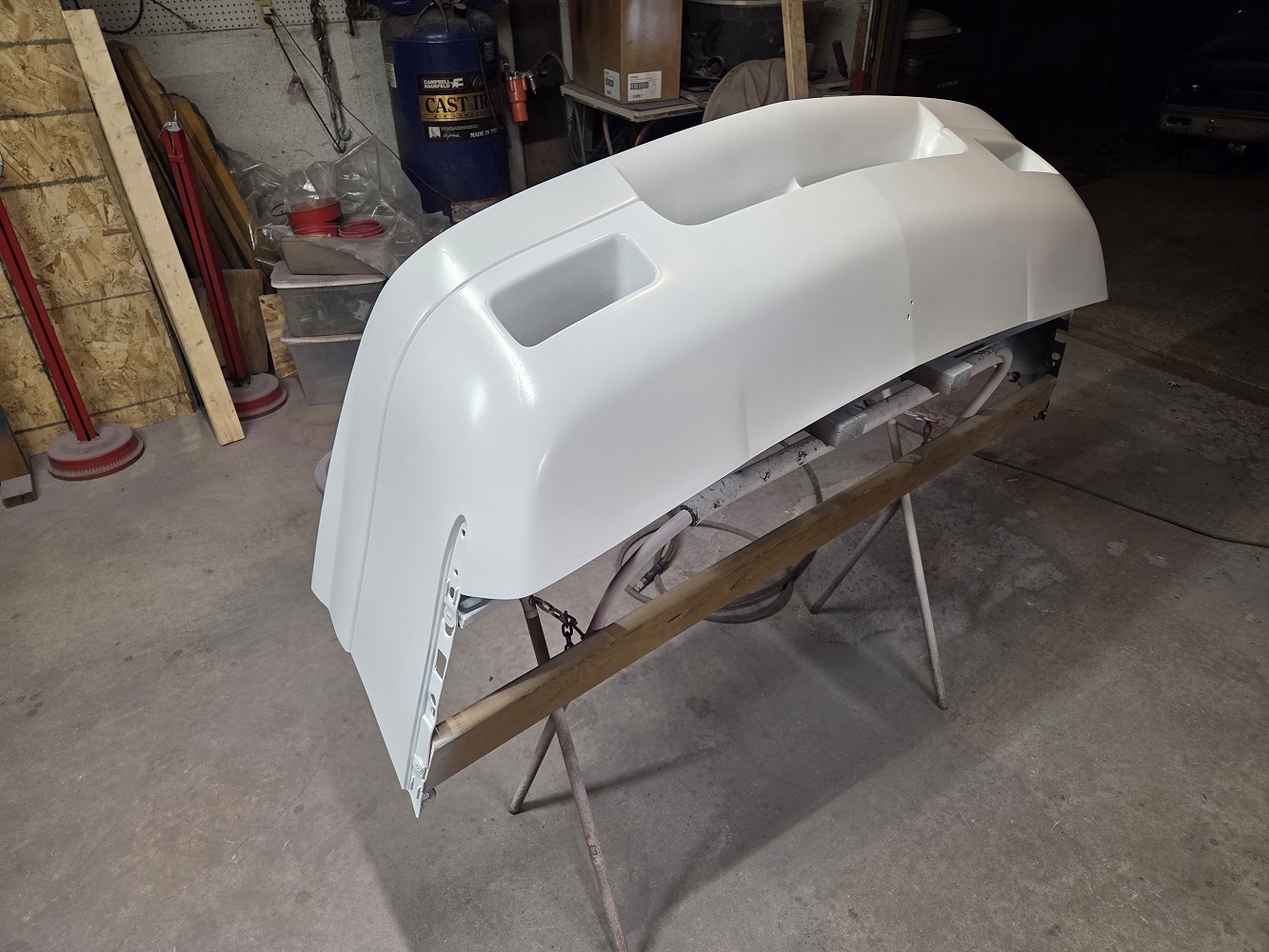

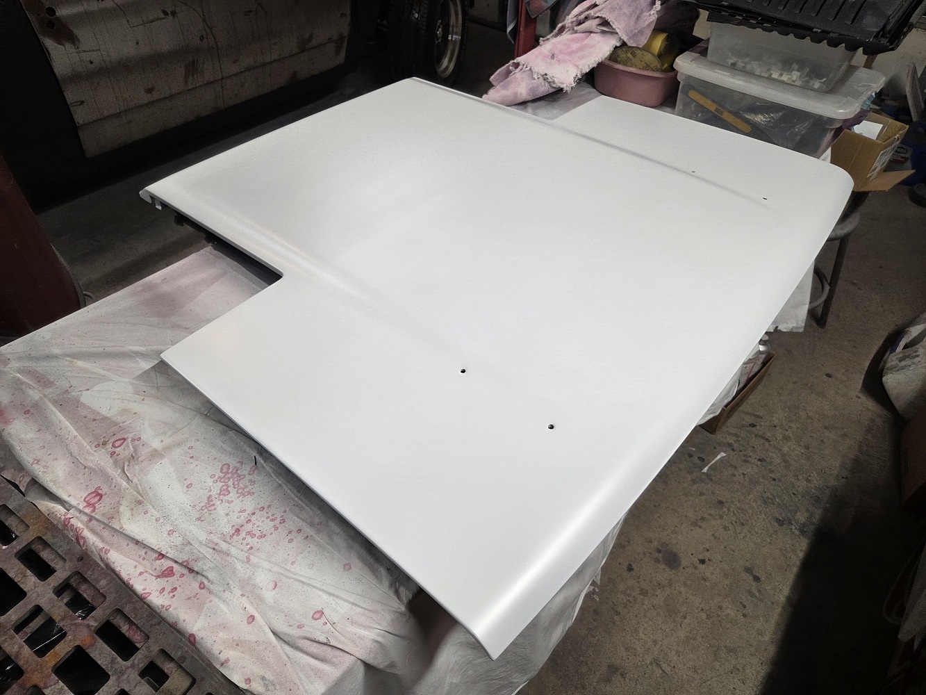

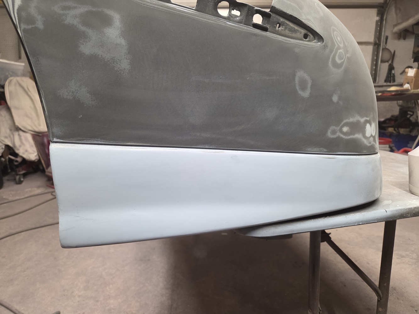

Every thing that's removable from the car besides the hood and bumper covers is primed with the Speedo Kote. That stuff is like pudding. Make sure you get a cheap Amazon gun with a 1.5 tip if you use it. I put in a hardware kit and new gasket for the sunroof from the Fierostore also. The gasket tracks were fine but the drain holes were plugged. That's probably why it was leaking. I opted to changed the gasket also because this is a desert car and it was pretty hard from the heat. I changed the rear clip with one I got from Paul Vargyas. It had some damage. I replaced all the body panels and front hood were heat stroked too. The door skins were peeling back on the tops due to warpage. Basically all that's original to the car is the roof skin, fenders, rocker panels, trunk lid and wing. I got some near perfect bumper covers from one in Chicago with no spider web cracks at all.

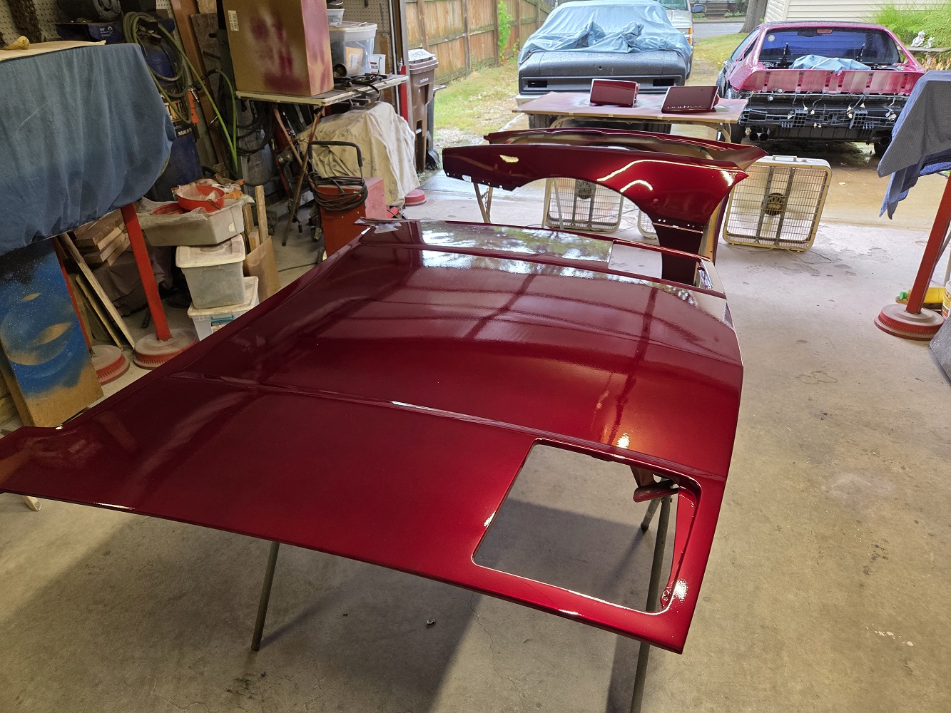

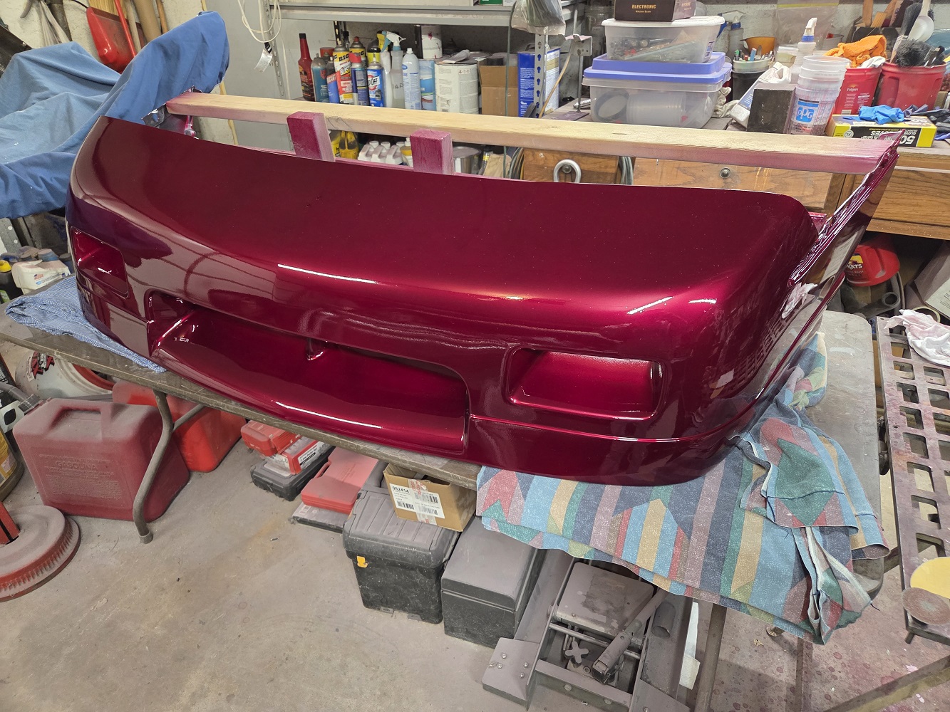

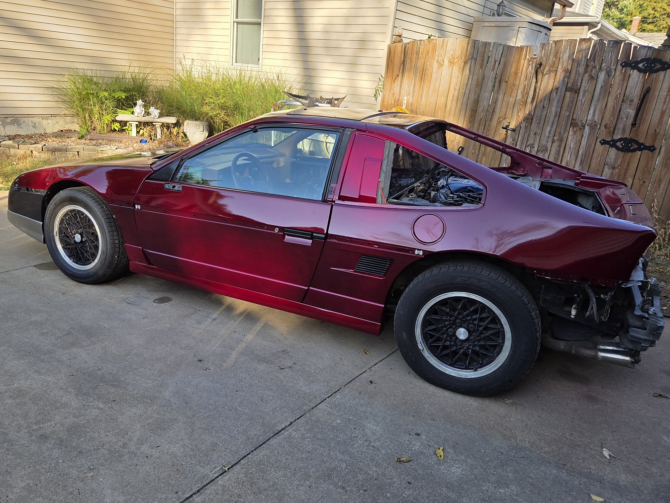

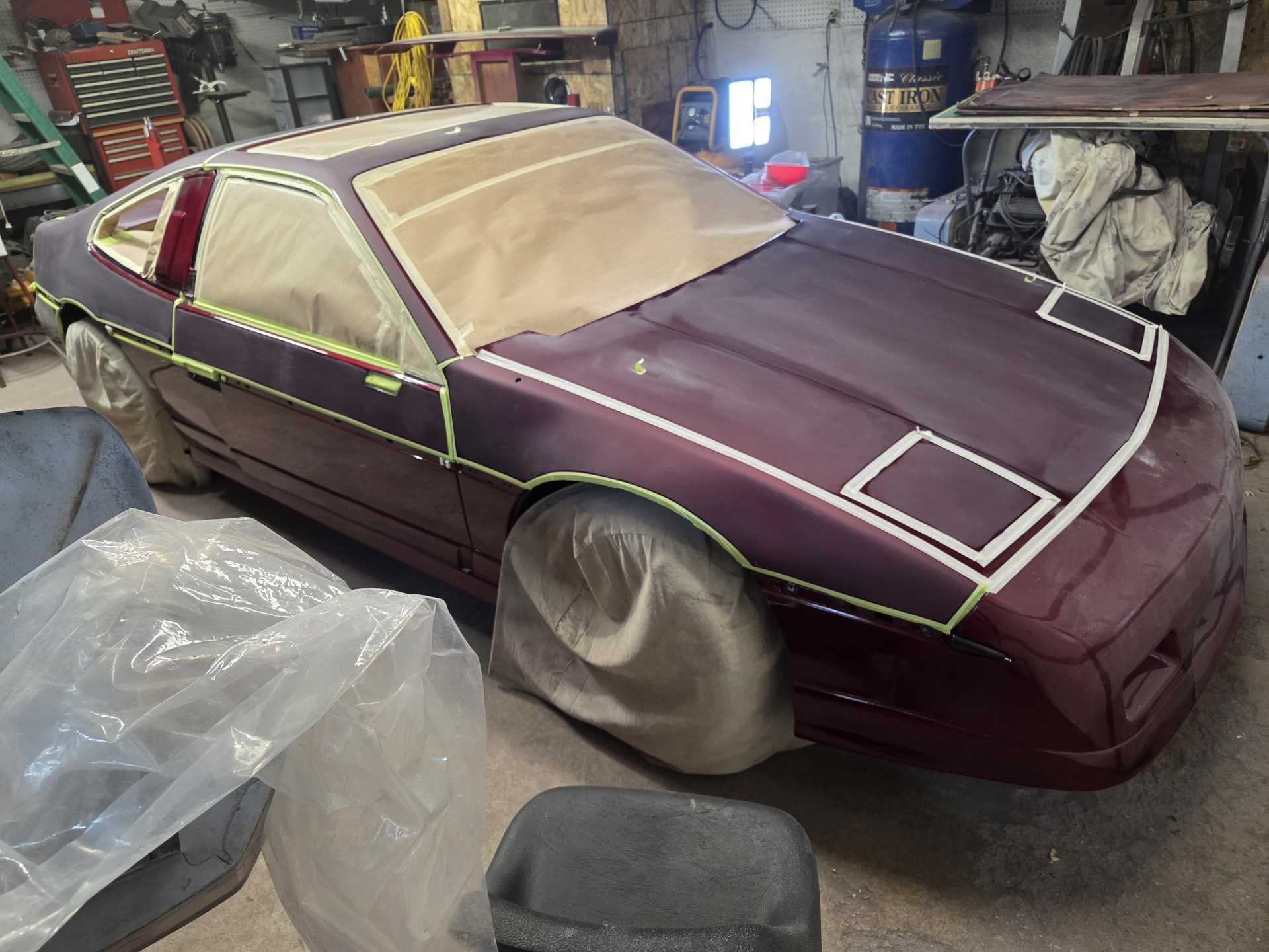

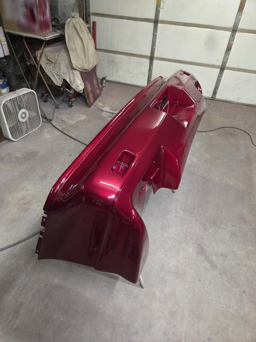

Report this Post08-18-2025 11:13 PM Click Here to See the Profile for hercimer01Send a Private Message to hercimer01Edit/Delete MessageReply w/QuoteDirect Link to This Post
I'm back on the paint job. I have decided to sell the car once it's painted. I do have a whole 3800SC swap ready to go in but I don't plan to install but I could if someone was interested.

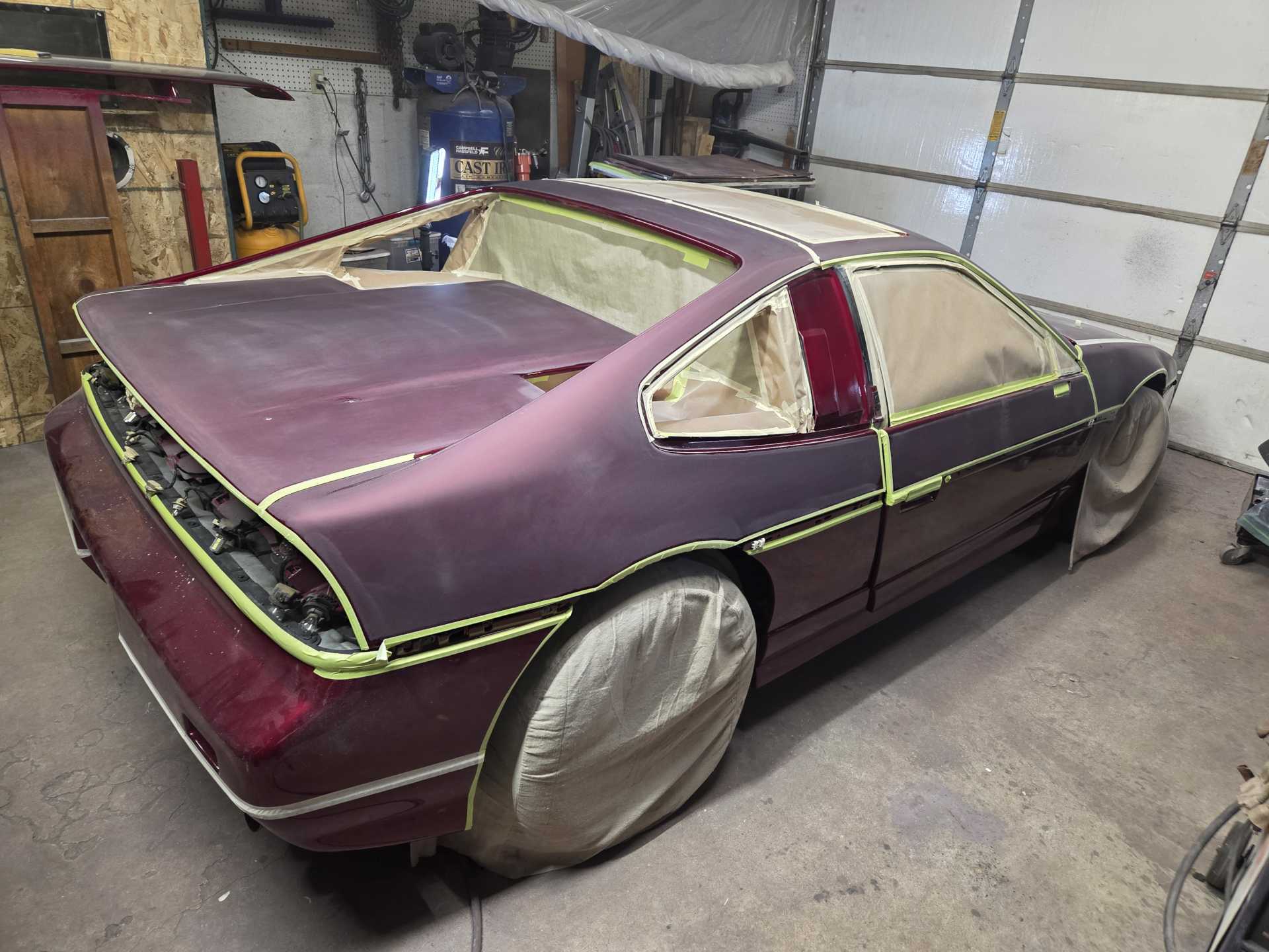

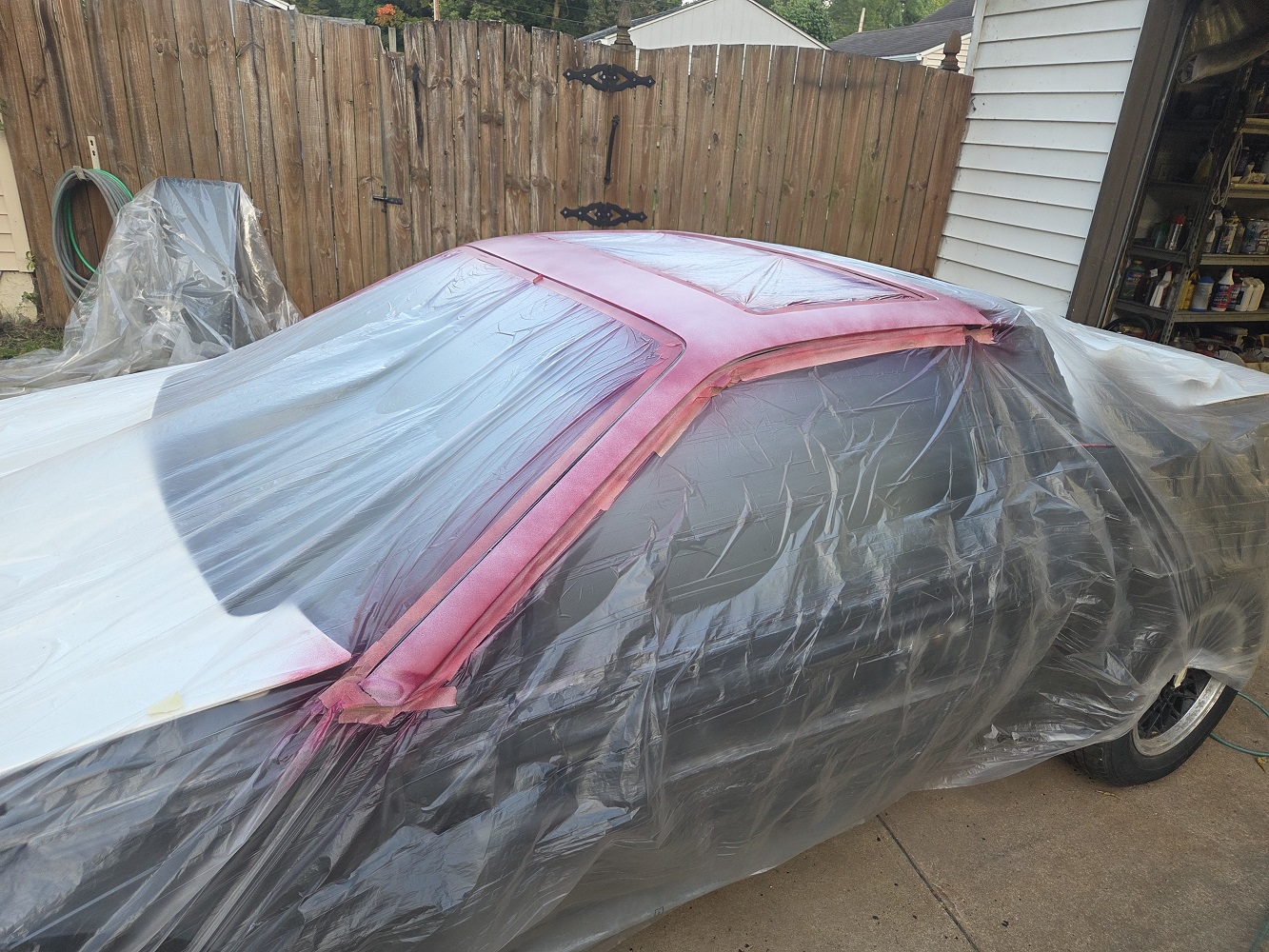

I decided not to go with Solar Gold as a base but to go with white as a base. I figured that the gold would give it an orange tint. I am really after the Brandy wine brightest color. Here's the roof and rear clip. The front roof needs a bit more color because it looks like magenta and doesn't match the rear. This is why things should be sprayed all together. The only reason I took the rear clip off is because The original one was to beat up.
I'll be able to adjust it later when I give it a final flow coat.

Nailed it!

Making progress.

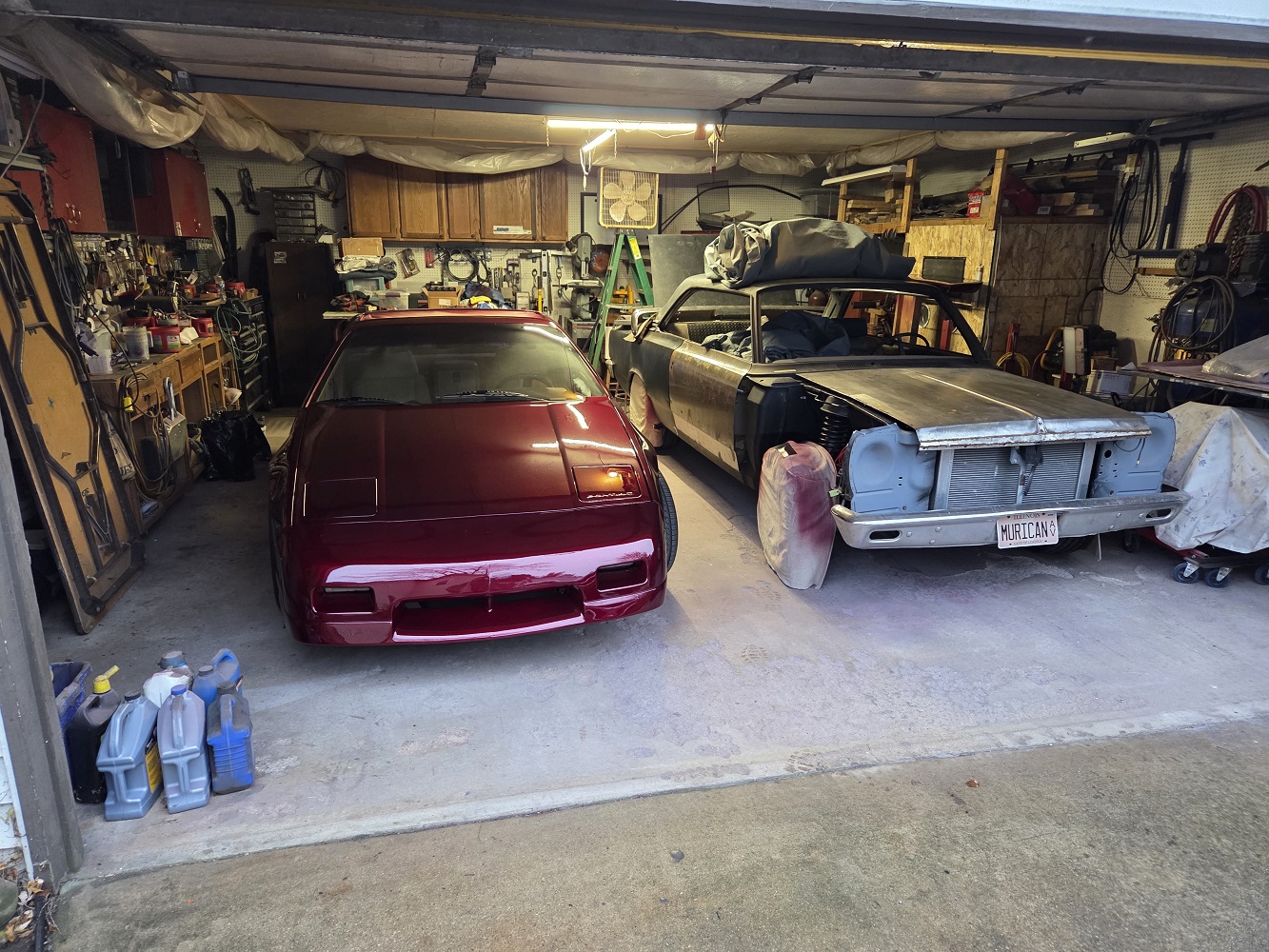

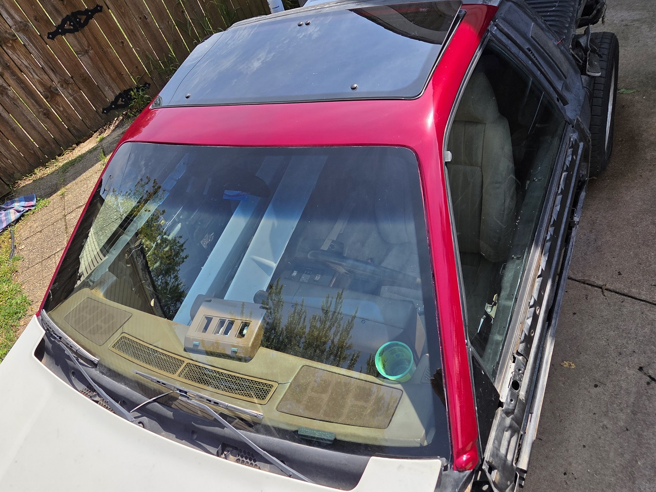

The sun is finally out.

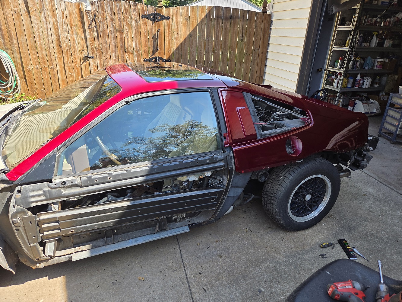

Report this Post10-04-2025 10:19 PM Click Here to See the Profile for hercimer01Send a Private Message to hercimer01Edit/Delete MessageReply w/QuoteDirect Link to This Post

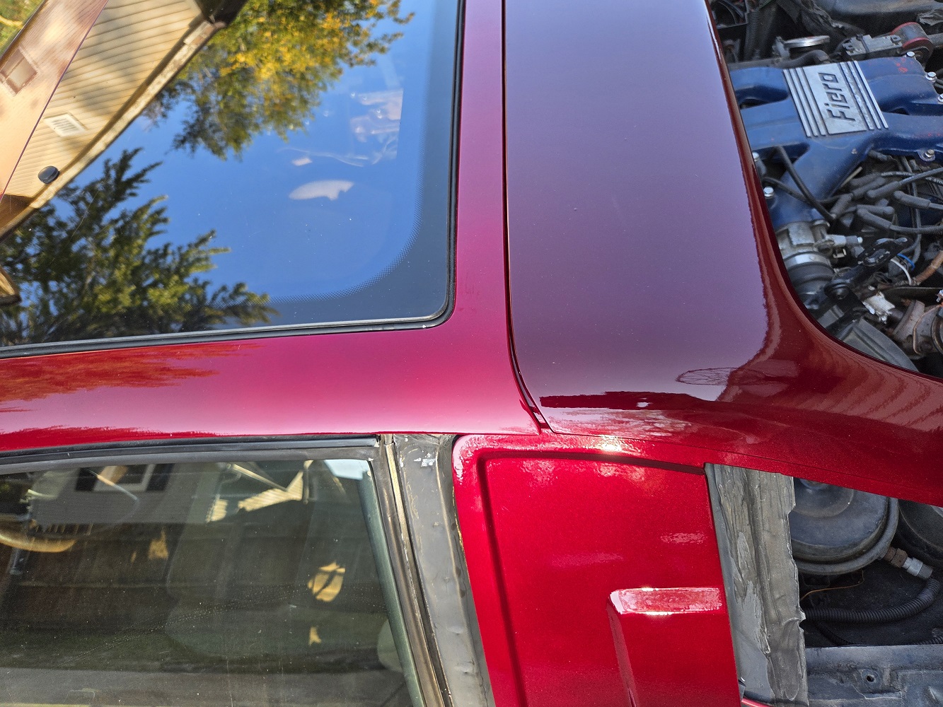

The sun light is shining through a tree on the car.

Report this Post10-09-2025 10:24 PM Click Here to See the Profile for hercimer01Send a Private Message to hercimer01Edit/Delete MessageReply w/QuoteDirect Link to This Post

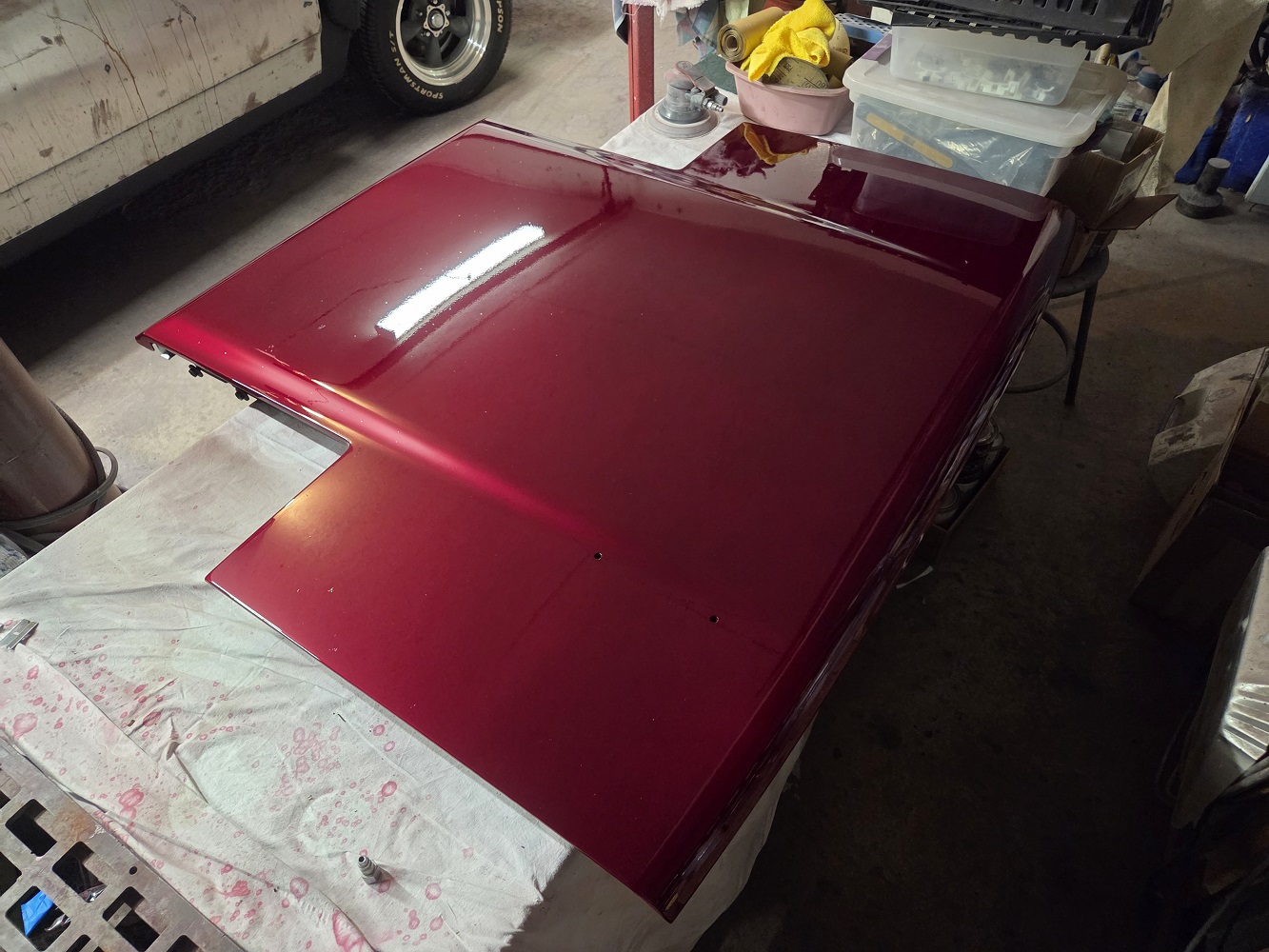

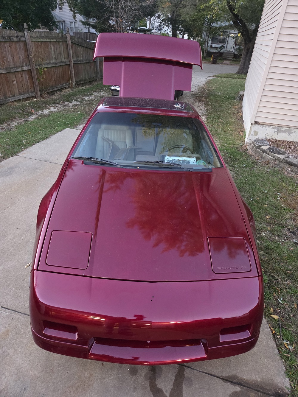

It's getting dark sooner. I got the trunk lid and wing done. All thats left are the bumper covers and trim.
I shall call thee SKEETER!

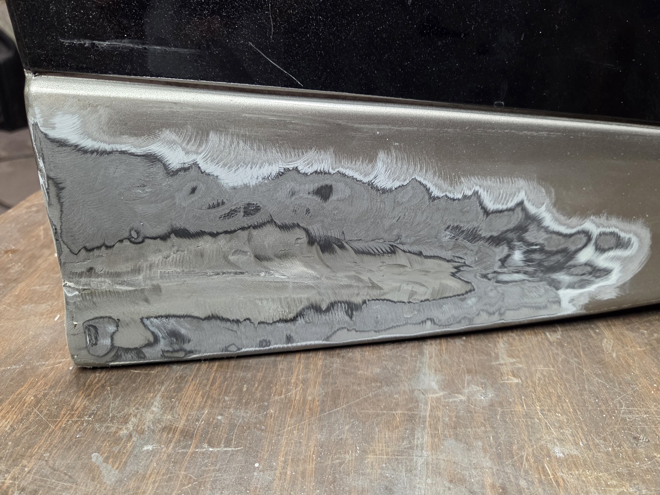

Report this Post10-19-2025 03:18 AM Click Here to See the Profile for hercimer01Send a Private Message to hercimer01Edit/Delete MessageReply w/QuoteDirect Link to This Post

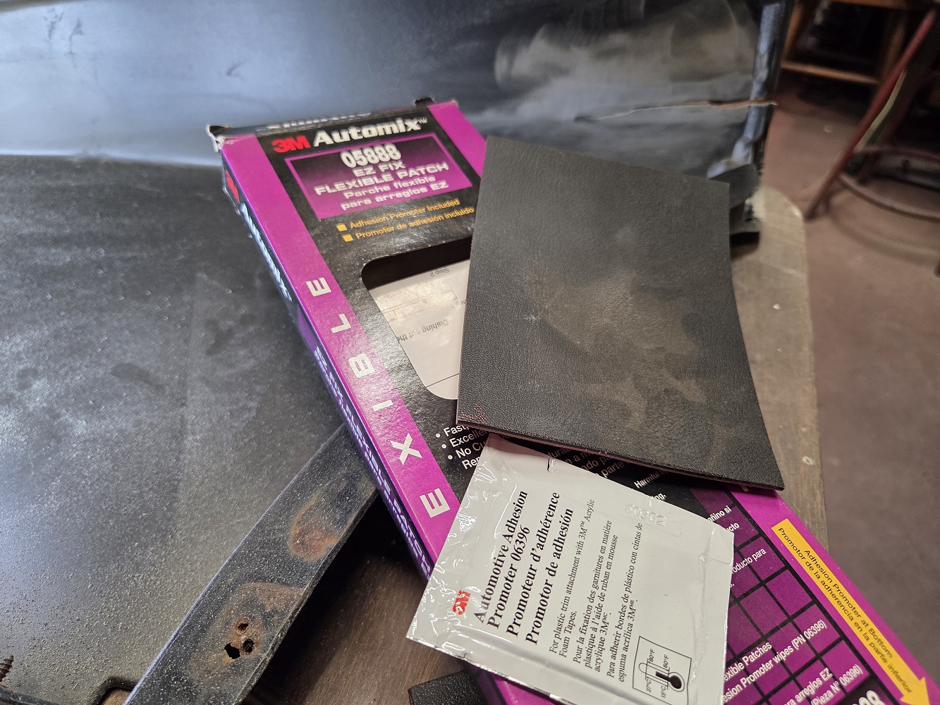

Been busy on it.
SKEETER! AHHHH!

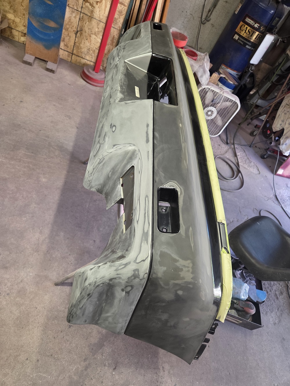

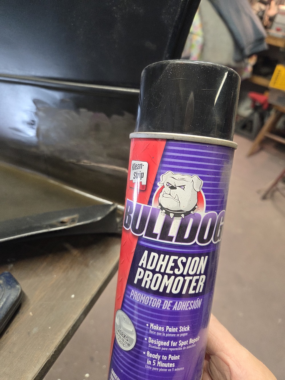

This was a previous repair gone horribly wrong. It was just bondo on a tear. Needless to say it failed. I had to chisel out a ton of filler from the area. 3M sticky patches and flexible filler is the only thing that will last.
This is an old picture. This summit link is a current product.
[This message has been edited by hercimer01 (edited 10-19-2025).]

Report this Post10-19-2025 11:44 PM Click Here to See the Profile for hercimer01Send a Private Message to hercimer01Edit/Delete MessageReply w/QuoteDirect Link to This Post
hercimer01
2336 posts
Member since Mar 2008

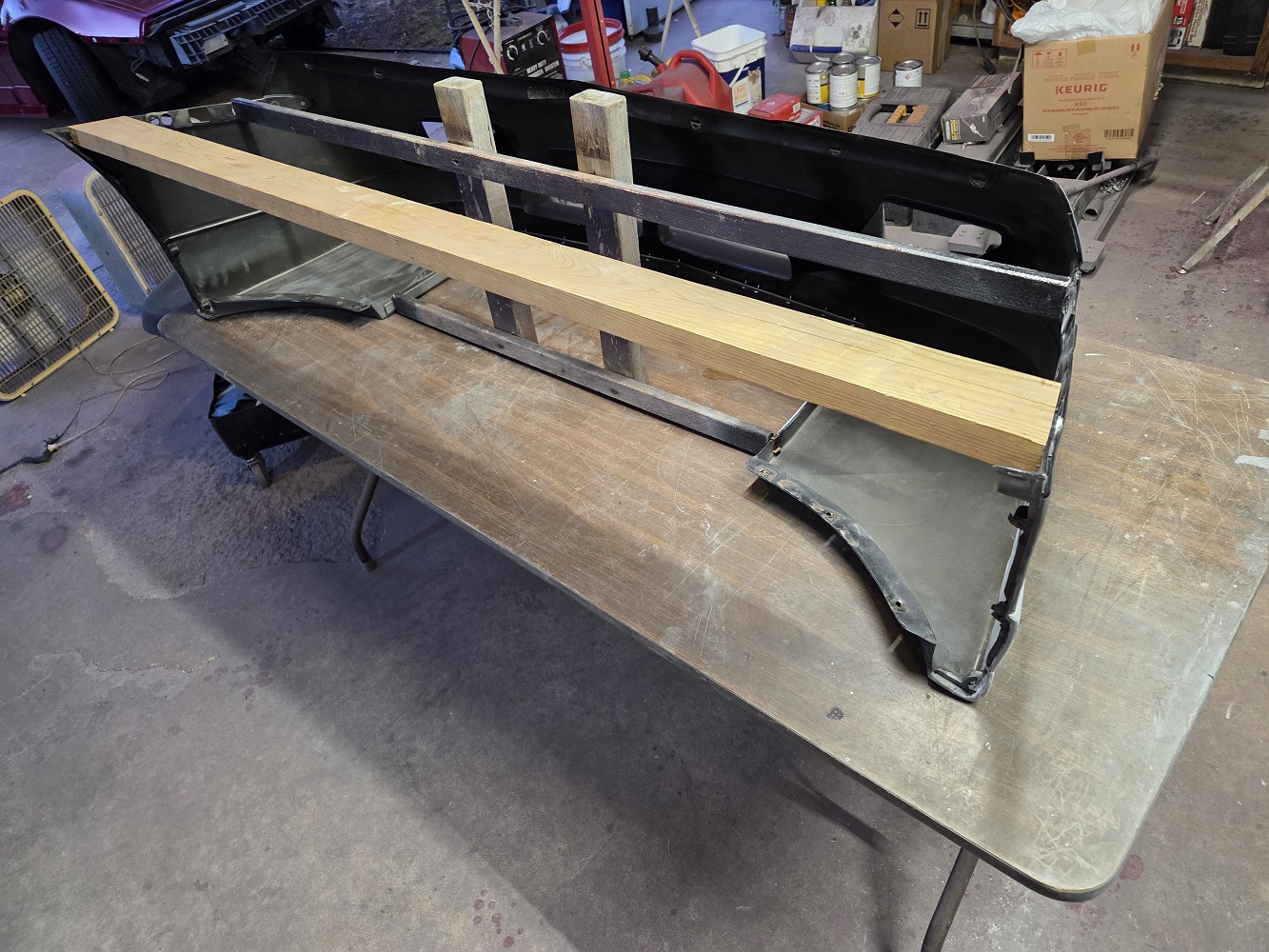

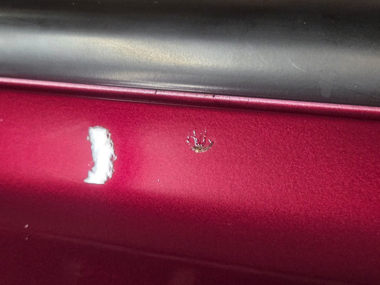

I had to give the repair one more skim coat of filler.
Also I had to grind out all of the spider web cracks because they will just show back though in the new paint.

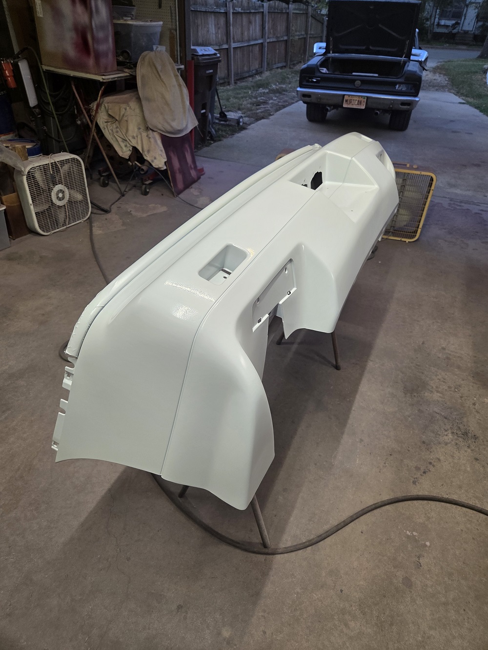

I have a frame to strengthen the bumper cover while handling. It's ready for primer now.

Finally got the nose done.

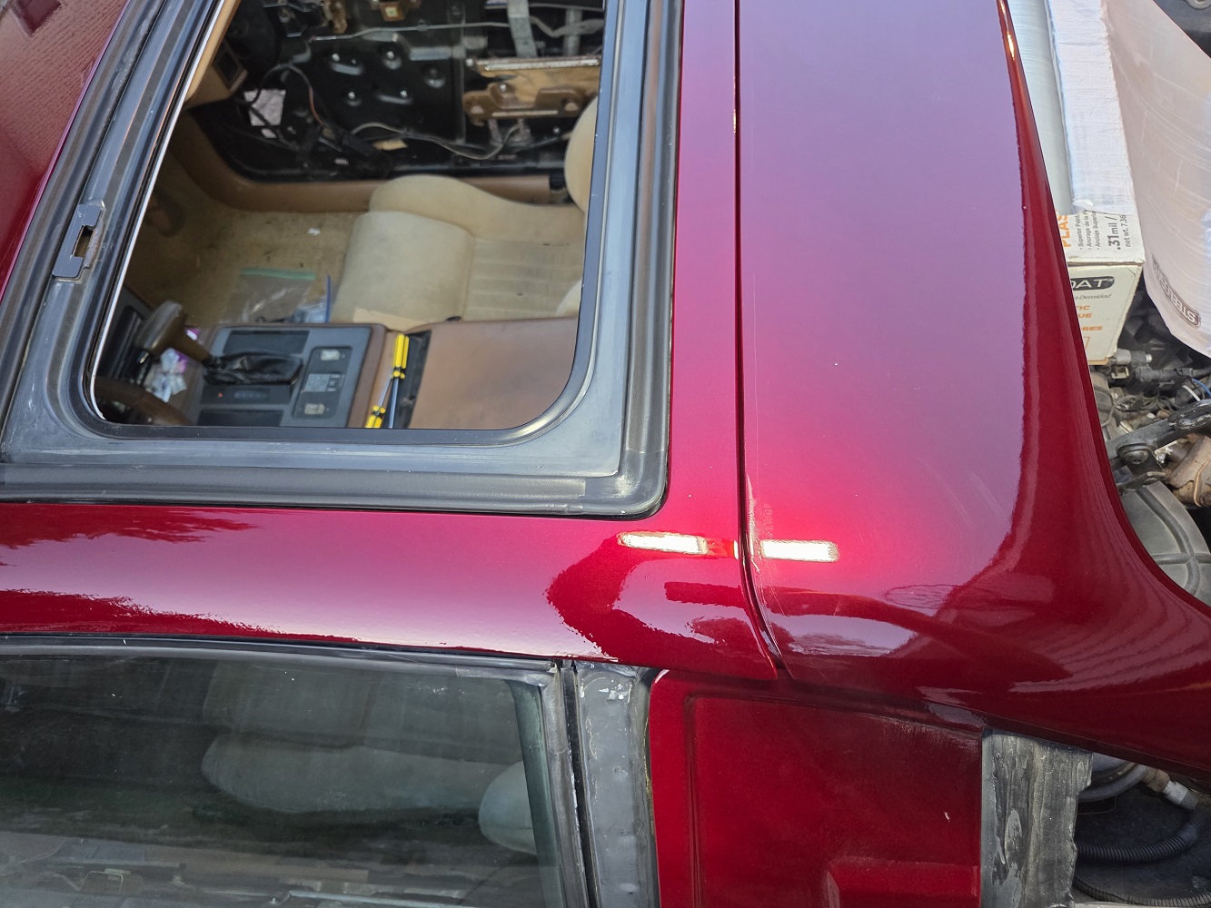

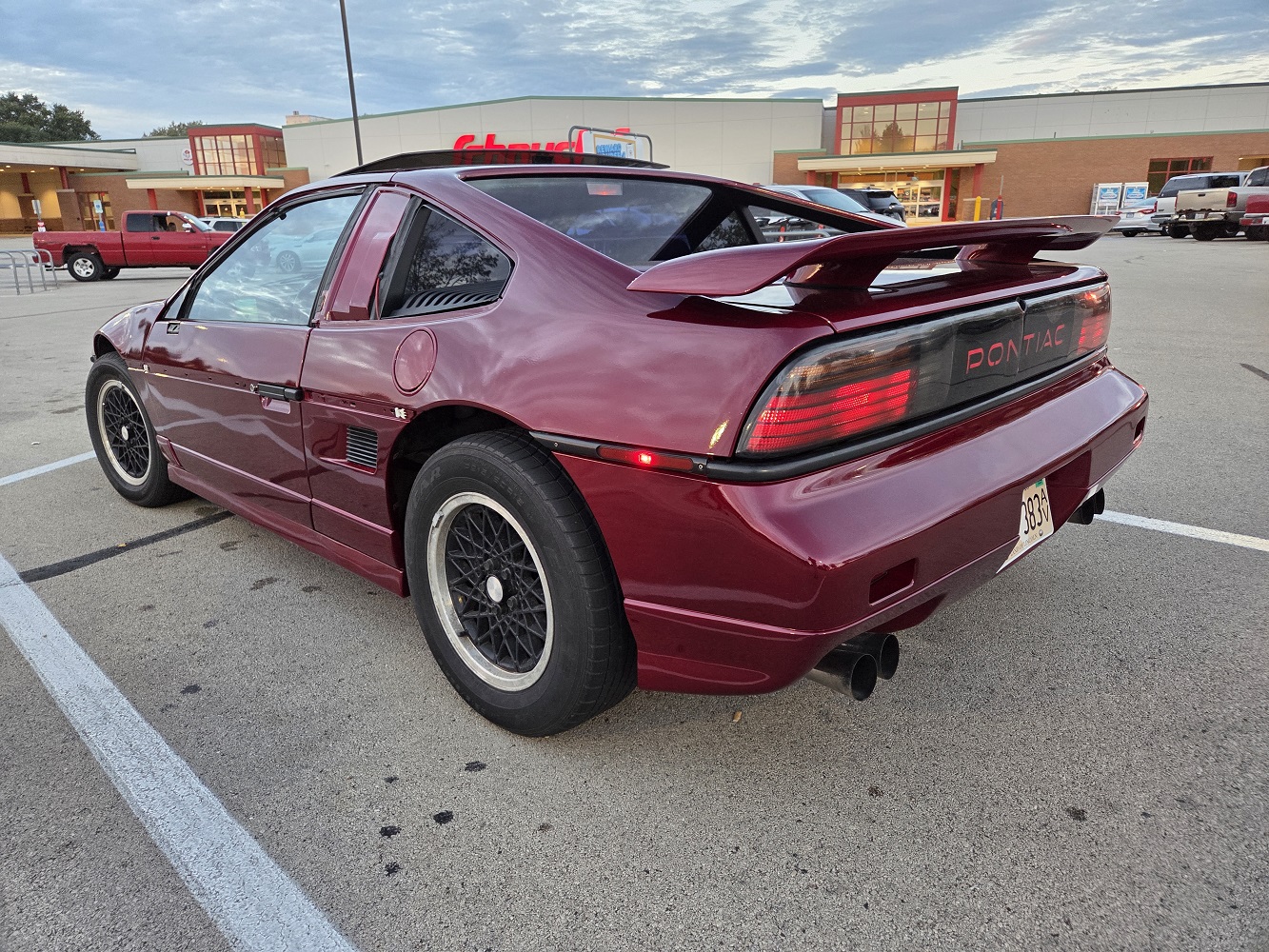

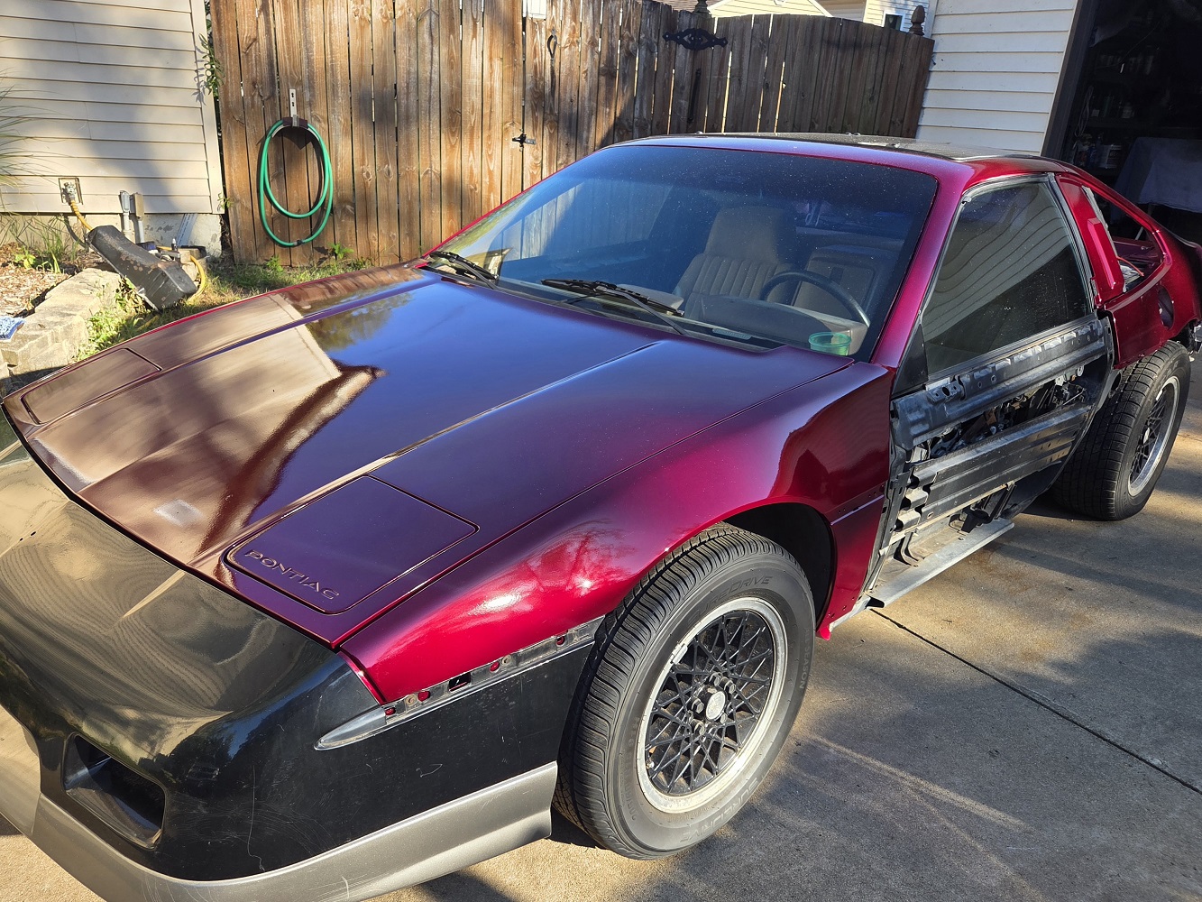

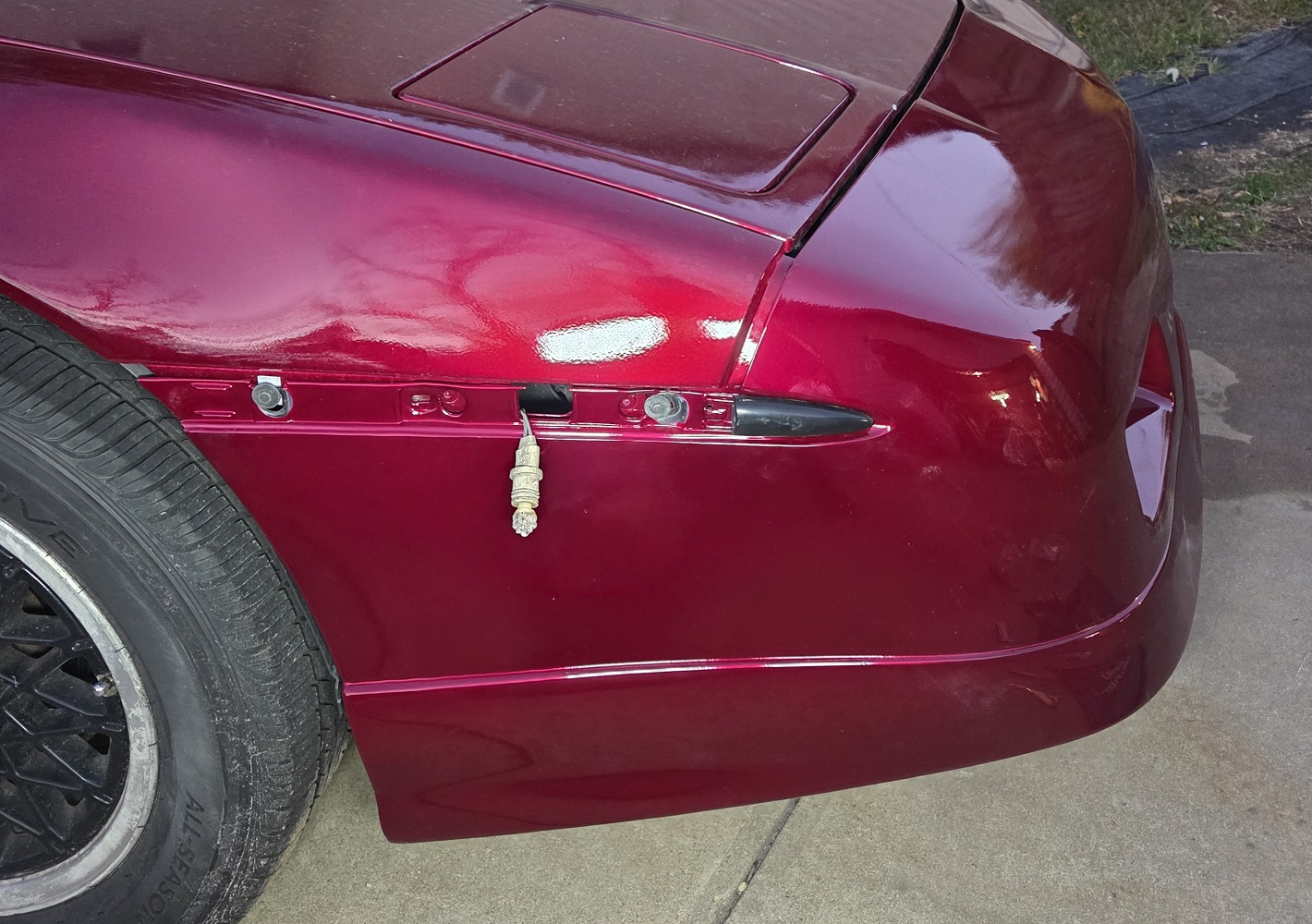

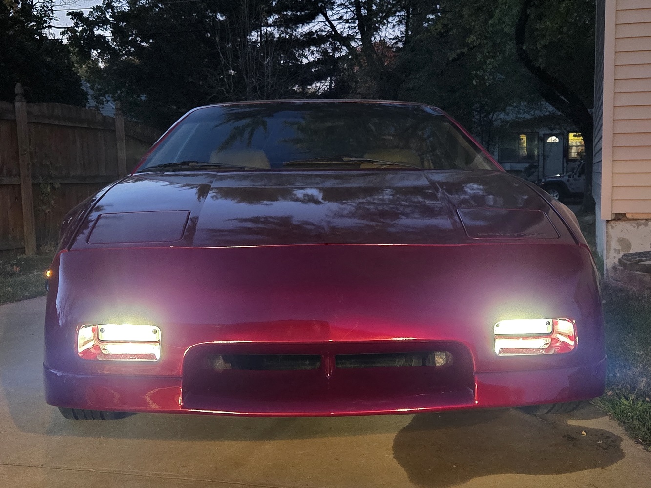

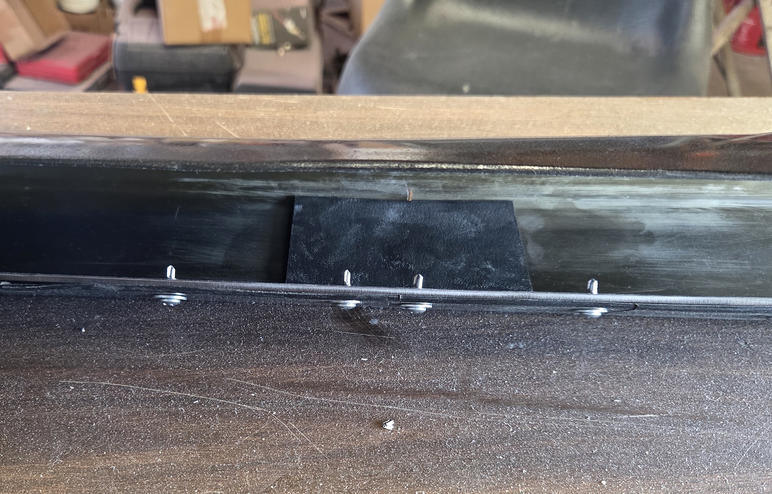

I got the nose mounted and the color shades are matching up really well. It just came down to making sure I had full coverage with the base coat.
This is the repair.
I think I might do a ghost Pegasus in Solar Gold on the hood. What do you guys think I should do if anything.
White COB running lights. They are bright at night. Not enough to be overwhelming like today's modern cars or butthole jeepsters like the one behind my car in the picture. I'm sure Ogre would have something to say about that.

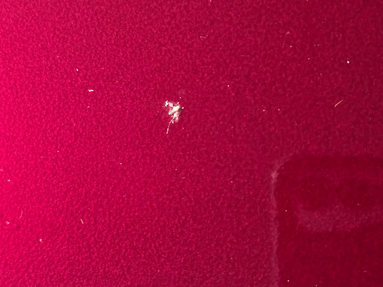

Report this Post11-25-2025 01:23 PM Click Here to See the Profile for hercimer01Send a Private Message to hercimer01Edit/Delete MessageReply w/QuoteDirect Link to This Post

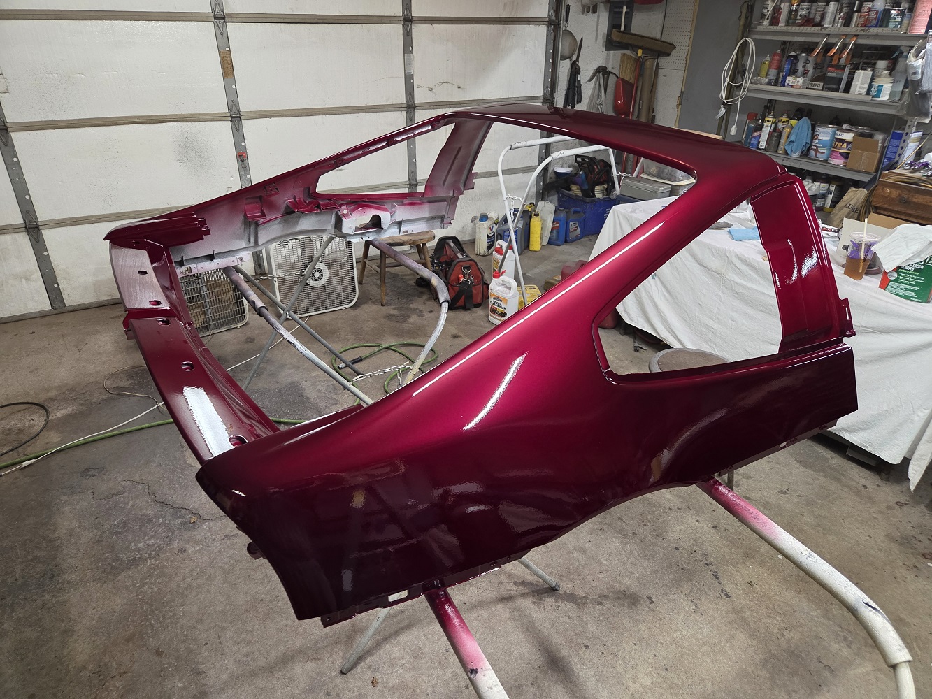

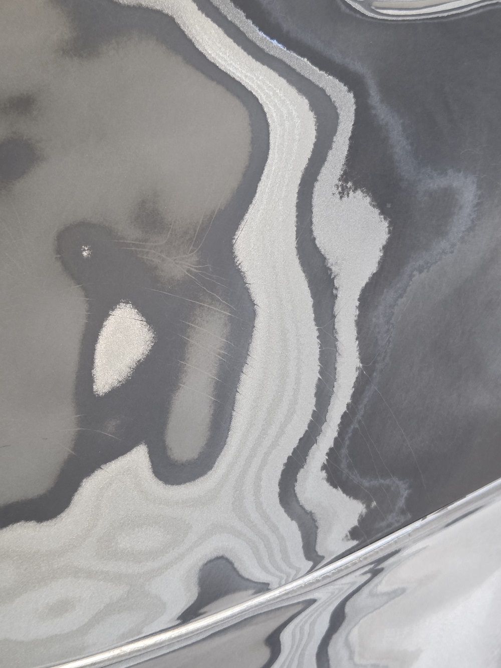

Note to self, don't use white for a base. Its too hard to cover evenly. I had to put on 2 more coats of colr and 3 coats of clear. I finally got the paint done. But it needs to be buffed out still. I sprayed it at 48 degrees Fahrenheit so clear laid out like glass. It's been cooking in my heated garage for 2 days now. I have plastic rolled up to the ceiling that I drop down when I paint. I also make a filter system for the garage door, but it doesn't seal at all on the top. It looks like Dexter's workshop. And of course one lowly mosquito survived our freeze and had to get in the paint some how.

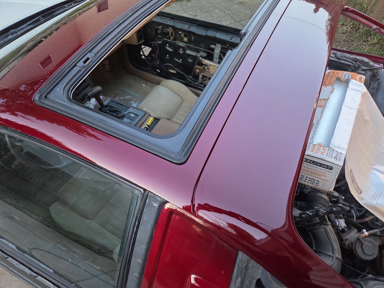

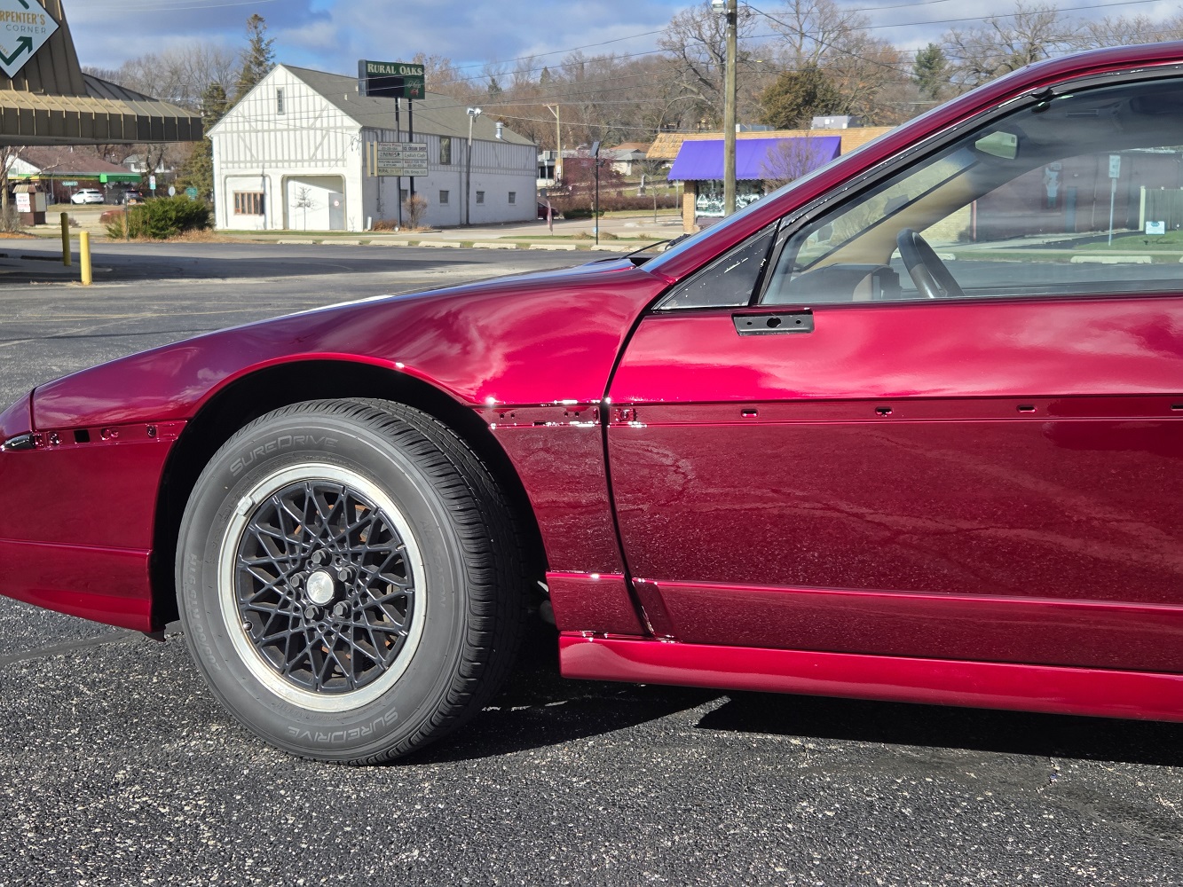

Report this Post11-27-2025 10:54 PM Click Here to See the Profile for hercimer01Send a Private Message to hercimer01Edit/Delete MessageReply w/QuoteDirect Link to This Post

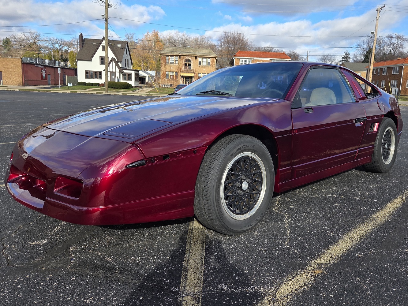

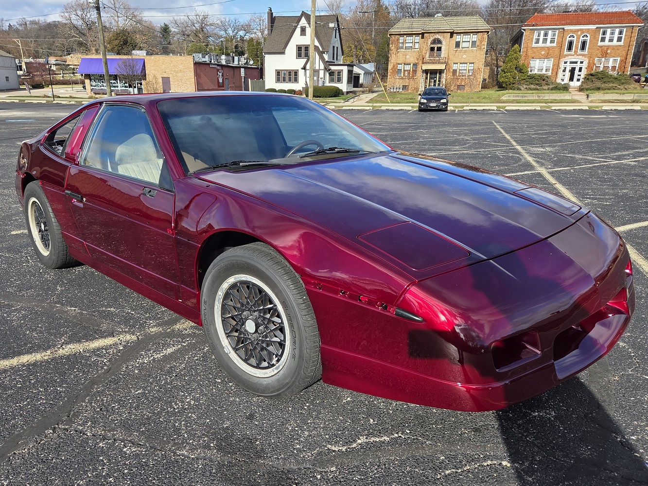

It was sunny today. I took it out to verify the color coverage. Looks good, It is a bit hard to tell in the pics though.
Every ones back in the barn for the winter.
