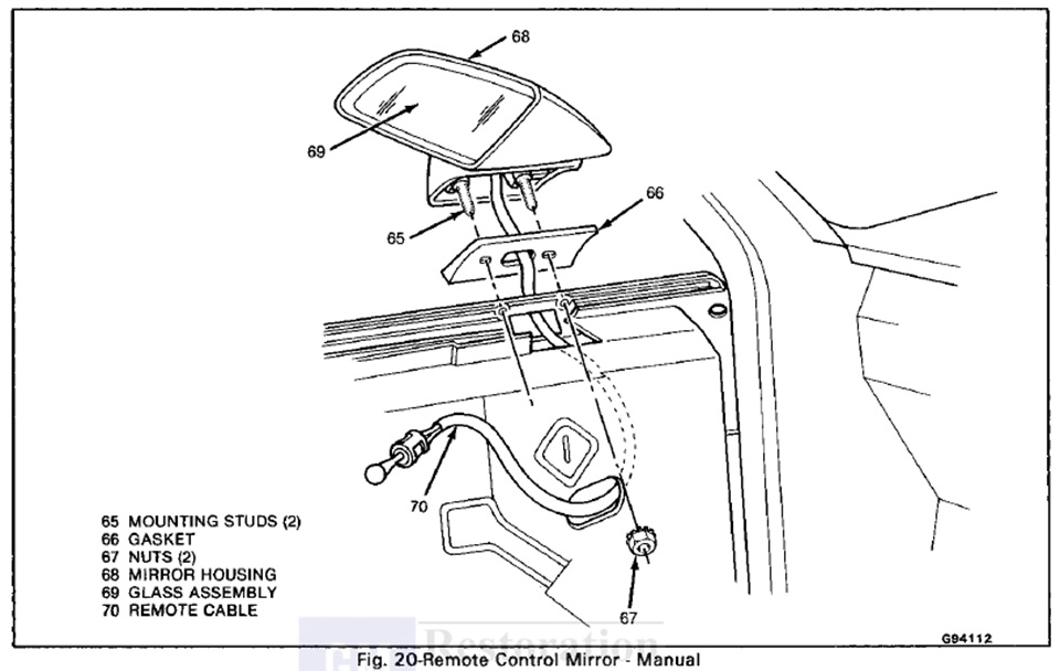

Door panel off and window down - YES...
Remove 2 nuts on mirror studs (power or manual)

You have to remove the inner window seal and front seal, then you will have access to the nuts. The studs from the mirror run thru the outer window seal framework. Just take your time removing the nuts.

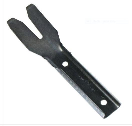

I have to voice a little disagreement with the method used in the video posted by ltlfrari. Grabbing the door panel and yanking it off with your hands is a good way to break the holes where the umbrella fasteners are inserted. You also stand a chance of breaking the metal pieces at each upper corner, away from the panel. Best to use a door panel removal tool to insert behind the door panel and exert the pressure against the fastener, instead. The structural material our panels are made from is weak and it really isn't difficult to break the holes where the fasteners are inserted.
The tool on the left is the one that works best on our door panels.
https://www.harborfreight.c...1836&pcid=6549872779 &intent=&gclid=EAIaIQobChMItvjsj-C75gIVluDICh2t4gAUEAQYDSABEgLNyPD_BwE
